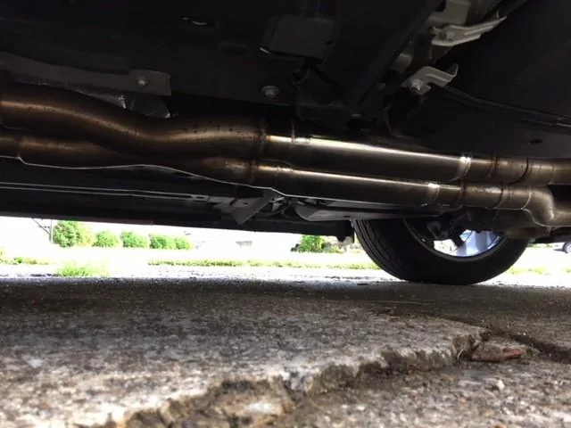

This is where I would consider those similar to mikeypee, after x right before mufflers. These are 3" in and out 12" long.

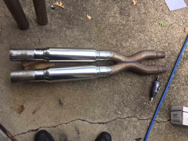

18” and still plenty of room behind the x for connector pipes. Made a HUGE difference in resonance.
