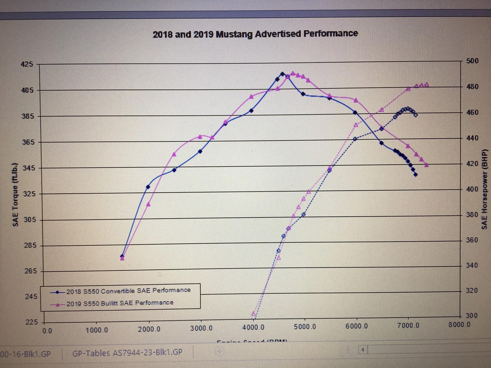

The Gen3 Coyote pulls to 7500 in the lower gears. It can't do it in the higher gears, and is airflow limited as it approaches 460 HP. The Bullitt has a larger intake and can go for just a bit longer.
Look at a dyno, 2018 GT powerband ends at 7k, and a Bullitt's ends at 7250 Even with a tune. Their biggest issue is likely that they need either ported heads, a hi-rev cam, or both. The 350IM was designed with an engine built to rev over 8K in mind. Likely if you put a head package on a Bullitt and GT is when you'd see the benefits from the 350IM.

I did not buy my bullitt over the gt for the 20hp. Nor do I think the bulk of bullitt buyers did. I also do not think it was about the magniride (mine does not even have it). You can slap magniride on gts nowadays (when ordering from ford).
I think (I have no data to back this up) the point of the air intake is about engine tone more than hp. The extra hp is a byproduct of fords attempt to reproduce that half gurgle / crackle that makes you smile a bit. While I might not be able to differentiate between a similarly speced 19 gt and 19 bullitt as far as performance. I can degenerate based on ambiance.
I suspect, based on steeda's NA tune, that you can coax more out of the 350intake/coyote setup, but if ford where to have done that, the bullitt would have likely been labeled a true gas guzzler. The stock bullitt tune keeps carb / epa happy, allows ford to overbuild a bit, & provides a nice tone for the vehicle.

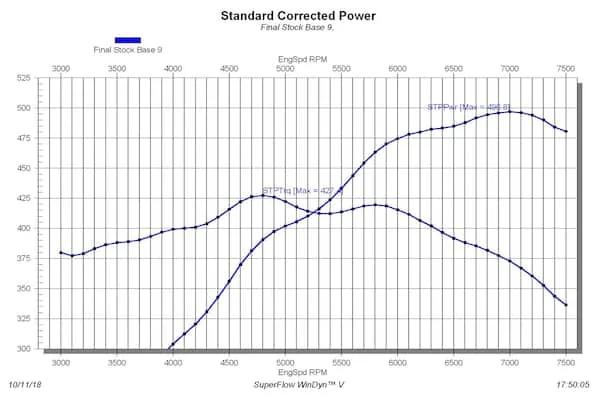

Incorrect, and an asinine claim. The Bullet does make 20hp more than the 2018 GT due to the GT350 intake manifold, throttle body, intake, and calibration -which flows better at high RPM than the 2018 manifold.
The often quoted HotRod manifold comparison (2018 vs GT350 vs CobraJet vs Boss) used a Gen 3 Coyote with long tube headers, a JLT open element intake, and E-85 (tuned). This is a far departure from a stock Coyote on pump gas. In addition, the CMCV's weren't working during their test of the GT350 manifold, so the low-midrange power is worse than if the CMCVs were working, and you can't draw a proper conclusion from that test.
The GT350 intake, throttle body, and manifold is proven to make a lot more power over the 2015-17 manifold on a Gen 2:
https://motoiq.com/tested-ford-mustang-gt-power-packs-1-3/8/
I wish I had the time and money to do a proper comparison on a Gen 3, since no one has.
You are correct. I did a poor job making my point here. My point wasn’t that the Bullitt doesn’t make more horse power but more that the regular gen 3 already makes great horsepower.
Here is supposed to be the completed stock power pack calibration with 91 octane fuel. Stock catted header.
https://www.hotrod.com/articles/ford-5-0l-coyote-dyno-test-cai-e85-tune-makes-532-hp/
You pretty much said Ford lied and just "changed the 6 to an 8in the sales book".
But I digress:
In that HotRod baseline test. 496.8hp STD = 484.35hp SAE (1.0257 correction factor from STD to SAE).
From my test, a bone stock 2018 GT put down over 416.82whp and picked up 12.91whp from a Borla cat-back exhaust.
Loosely backing out some math:
416whp = ~10.5% drivetrain loss from a marketed 460bhp. That would mean the Borla-equpped 429.73whp run would = 474.85bhp.
Since the speed limiter came in before these pulls reached peak power, the car is actually making over 416whp stock and over 429whp (over 474bhp), which is about 10hp shy of HotRod's baseline with an open exhaust after the cats.
*The HotRod baseline pulls do not have any exhaust after the cats, and the power would be lower "as-installed" in a car with a full exhaust. Nevertheless, the Gen 3 Coyote is impressive and makes a lot of power. But it's inaccurate to assume your stock Gen 3 in your stock 2018 Mustang GT makes 496.8hp. It may make 496.8hp STD (484.35hp SAE - which is the correction factor used by all auto manufacturers) with straight pipes after the exhaust, but not in a stock car.
