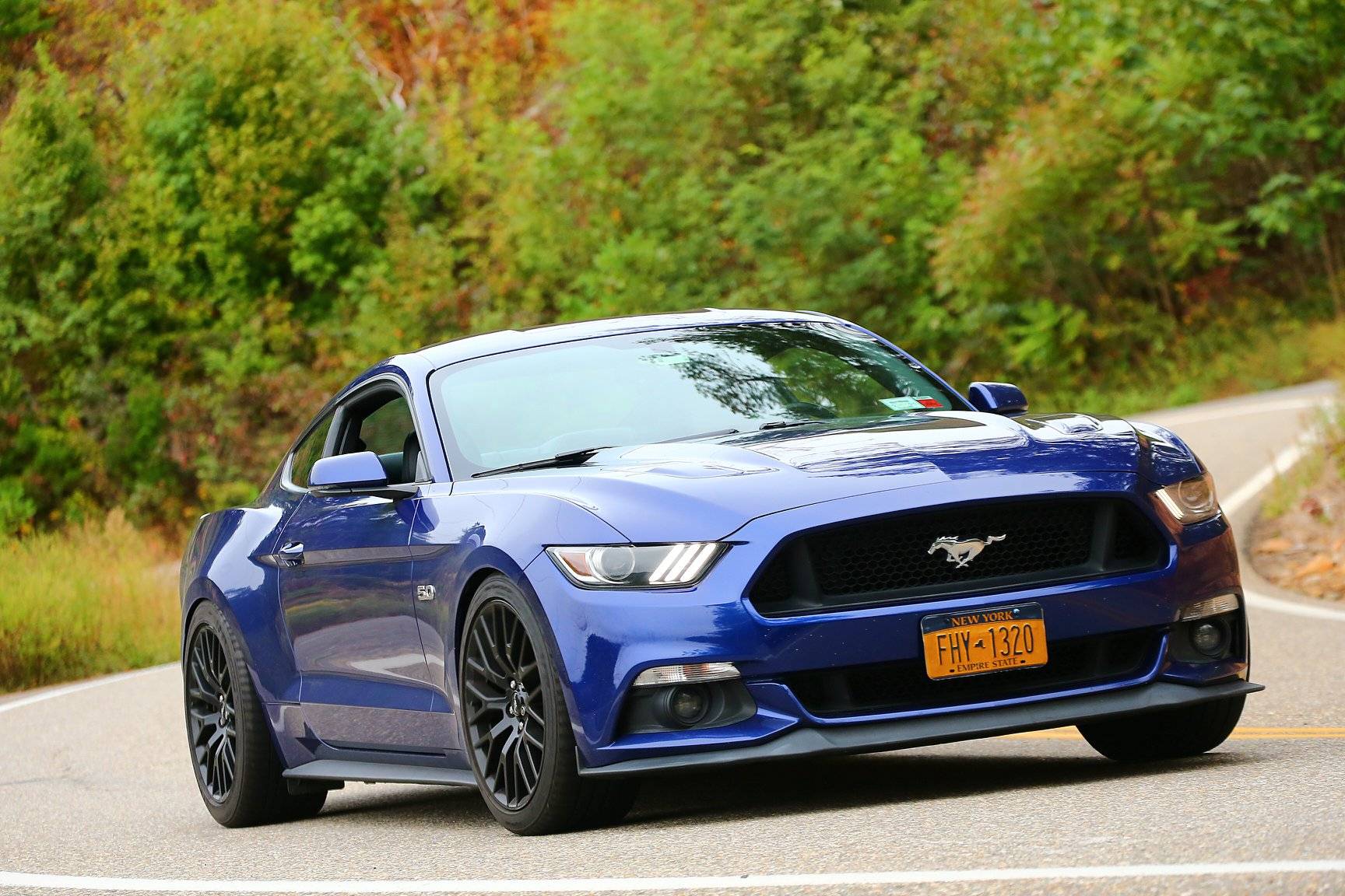

I have 1-inch spacers all around on my car and this photo was on Tail of the dragon going through turns. I never had any issues with them. My car is a performance package car so 275 in the rear.

Are you on stock springs? Looking to get the same look as you have here. I have 2017 PP1

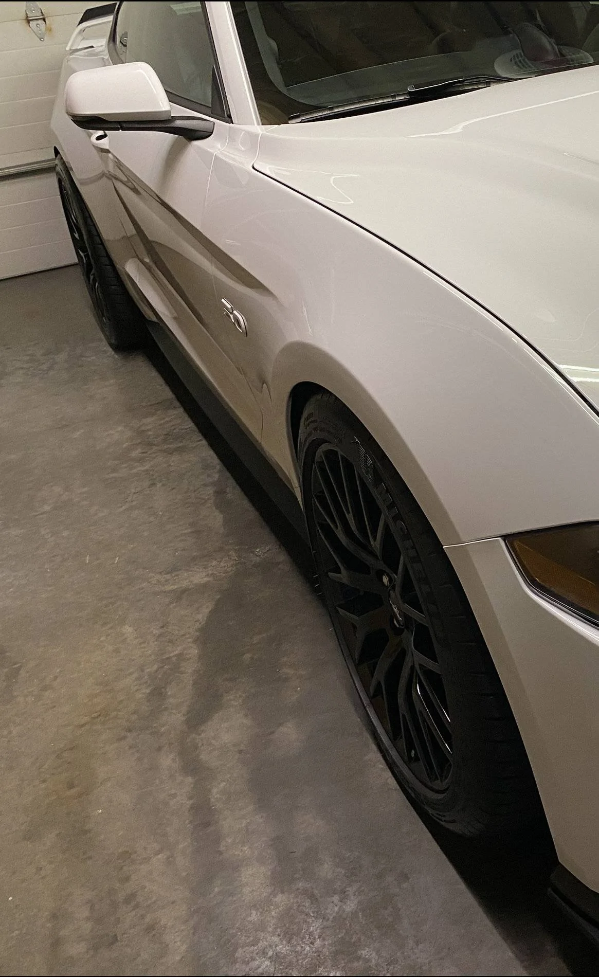

Installed a set of Steeda 1” wheel spacers on all four wheels last night. Pp1 car with BMR drags springs installed. Looks a lot more aggressive. Although I think the rear could be inward a lil more. My 16yo son thinks it looks great.
blakesawyer
Feb 29, 2020
2017 GT PP
Looks good. I'm going to go 1" up front and 20mm in the rear
