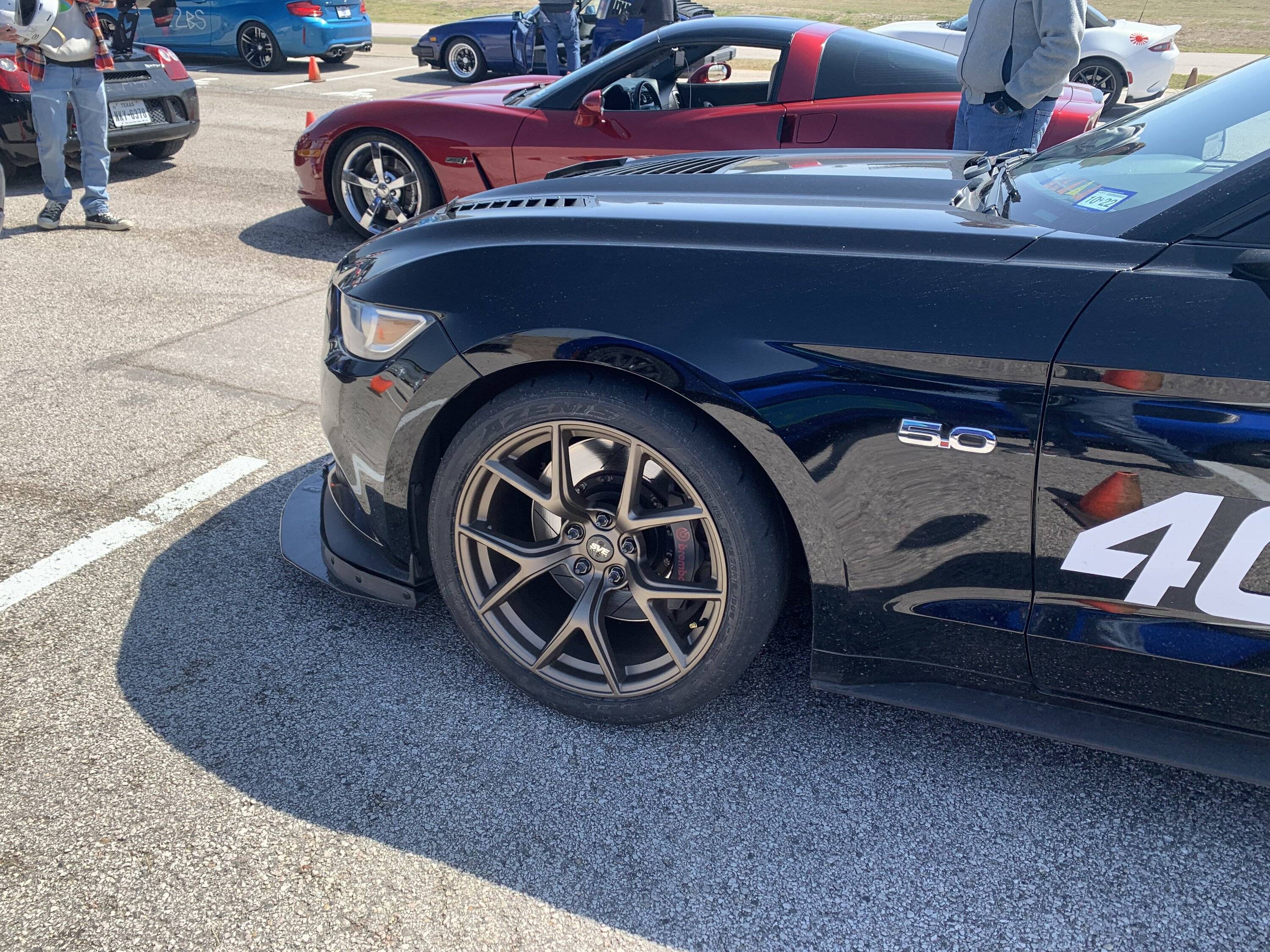

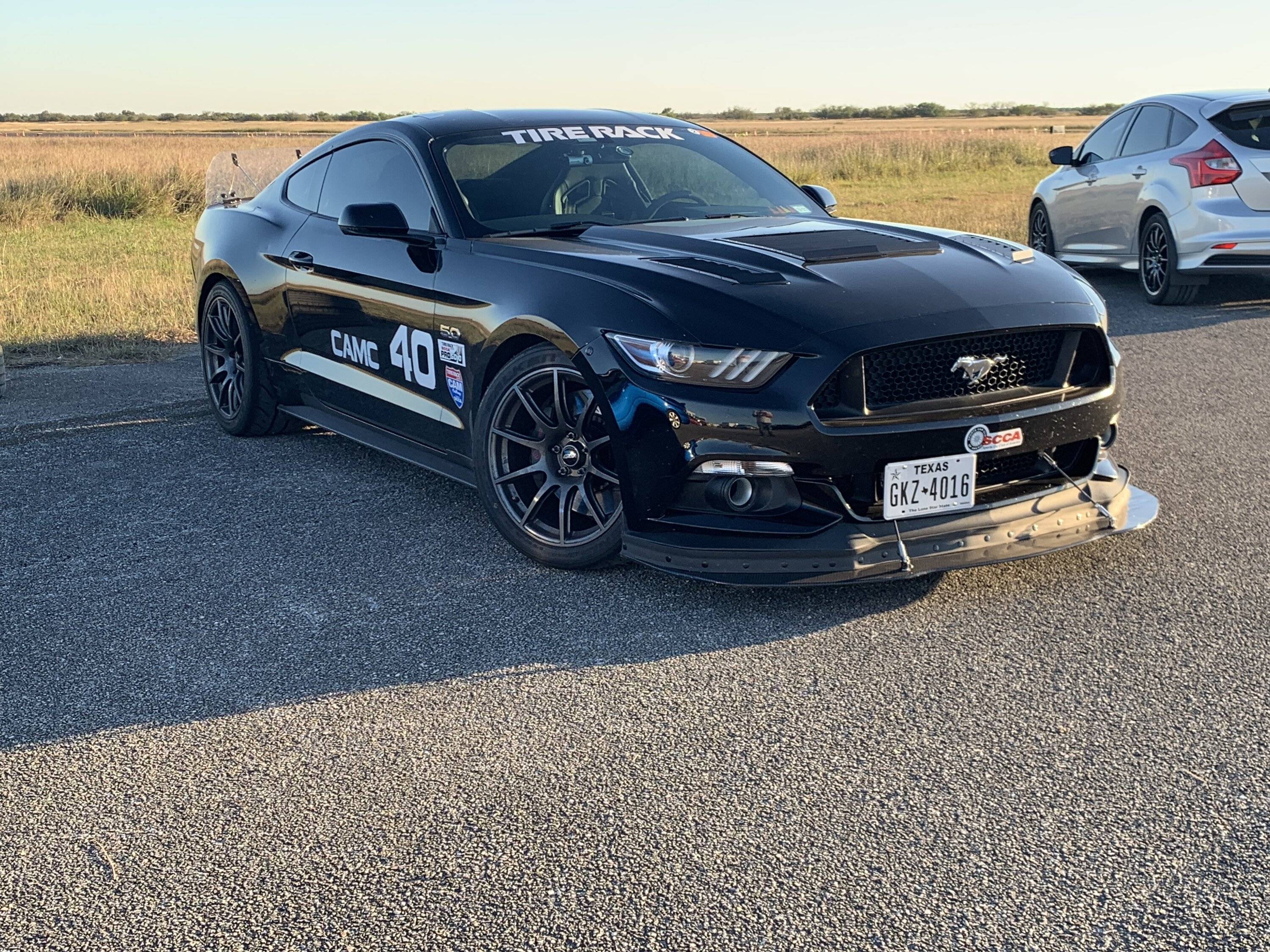

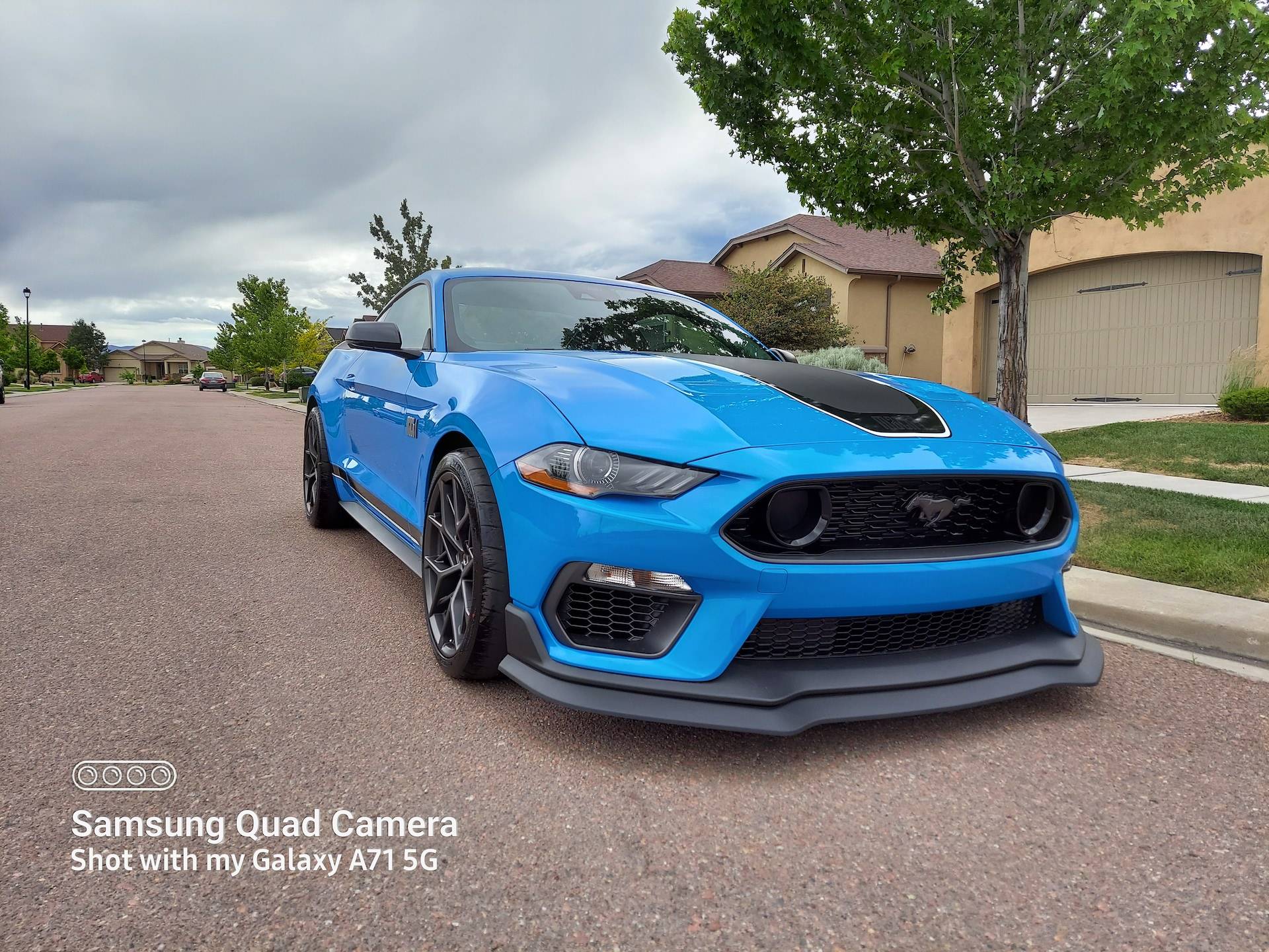

I was told 19x10 up front on a 285 would be fine, and I read some people on the forums that ran a 295 on a 19x10 in the front with no issues. The apex guy said 19x11 ET52 in the front would require a 25mm spacer and at least -2.75* camber.
Yes, a 285 on 19x10, +35 is fine in the front. Zero issues. For reference in your other measurements, you'll be left with about a thumb width of space from the tire to the suspension.
A 19x11 with an effective +27, you'd have to study photos. Poke? And everything that could come with that, like more rocks against body panels. A 19x10.5 with a +24 pokes a half inch.
I do understand you are modding the suspension and possibly changing the alignment.
First pic, 19x10, +35.
Second pic, factory 19x10.5, +24.

Personally I'm kind of indifferent to square or staggered. I'm currently trying to figure out what brand has the best quality between Apex, SVE, and P6GR. The SVE S350 19x10/11 kit is such a good price but I kinda feel like that might mean the quality isn't great.
I have all three of those brands and while Apex are the nicest of the lot, you can feel pretty good about buying any.
P6GR wait times may suck, and their CS isn’t the best these days but I still love the product. They require small diameter lugs which is my only beef with them. (7-spokes satin black). Finish has held up well for like 5+ years. Look great with PP1 center caps.
Apex (SM-10 anthracite) have knurled beads and the easiest access to full diameter lugs. Great finish. good CS. No complaints.
SVE (SP2 bronze)use full diameter lugs too but the finish isn’t as impressive and the damn lug nut cone seats are coated, which takes a bunch of mount/unmount and driving for it to finally flake off. Not a big deal but causes my lugs to stick. Apex OTOH have perfectly machined bare metal on those lug seating surfaces. The SVEs are great for the price, and look fantastic.
for street wheels which might see some track time, I’d just get some 10/10 square ET35 wheels and call it a day. Fitment is easy and you’ll get 95%+ of the grip you’d get with a square 11” set with less darty daily driving highway manners. I’ve tracked the 10” square wheels plenty (and stock 9/9.5” PP1 wheels before that) and they’re fine.
If you want to be crazy and daily on 11” front wheels you’ll get my respect and the car will look mean as hell, but Apex guys are right, you’ll want like 2.7 or more front camber to tuck them in the fenders.

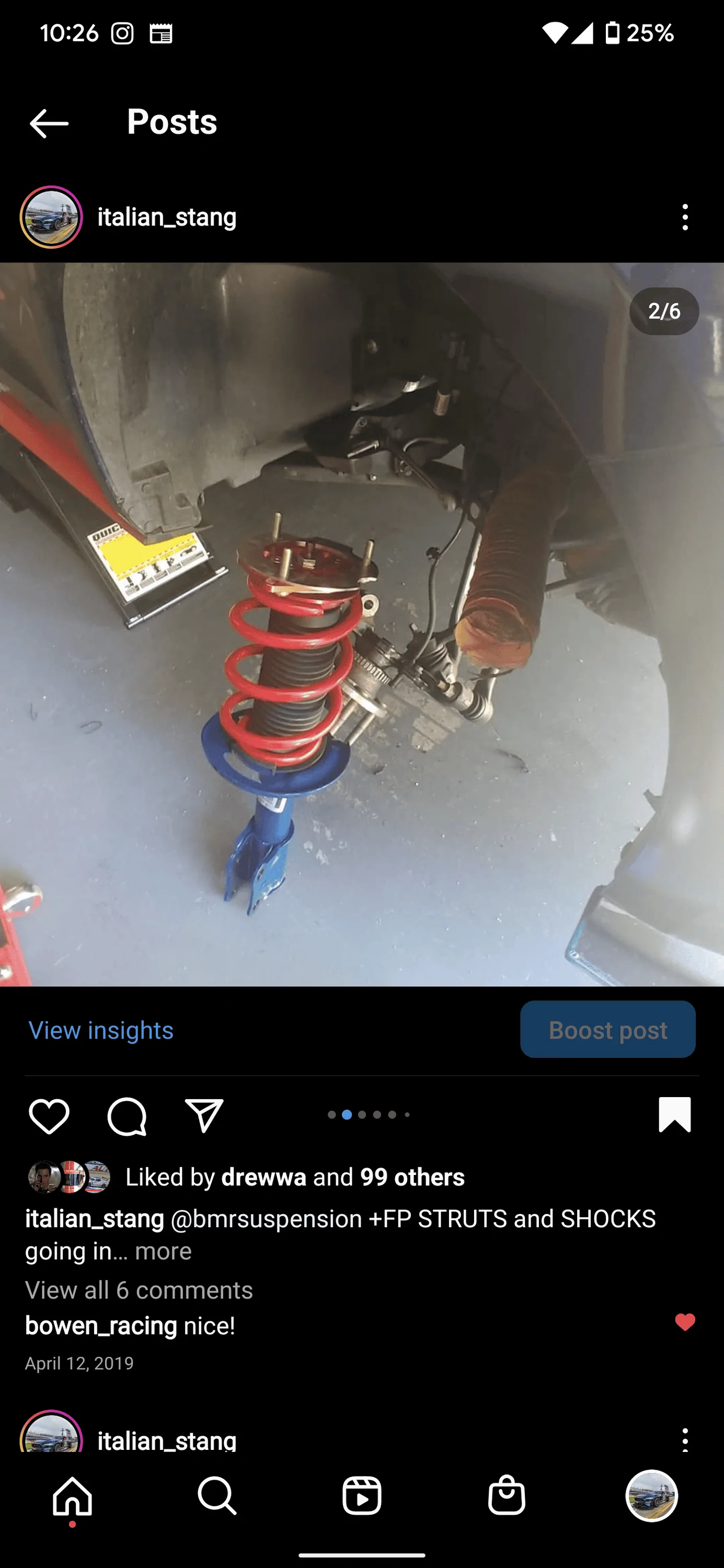

Fyi i ran at the beginning vorshlag plate with FP shocks 19x11 squared with APEX.
Vorshlag allowed me up to -3
u will be absolutely fine
25mm for 305mm
28mm for 315
Longer studs and open lug nut (all in OPMUSTANG.COM
305 Squared is not only better from a grip prospective but allows u to rotate them for way better wearing.

I ran that same setup with the larger OEM shocks setup.
I think is good.
-2.8 camber
on BMR LINEAR SPRINGS ( THE BEST for oem shocks) drop of 0.75 inch
I am now on CORTEX JRi coilovers.
Running -3.8 with a 28mm spacer.
I can fit 315mm in the front and rear square.
I would look into the 18".....
