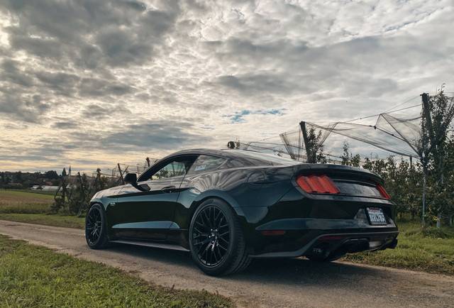

Generally, 25mm up front and 23mm in the rear will get you a flush fitment. That's what I used to run before I switched to new wheels. Also on Steeda progressive springs.
Got mine from Motorsport Tech
Also, fyi: PP1 wheels are different from the Performance Pack wheels that came on the '15-'17's. On the early wheels you couldn't go smaller than 23mm due to the stud length/carvings on the inside of the wheels.

wow! looks so sick your car!
my wheels are performance pack wheels then because I got them before 18'~20' came out.
Thanks a lot for your input!

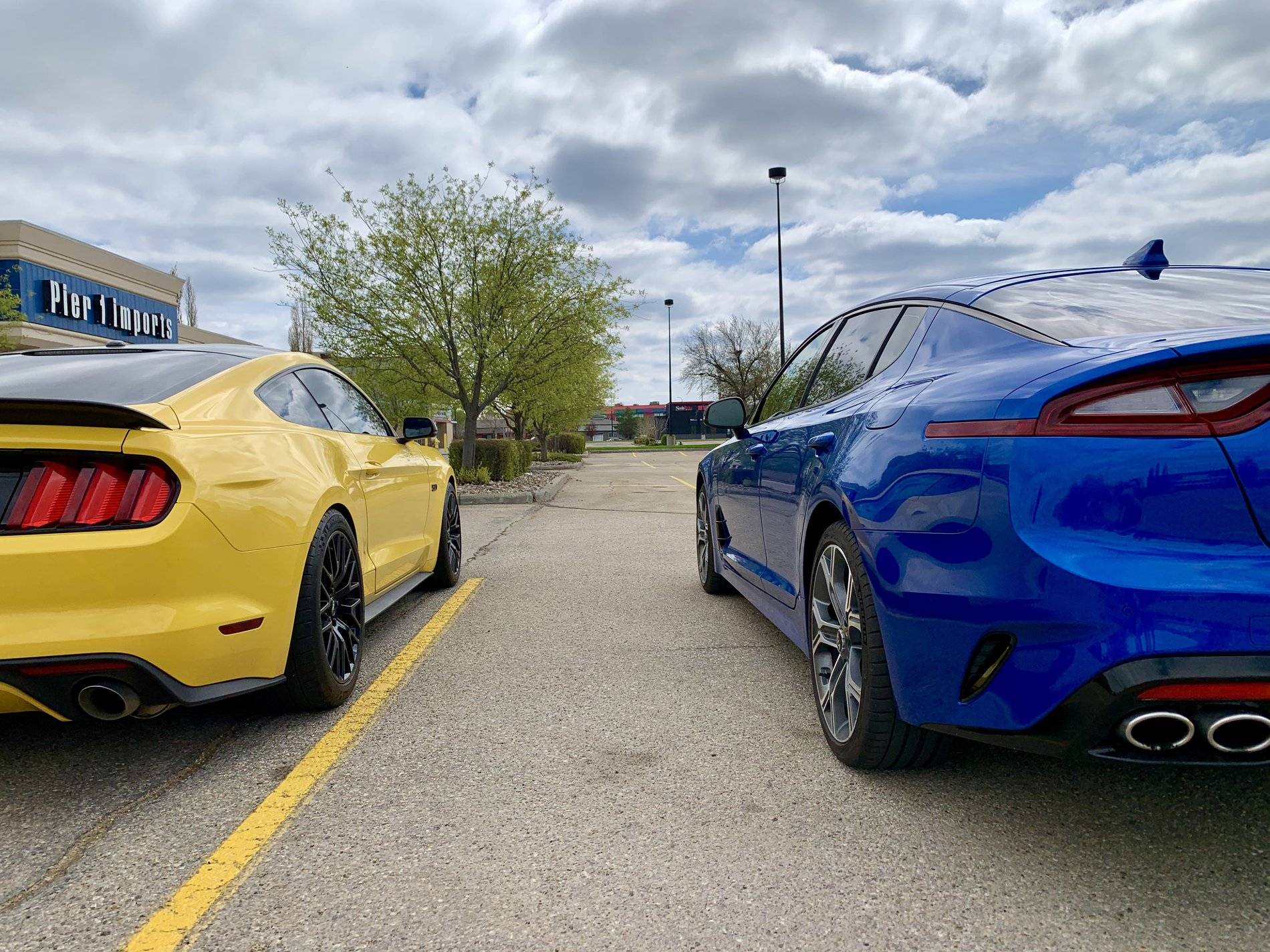

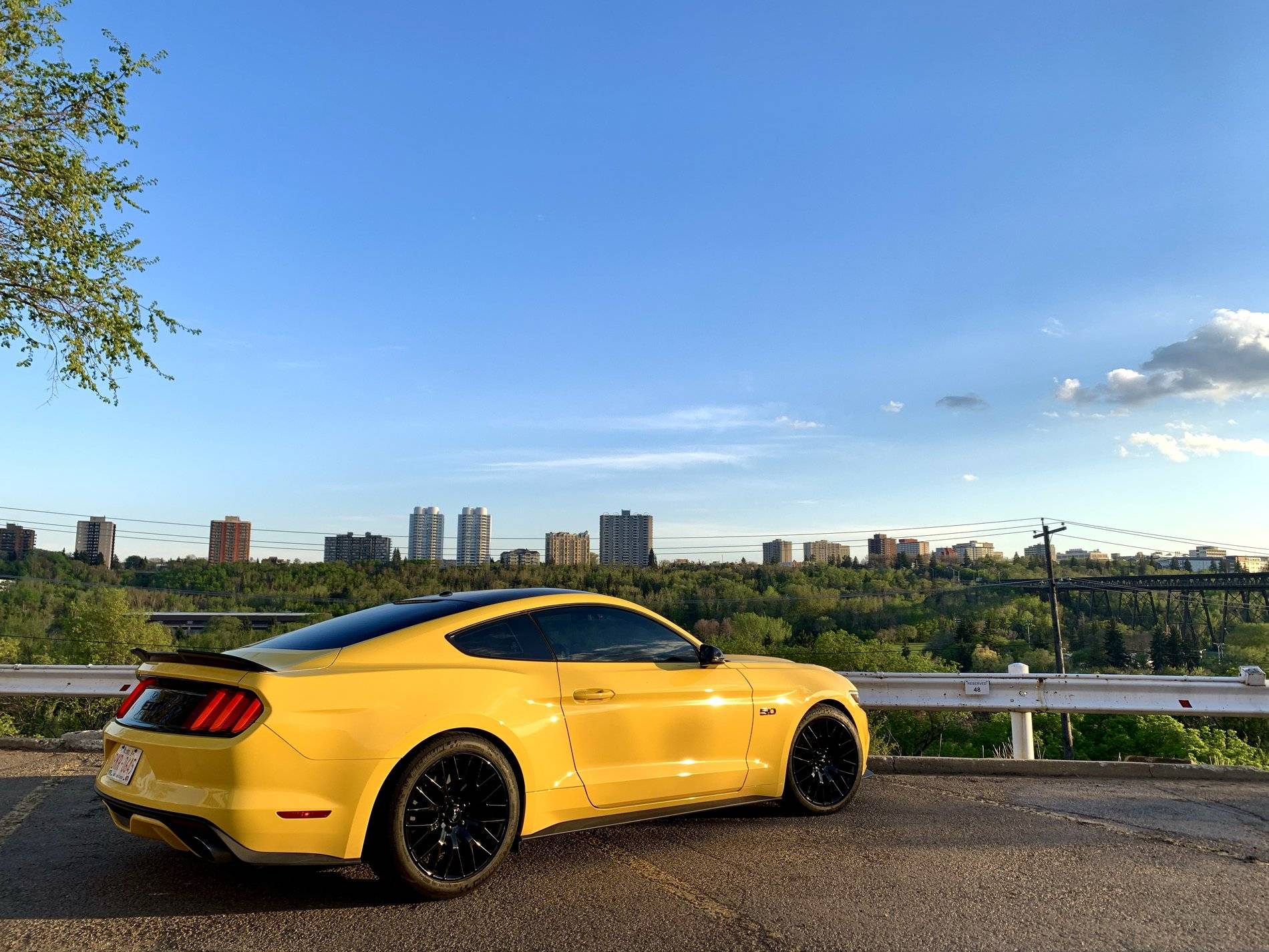

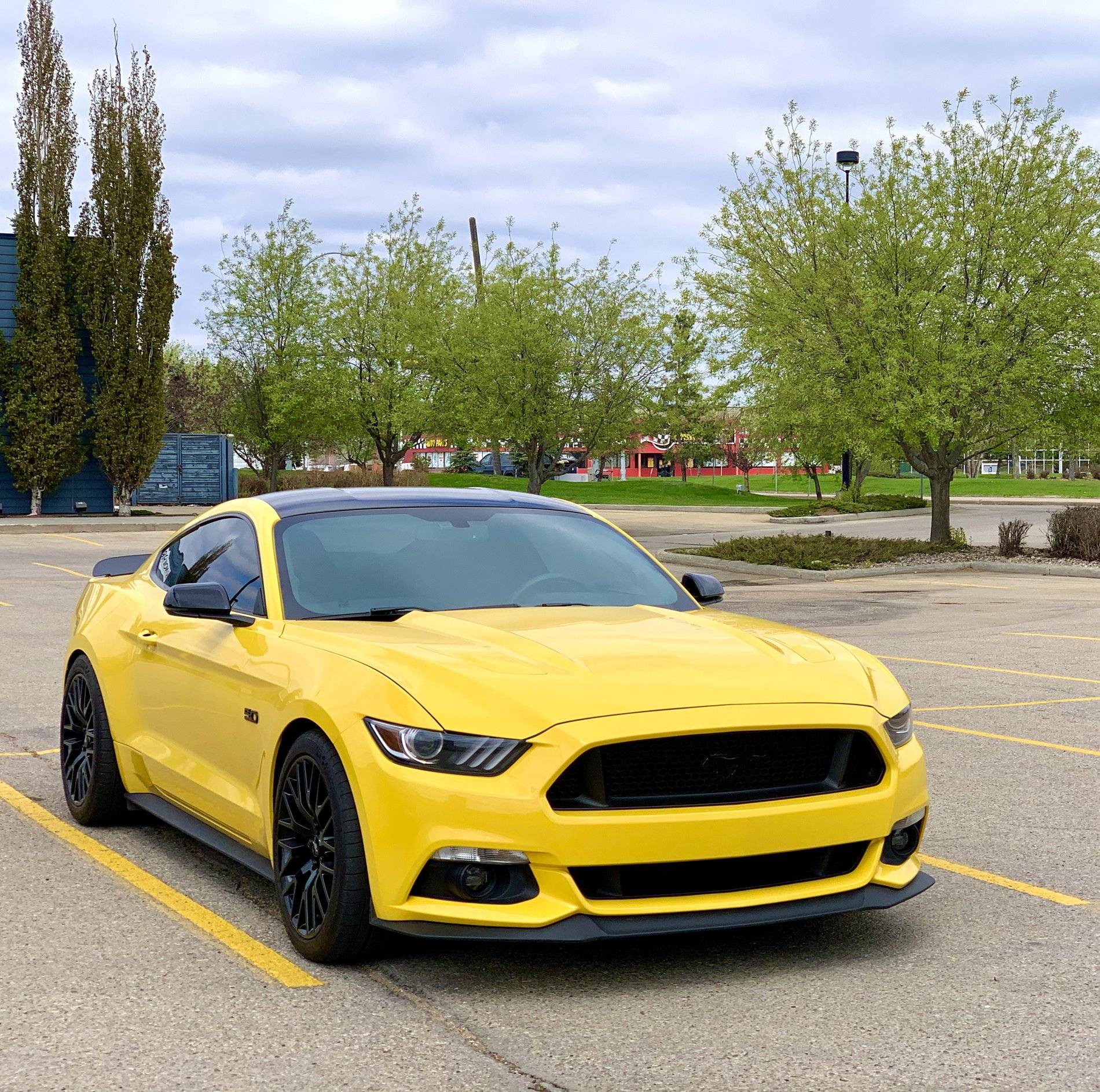

Just get a set of 1” (25mm) spacers for all four corners from whatever vendor; I can attest that they’re all the same. Just find them on sale. I’m lowered on BMR SP763 minimum drop performance springs (with Koni Active dampers and J&M rear shock mounts).
