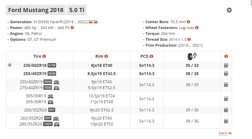

you can find all Mustang wheels sizes here and their wheel specs. Make sure the center bore is exact. It is used for alignment. I prefer to use stock offsets or at least as close as possible. If you want to use the same on all four, get the larger positive offset of the two and add a spacer of the difference to get proper fitment.
I preselected the 2018 for you:
https://www.wheel-size.com/size/ford/mustang/2018/
According to the website, these are the wheel sizing (the number after the 'ET' is the offset). PCD is for lug spacing.:

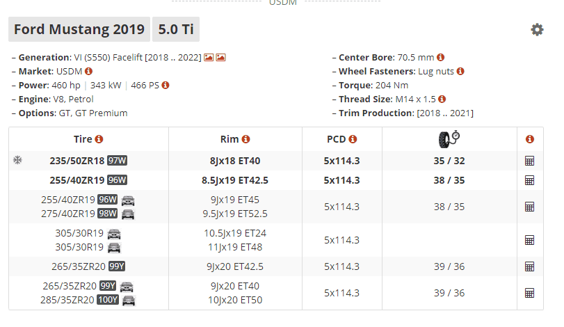

If you look here (I preselected 2019), you can see all the offsets for a Mustang based on type
https://www.wheel-size.com/size/ford/mustang/2019/
Even within say a GT, you have different offsets based on tire /wheel sizes.
The track width and wheel offsets on the PP2 are a direct consequence of fitting a 305 tire in the available space in the wheel well. Its that simple.
They use those offsets because its the only place you can squeeze in that large of a tire without significant redesign to the body or suspension. I run 305s on my car and an very familiar with the clearances in the wheel well.
