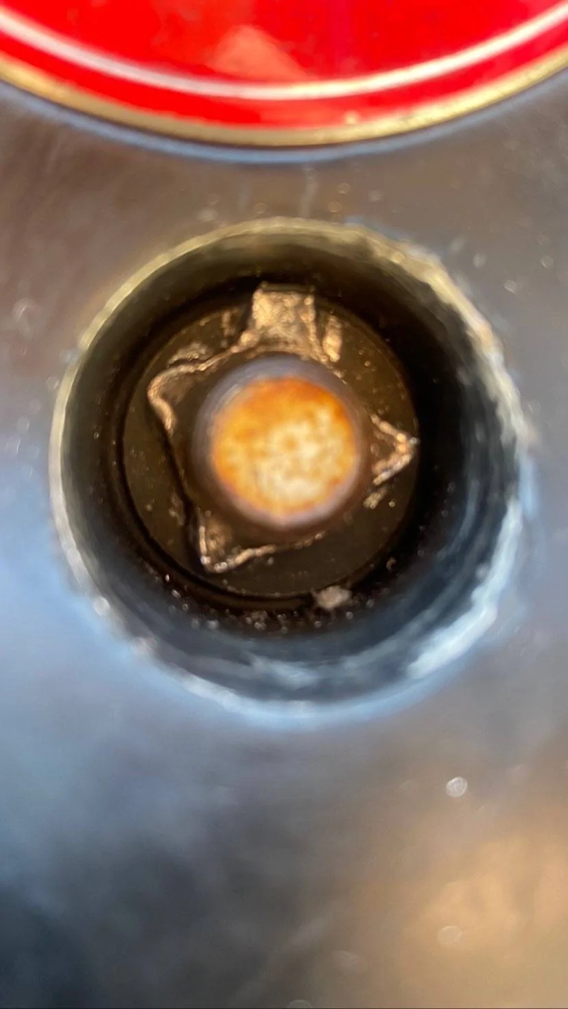

For those that did not look at the images the OP posted, there’s no way any of the current online “tricks” will work on those lock nuts... there’s no room between the inside wheel lug wall and the edge of the lock nut. That’s the purpose of that type of design, it can’t be defeated by normal means.
It’s also too low into the lug socket to weld anything onto it to remove.
These 2 companies have the most advanced lug locks out there, but from their online designs, the OP’s lug lock does not appear to be similar, UNLESS it’s an older design.
https://advancedwheellocks.com/
http://rimlox.com/
OP can try contacting them with images, maybe they can offer some assistance.

I've had Discount Tire break regular locking lugs off when our key came up missing. It wasn't on a Mustang but a Honda. They have some sort of tool for that.

My suggestion to take the car to a high end tire shop is because I wouldn't trust the car dealer. If in fact the lugs are munged up, a dealer sure as hell wouldn't be able to fix the issue. The op bought the vehicle used. The lug nuts were most likely already fubared. Sad to say, he's going to have to pay a specialist to extract them. Up to and including using an extractor on the wheel studs.

I agree, wheel locks mostly cause problems for vehicle owners. On my 17 GT, 2 of the dealer installed wheel locks sheared off leaving behind pieces that could not be turned by extraction tools. I ended up having to drill out the wheel studs and replace them. It was extremely frustrating and time consuming.

I don’t know what the hell that is but it’s not normal and isn’t a wheel lock.
Jeeze, that looks horrible! Sorry, I mean it looks like someone had wheel locks and shredded the lock nut, it looks deformed.
I got a 4 pack with my Bullitt and it came with a wheel lock socket, but didn't put them on as they are chrome and stick out, so I'm not using my locknuts.
