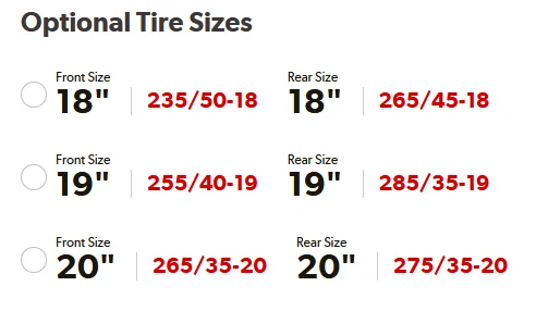

What tire size are you aiming for (on the 18"s?) 265/50/R18 would be too tall, I think (28.4"). I doubt that would fit.
If you want to stay close to the tire height/diameter where you are now, you'd need something like 265/45/R18, or 245/50/R18. Either one would give you a somewhat softer ride, but probably at the expense of some handling sharpness.

TireRack site shows these for my options

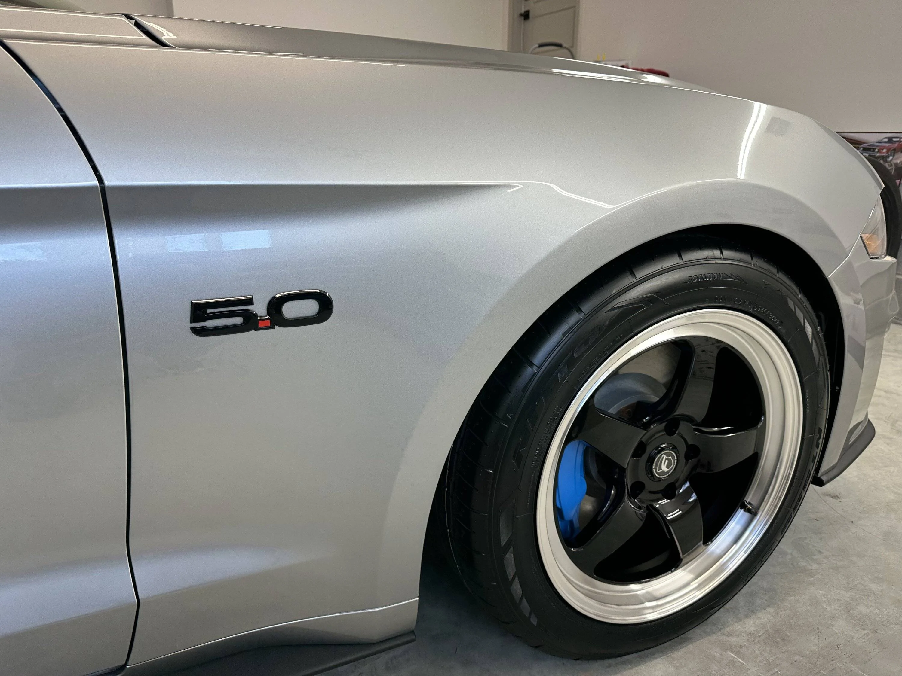

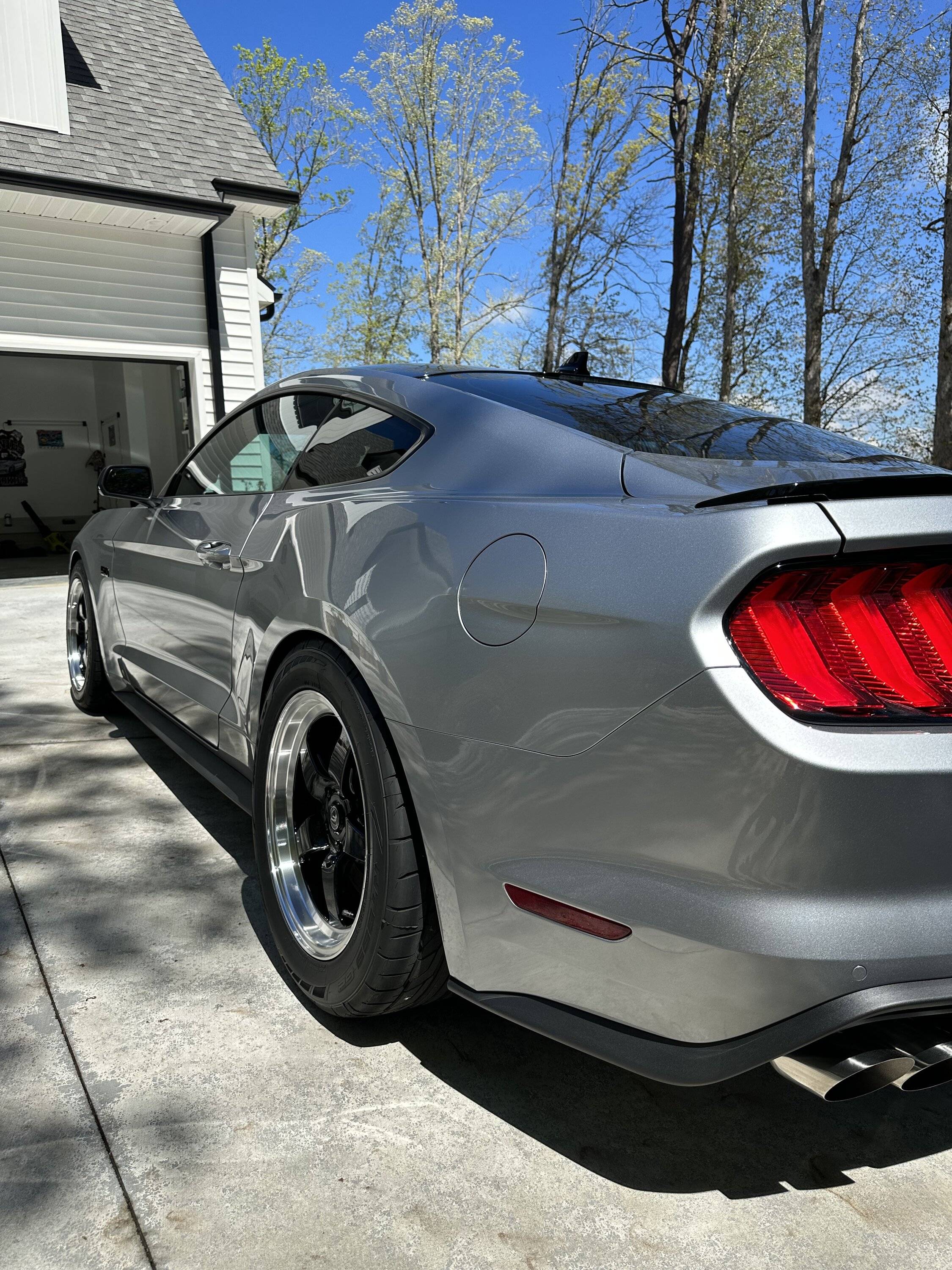

I don't run a square set up but I do run 18's lowered on Eibach Pro springs. 255/45/18 in the front on a 9" wheel and 295/45/18 on a 10" wheel.
i am researching wheels and tires. i want to make it as easy as possible. did you have to get any spacers and what is your offset numbers?

No spacers, tires are 255/45/18 in front and 295/45/18 rear. Offset is 22mm in front on 9" wheels and 42mm in rear on 10" wheels. This setup is 100% flush.

I am lowered on Eibach Pro springs and the ride is better than when it was stock height and the stock 19's. When it was lowered with the 19's the ride was a lil harsher than stock but not terrible. I was going for the "drag race" look, and this setup filled that bill perfectly I think. I wasn't worried about the weight because this is the look I wanted.
