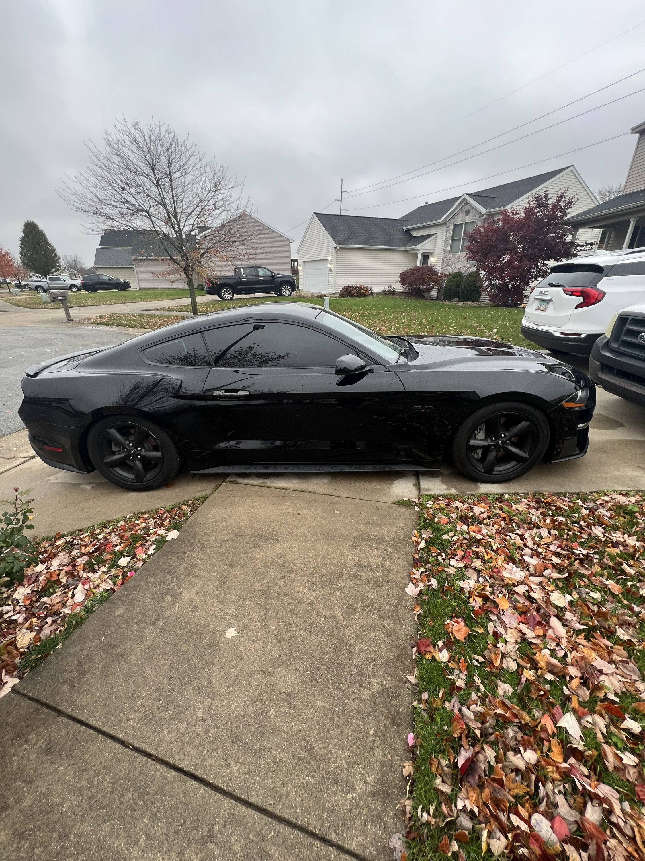

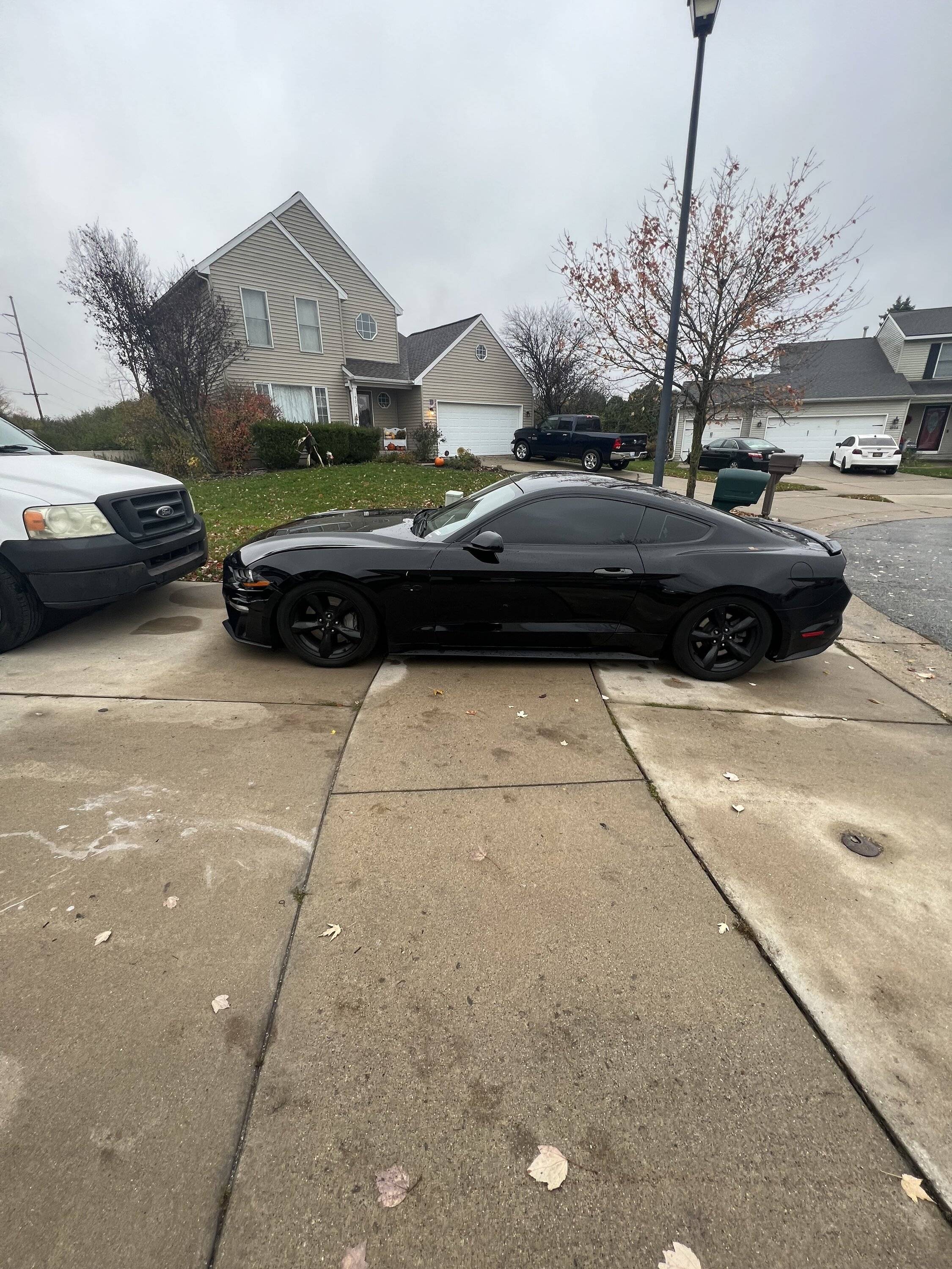

I recently purchased a ‘18 GT non PP and it came with a small ass square 235 setup on 18x8 wheels those just obviously aren’t it so I wanna buy a new setup, I’m fairly new to the car community so apologies in advance for any errors I might make in this post 🙏.
I’m currently on MeganRacing Coilovers (EZII), I emailed them so I could be sure about the stock drop but they never got back to me so I’m assuming it’s 1”, but I think it could be lower because it seems lower than most of the other 1” dropped s550s I see (gonna attach a imagine). I would like to run 305s in the back and 275s in the front. I like the way the car looks with bigger tires in the back and I can afford it so I would like to do it. I also do have plans to add more power to this car eventually, but just not right now. I bought this car roughly a month ago and I came from a 2015 Chevy equinox so I’m totally satisfied with the power I’m making right now.
Right now I’m considering getting some weld s152s for the rear and some Ferrada F4s in the front but I’m not to sure on the specs I should get so I’d totally appreciate some help.
(Pls ignore front end damage someone tapped my bumper while my car was PARKED and it’s currently in the body shop getting repaired and is “supposed” to be finished tomorrow 😈)

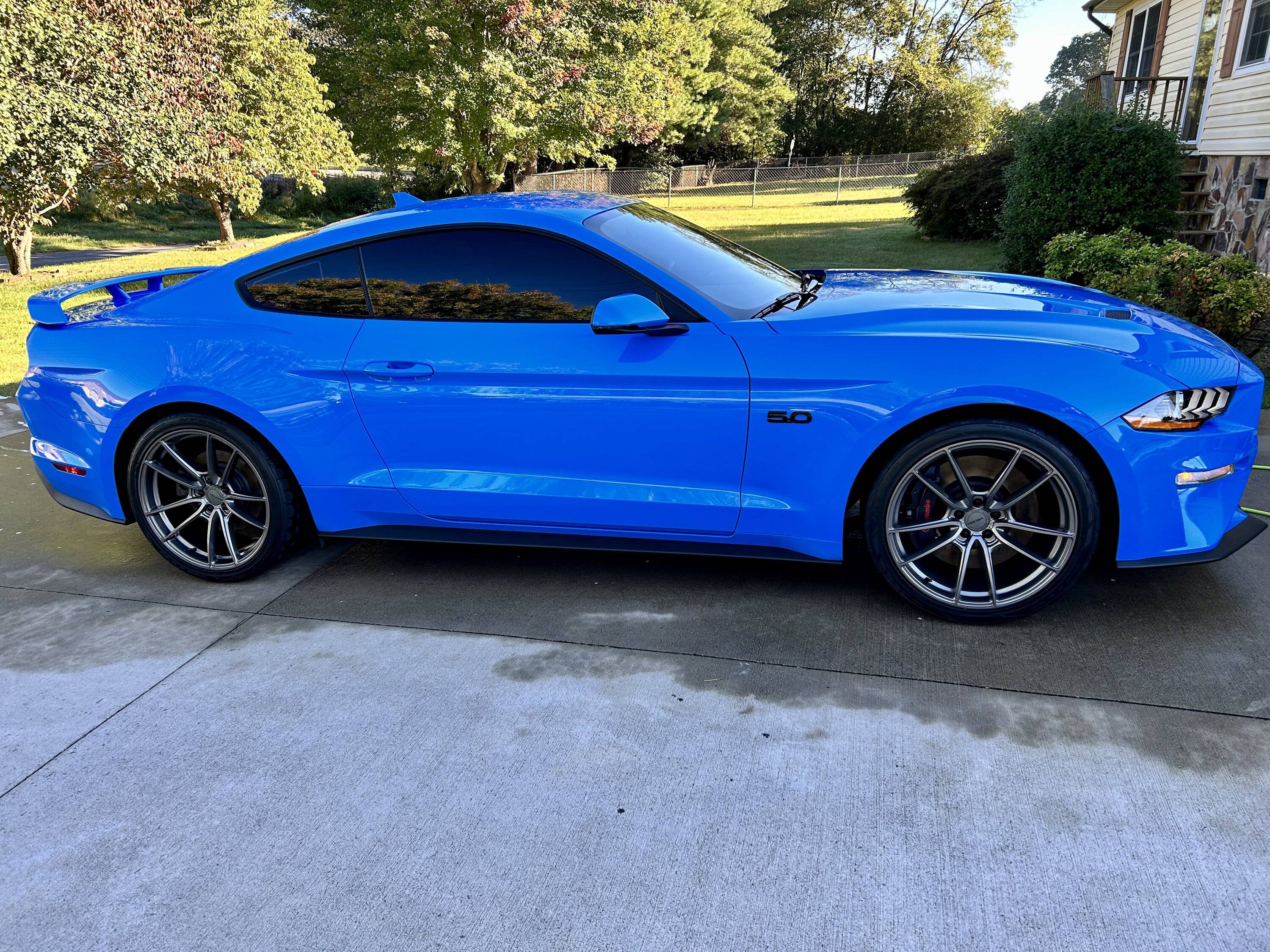

275 35 20 and 305 30 20. Got the setup from LMR and it fits perfectly. I am not lowered (Magneride PP car) however but I don't doubt they would fit fine. Velgen VF5 lightweight series.
And I agree, 235 wide tires on a V8 powered Rear Wheel drive car is criminal. Mine came with 275 wide in the rear stock and was a little better.

That rear drop is way closer to 2" than 1. If it was set up correctly and not butchered, I believe 1.5 drop is common on those cheap coilovers.
