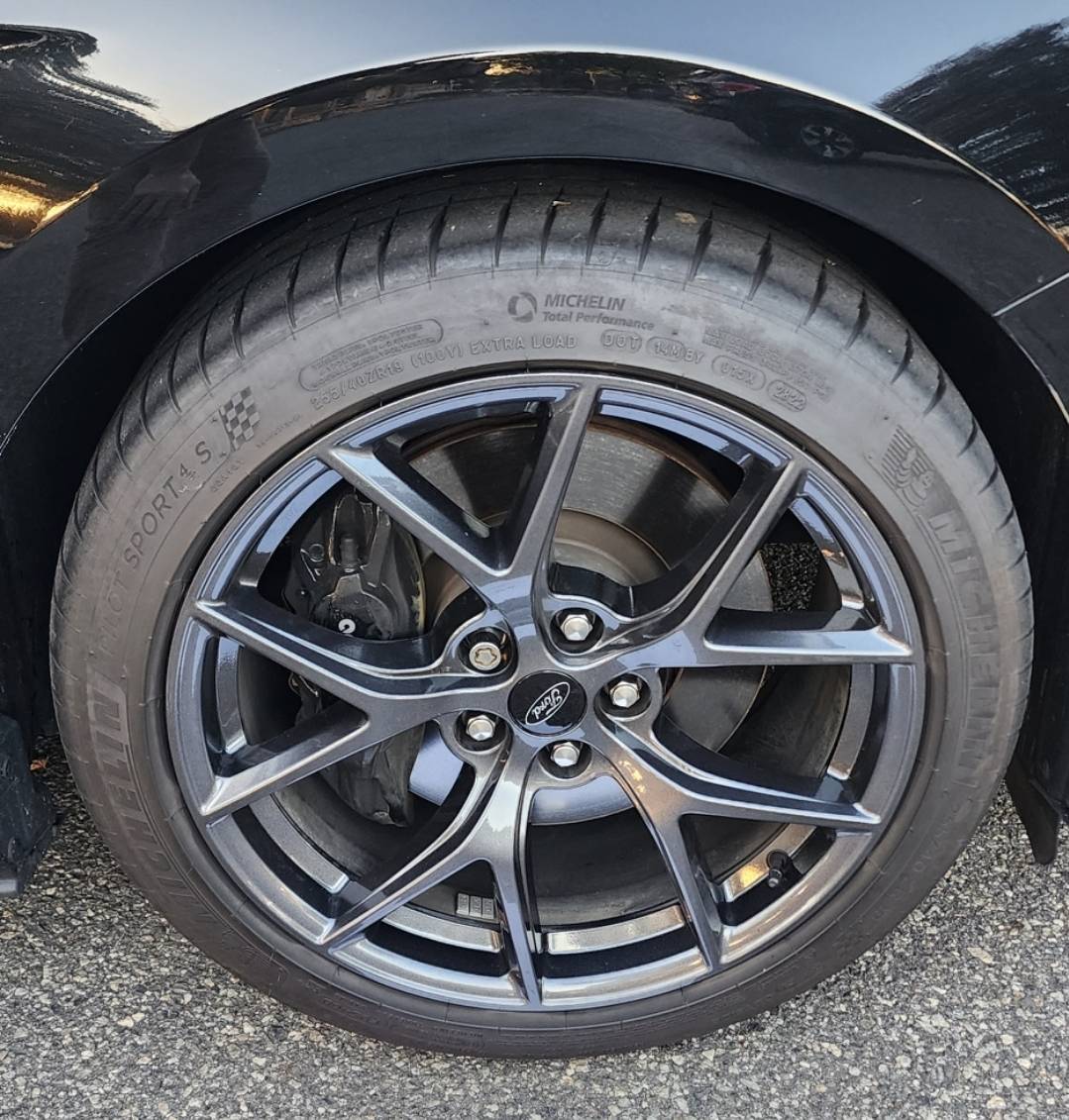

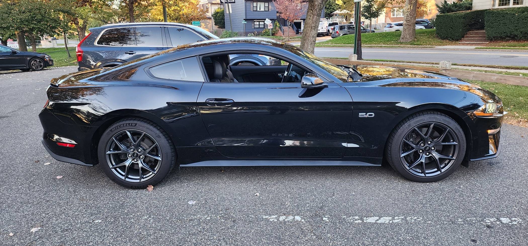

@op I just looked at the picture of your car that you posted on the intro page. Did the seller mention the original wheels?
I believe the HPP Ecoboosts all came with these wheels...
They're identical to the Mach 1 premium wheels. Not sure if they run the same offset but probably. Rears are 19x10 et52.5 fronts are 19x9.5 et40.

The wheels I have are OEM to the HPP. However, if it had the handling package, it would have came with the one you show. The HPP runs squared, 19X9 et45, which is what I currently have. Otherwise the ones, as you mentioned the fronts, 19X9.5 et40 all around on the handling package version.
