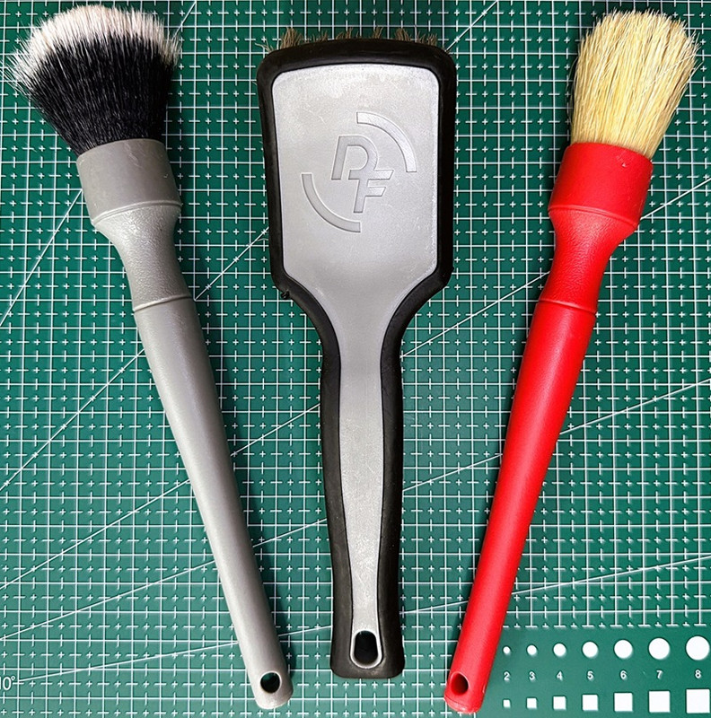

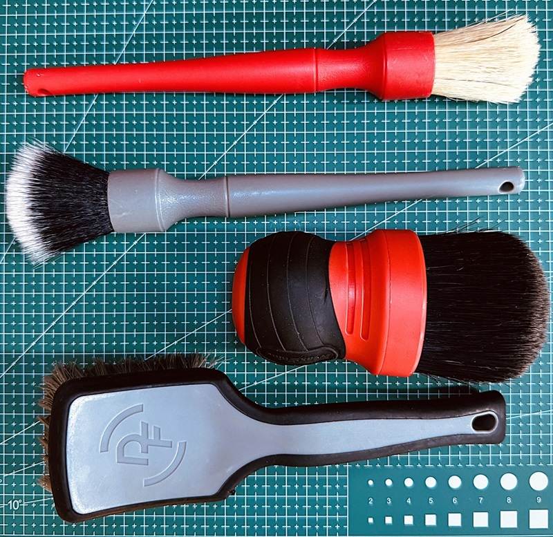

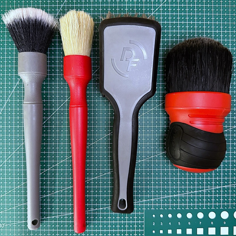

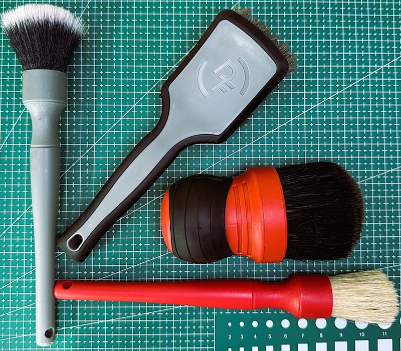

Having a little play with the camera, lighting and backdrop to feature four of my favorite brushes.
From left to right -
Detail Factory Ultra Soft - I use this grey brush for wheel nuts and brake calipers.
Detail Factory Boar Hair - Used for general interior and exterior cleaning.
Detail Factory ProGrip Tyre Scrub Brush - Pretty self explanatory, I also have another one for cleaning rubber floor mats. Probably my favorite brush overall.
Maxshine Curved Grip XL Mixed Bristle - This one is used for dressing low profile tyres.

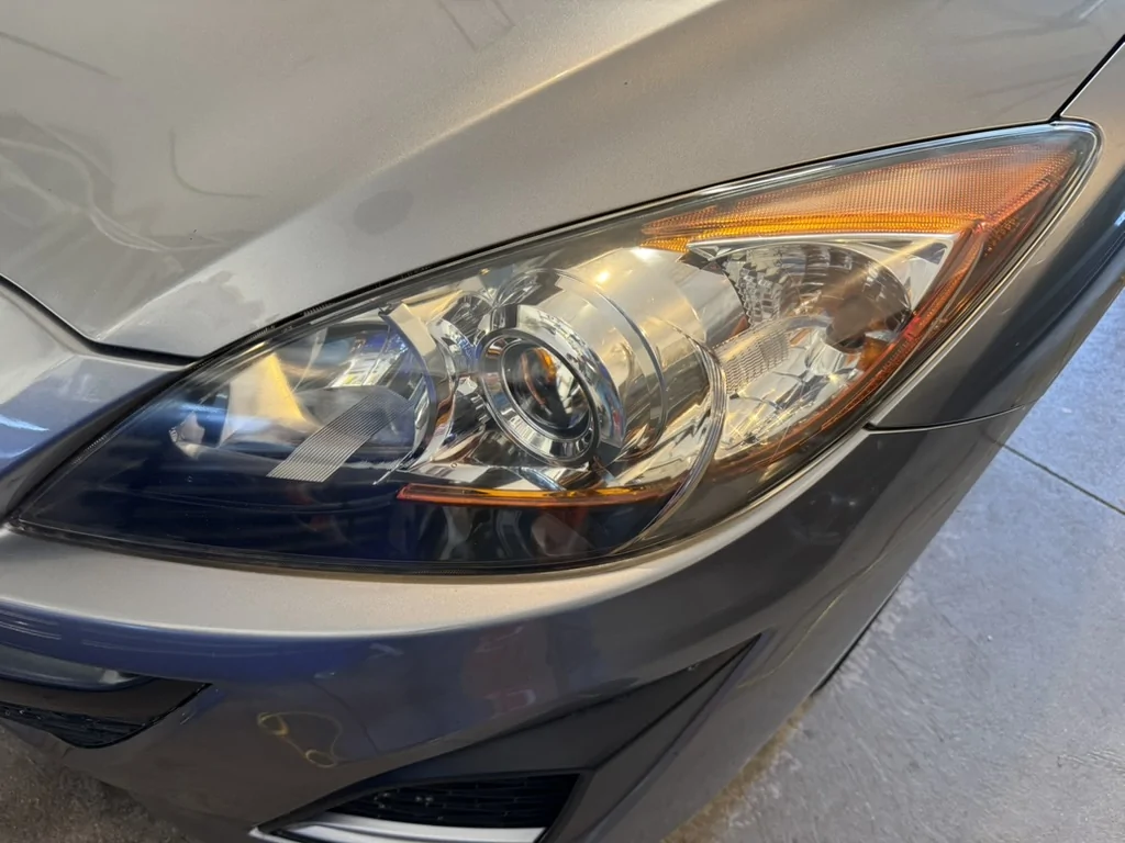

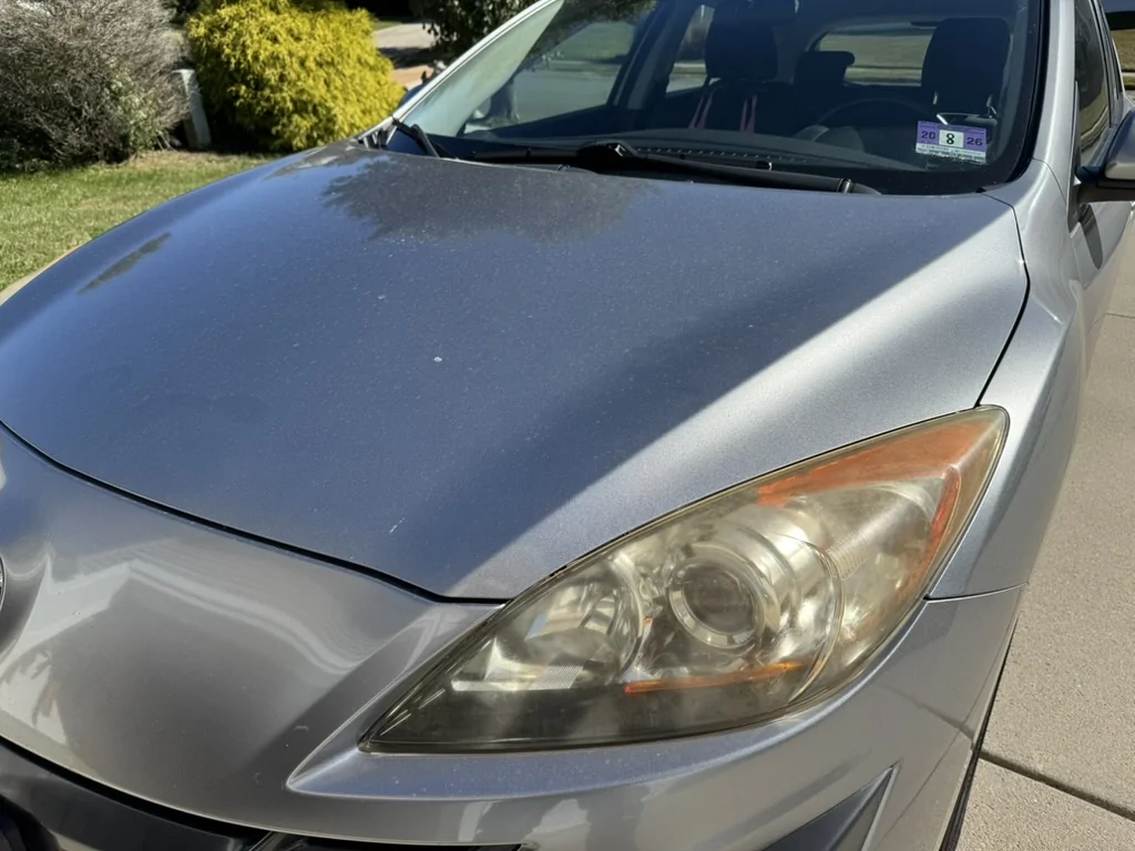

@DFB5.0, could you suggest any good headlight restoration kits? I really appreciate your help!
Depending on how bad they are, I will hit them with a cutting compound on a wool pad, then following a finishing polish on a foam pad. That usually brightens them up without having to delve into messy wet sanding. I use Sonax Cutmax on a Rupes blue wool pad, then finish them out with Sonax Perfect Finish on a Rupes yellow foam.
Otherwise, you need to go into wet sanding them. I'd look at this kit, expensive but has everything you'd need -
Headlight Polish Set | The Rag Company
Otherwise, Meg's have two kits available -
Meguiar's® Two Step Headlight Restoration Kit, G2970, Kit | Meguiar's
Meguiar's Ultimate Headlight Restoration Kit - The Perfect Headlight Repair Kit to Remove Yellowing and Cloudiness from Headlights - Easy to Use and Seals Headlights with 18 Plus Months of Protection | Meguiar's

I used the Cerakote kit on my mother's car and I was surprised how well it worked. Be careful to not over-apply the clear. Be careful not to hit any paint during the process -- use lots of tape or remove the headlamp.

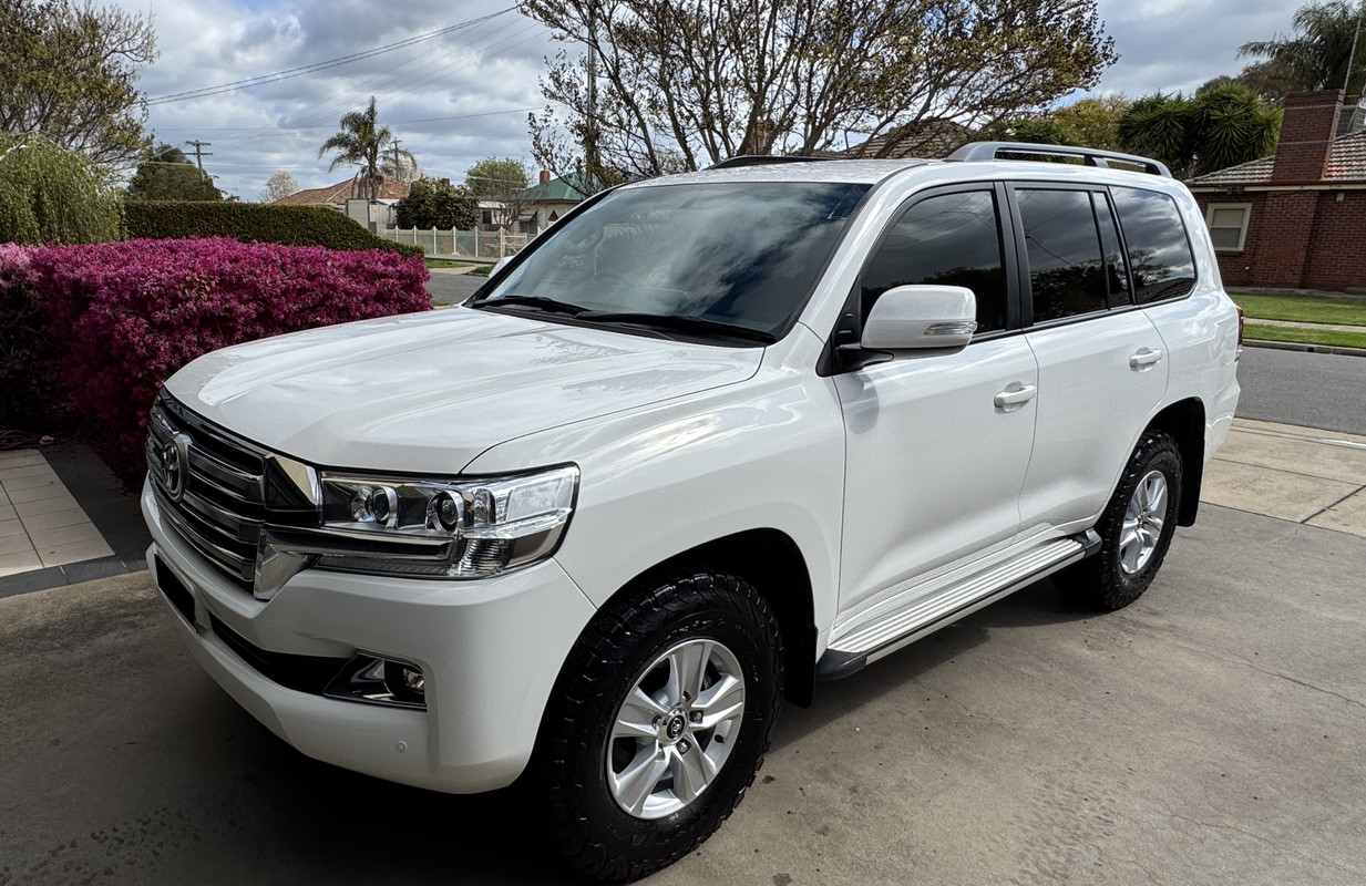

Toyota Landcruiser 200-Series Detail
I seem to be the Landcruiser 200-Series expert of late. This example with 160,000 km on the clock came to me as a referral, and well, he got his monies worth today! Upon retrieval, the car looked deceptively tidy. However, on closer inspection I knew this would be a long one, hence the lack of progress images, I just had to get on with the show.
Wheels & Tyres -
Quite a lot of time was spent on the wheels, I suspect they have never had the barrels cleaned due to the stubborn build-up of brake dust. I threw everything I had at them, even wheel acid, in the end I got them decent but not perfect. You can't reverse years of neglect in 2 minutes. Also, the tyres were brand new and required two rounds to remove the blooming.
Product & Tools Used -
- NV Purge
- Shine Supply Wise Guy (Tyres & Wheels)
- Meg's Acidic Wheel Cleaner
- EZ Detail Large
- EZ Detail GO
- Detail Factory XL Tyre Brush
- Chemical Guys Boars Hair Brush

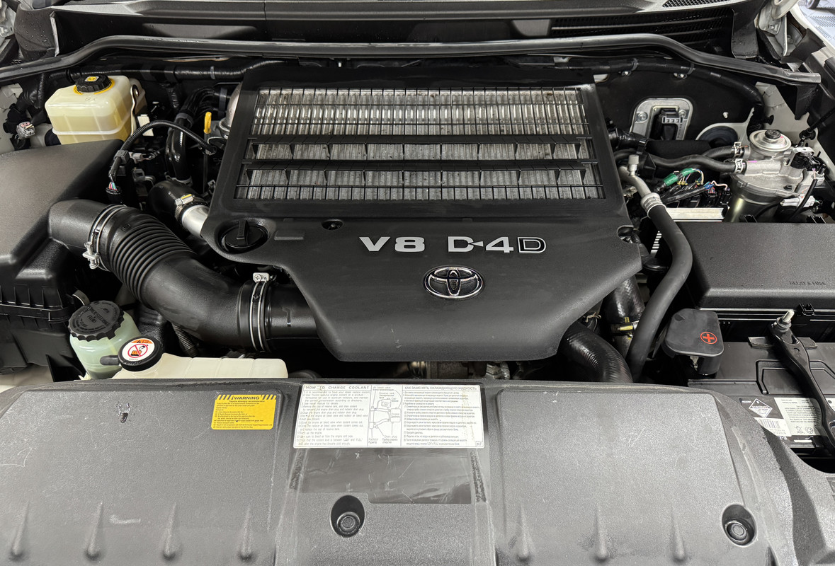

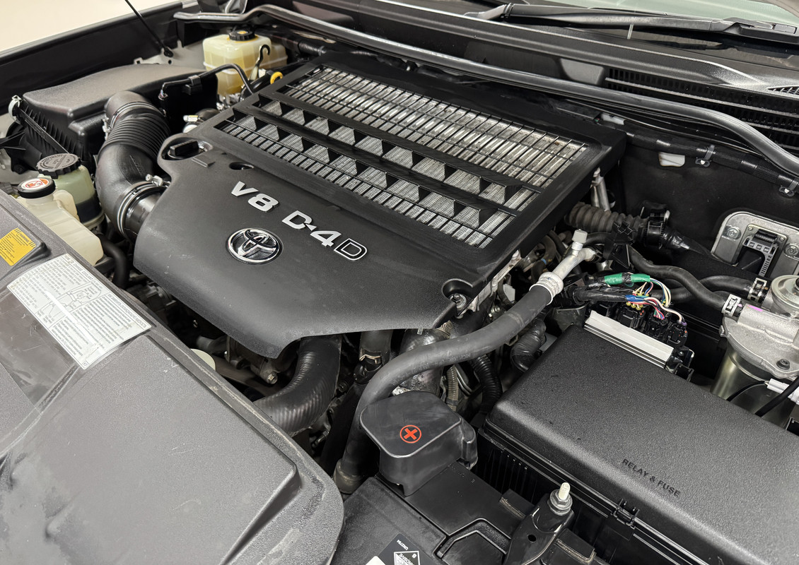

Engine Bay -
Suspecting the owner wouldn't even notice my efforts here, I kept it simple with this one. I foamed with BH Touch-less, allowed to soak, then rinsed. A healthy dose of Megs Hyper Dressing and quick hit with the blower, job done!
- Bilt Hamber Touch-less
- Meguiar's Hyper Dressing (5:1)
- MTM PF22.2 Foam Cannon
- EGO 765 Blower

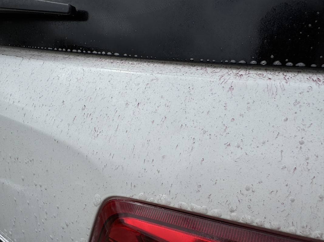

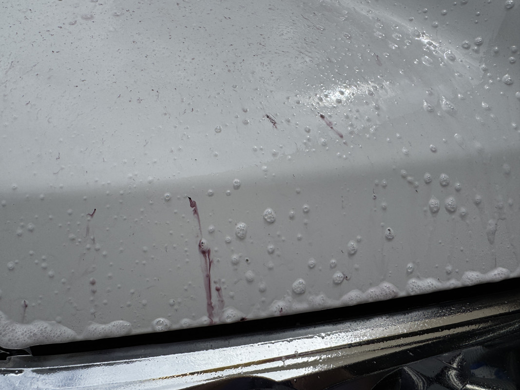

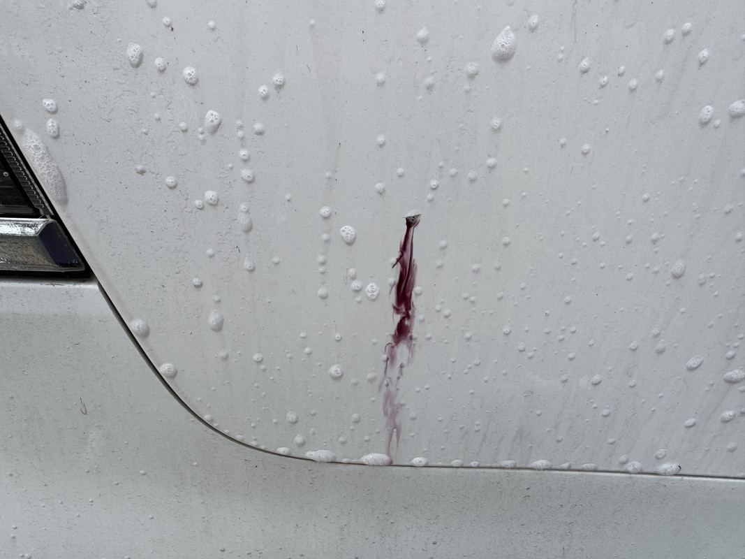

Exterior Decontamination & Cleaning -
On inspection, it was clear the owner has kept this car in decent shape. Other than some baked-on road film and a few bugs, it just needed a decent deep clean.
As per recent details, the vehicle was treated with NV Purify, allowed to dwell, then foamed with Koch Chemie Active Foam. As you can see, I got a fair bit of reaction on the paint, and as always, the rear tailgate was the most contaminated. To be honest, I was expecting more.
With the car rinsed, I went around with a brush and APC to clean the badges, grill and around the door handles. For the contact wash, I used Carpro Descale in both the foam cannon and bucket. Because of the size of this thing, and the fact its warming up now, I broke the car into three sections to avoid the soap drying on the car. For a pH neutral wash, you can sort of get away with that, but not with an acidic or alkaline soap.
After another rinse, I ended up claying the rear tailgate and glass as it was super crunchy. I then went around and applied Carpro Hydr02 to the entire vehicle, wheels included. The big 200 was then moved into the garage, this one actually fits, then hit with the EGO.
- NV Purify
- Koch Chemie Active Foam (Alkaline)
- Koch Chemie Green Star (6:1 APC)
- Carpro Descale (Acidic)
- Carpro Hydr02 Lite
- Detail Factory Boars Hair Brush
- TRC Cyclone Bone Wash Pad
- Economax Clay Mitt
- EGO 765 Blower
Post-Wash Details -
After the blow down with the EGO, I went around and applied NV Boost to the whole vehicle. The door jambs were then cleaned/dried using a towel and more APC. The exterior glass was then treated with Optimum Glass Clean & Protect.
- NV Boost v2 (Ceramic Spray Sealant)
- Optimum Glass Clean & Protect
- TRC Car Wash Towel (For drying/sealant application)
- TRC Car Wash Towel (For door jambs)
- TRC Dry Me A River (Glass Towel)

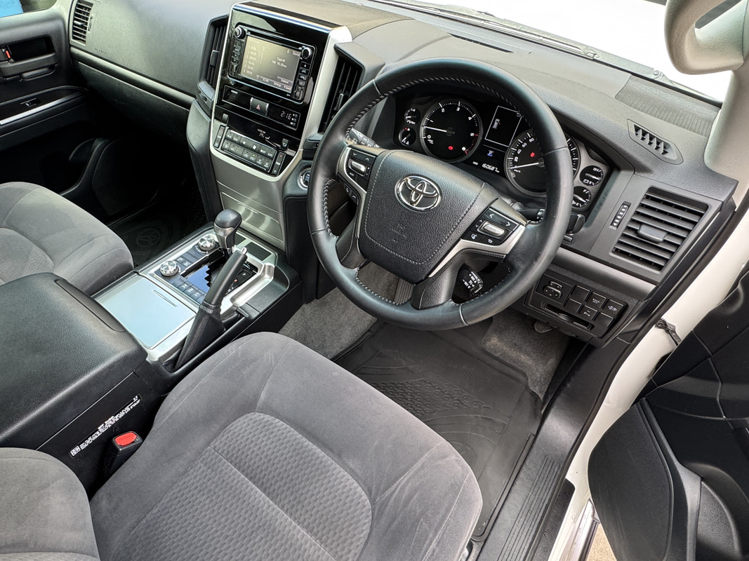

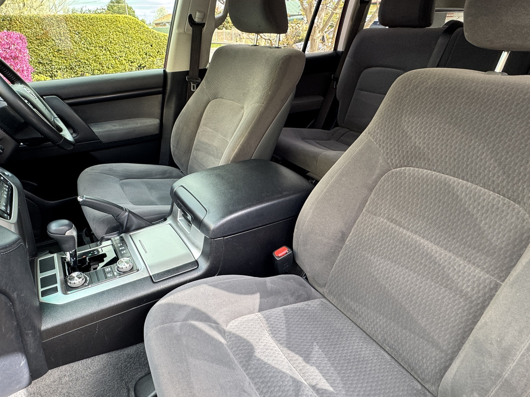

Interior Detailing -
Along with the wheels, this is where a lot of time went. As you will see shortly, this vehicle has vulgarlour seats and not leather. I much prefer leather as you can soak it down, scrub and dry with a towel. On fabric, you can't really do that unless you want to be extracting them afterwards. Also, leather doesn't end up being a dust trap like cloth, which will often migrate deep down into the foam base.
To start, I went in with the Tornador to remove as much trapped dust and debris from the interior as possible. I then vacuumed and vacuumed and vacuumed. Then I vacuumed some more, then a little more after that.
For those seats, I sprayed them down with Koch Chemie Pol Star, scrubbed with a carpet brush, then used my Bissel to lift up as much of that Pol Star as possible, followed by a rub down with a towel.
The door trims were quite grotty, so I cleaned these with the Carpro InnerScrub and P&S Xpress. The steering wheel was so glossy that you could use it as a mirror. In this case, I scrubbed with Xpress and a leather brush, likewise the gear shifter and handbrake, then followed with NV Nourish. The transformation here was remarkable, the wheel in particular back to a lovely soft matte finish. This is what I love about detailing, taking something neglected and bringing it back to life.
From here, the glass was cleaned with Invisible Glass, likewise the gauge cluster lens and central touchscreen. The whole interior was then wiped down with P&S Swift. Having earlier cleaned the rubber floor mats, these too received a treatment with Swift before being re-installed. Finally, the carpets and seats were misted with Koch Chemie Fresh Up.
- P&S Xpress (Interior Cleaner)
- Koch Chemie Pol Star (Textile Cleaner)
- P&S Swift (Interior Detailer/Dressing)
- Stoner Invisible Glass
- NV Nourish (Leather Quick Detailer)
- Koch Chemie Fresh Up (Odour Neutralizer)
- Tornador Basic (Air Gun)
- Karcher WD6 Vacuum
- Bissell Spot Clean
- Vikan Carpet Brush
- TRC Car Wash (Interior Towel)
- Carpro InnerScrub
- ColourLock Leather Brush
Finishing Touches -
Returning to the wheels, I wiped them down with Carpro ECH20, then dressed the tyres using Shine Supply Decked Out. Long story, the owner completely serious asked me if the price included "putting tyre black on the tyres". Present at the time, his brother immediately erupted into laughter before I said that tyre dressing was my favourite part, so naturally it would include "tyre black". His brother later asked me to do one thing, leave one tyre undressed to see if he'd notice. Oh, how I wanted to do that, but I just couldn't do it. Anyway, he got his "tyre black", of which Decked Out is hard to miss as its quite glossy.
Finishing up, the engine bay was given a quick Q/C wipe down, and the tail gate scuff plate treated with Mother's Naturally Black.
- Carpro ECH20 (16:1)
- Shine Supply Decked Out
- Mothers Naturally Black
- TRC Ultra Utility Brush (Dressing Applicator)
- TRC Car Wash Towel (For final wipe down)
- TRC Rip-N-Rag (For Naturally Black & Final wipe of the tyres)

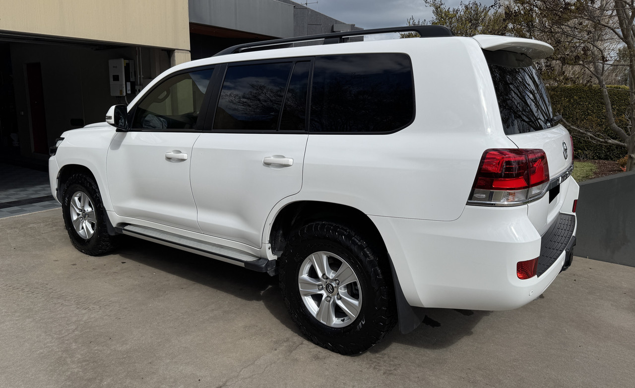

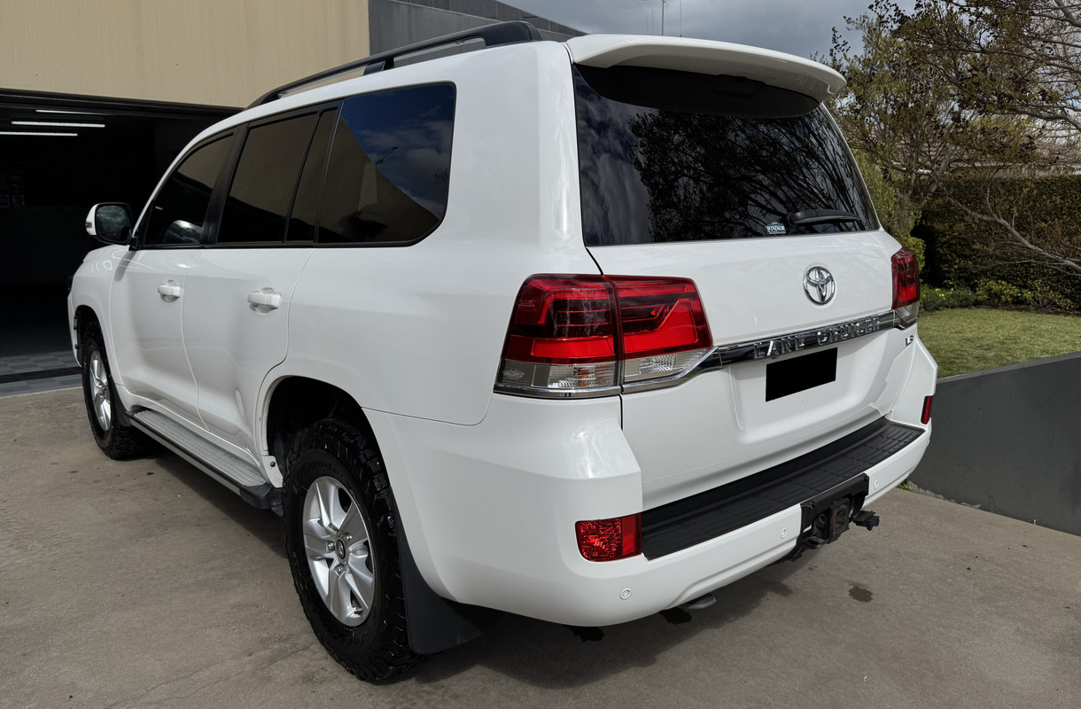

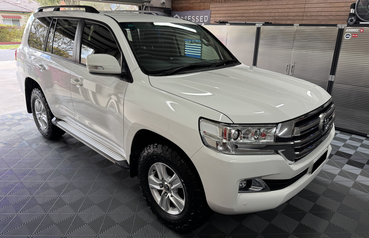

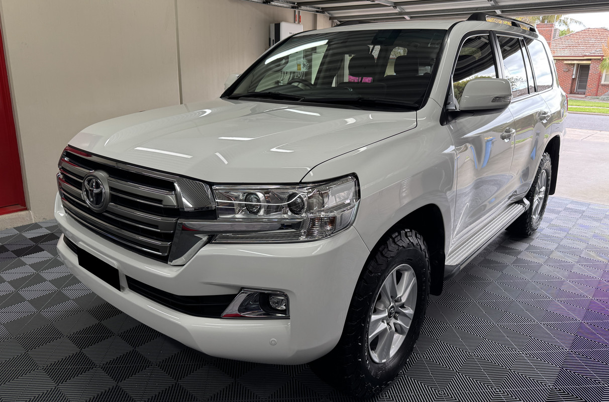

Final Results -

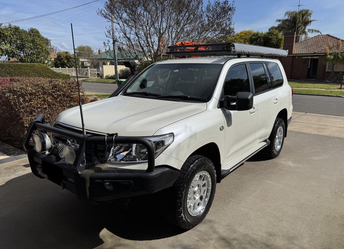

Note the lack of off-road gear on this 200-Series, this one being used purely for family car duties. Something else I noticed is the flat / non-metallic white, not the pearl metallic used on the other 200-Series I've detailed.
For what is easily a $100,000 vehicle, it's pretty stingy of Toyota to spec crappy grey cloth trim on this vehicle. And this GXL isn't even the base model! In reality, Toyota could have specified hessian and straw for the seats and people would still buy these things.
I much prefer this MY2016 version of the 200-Series, the slimmer headlights give it a more confident look compared to the blob-like headlights of the original. And I have to say, looking out over that sculpted bonnet is epic, which was also part of the MY2016 facelifted.
I'm not much of an SUV fan, especially ones as big as this that are used to carry around one or two children (if that). I'm also not a big on diesel engines. But.................that 1VD V8 is such a honey of an engine, especially with the Power ETC engaged. Smooth, super torquey, and sounds nice too.
For US readers, you didn't get this engine. With a 4.5-litre capacity, this twin-turbo V8 diesel produces 210 kW (282 hp) @ 3,600 rpm and 650 Nm (479 lb-ft) @ 1,600–2,800 rpm. So, while these things are big and heavy, this engine with its rich torque delivery is the perfect powerplant for this vehicle. It's also why these 200-Series command a very healthy premium on the used market, basically a name your price proposition for a seller as no one likes the new 300-Series with the V6 Diesel.
Anyway, I'm buggered! 💤 🛌💤
