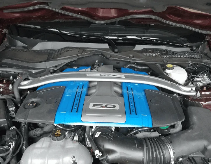

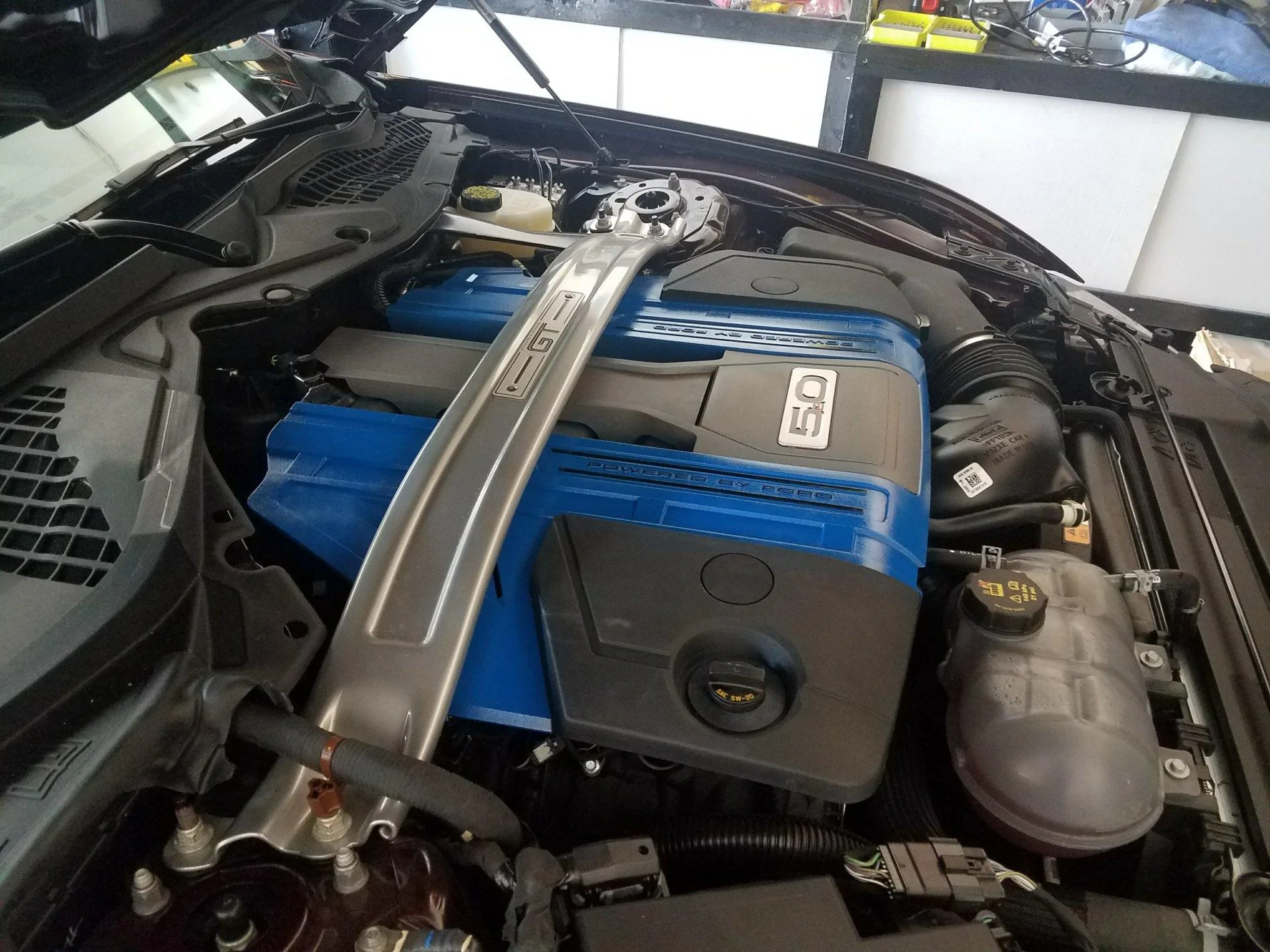

I like your Blue. May try something like that. Maybe a darker Ford Blue.
1 old racer
Feb 20, 2018
89
1,727
2,376
Fontana CA
Will
2018 Royal Crimson GT PP1 prem., and others
Thanks, and even though it looks light in the photo it is ford blue (darker blue)

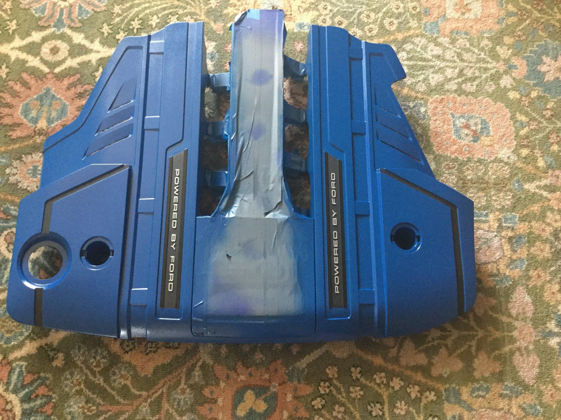

Mask, adhesion promoter, paint, sand, clearcoat.

Did you masc all the letters? I saw someone saying they just sanded the paint off the letters after.

No I didnt. I painted the whole section and blocked sanded the lettering. After sanding I clear coated the entire painted area to blend it all togather. Just make sure you mask off the painted area around the letters you are planning to sand so that you dont mess up the paint on the area above and below the letters.

A little different variation of some on here. I like it. Should I uncover the center part before I put the clear on it? Also, anyone else break off one of the clips getting the damn cover off?

it looks great! I like the way you laid yours better then mine. I would clear coat it just as it is now, with the masking in place
