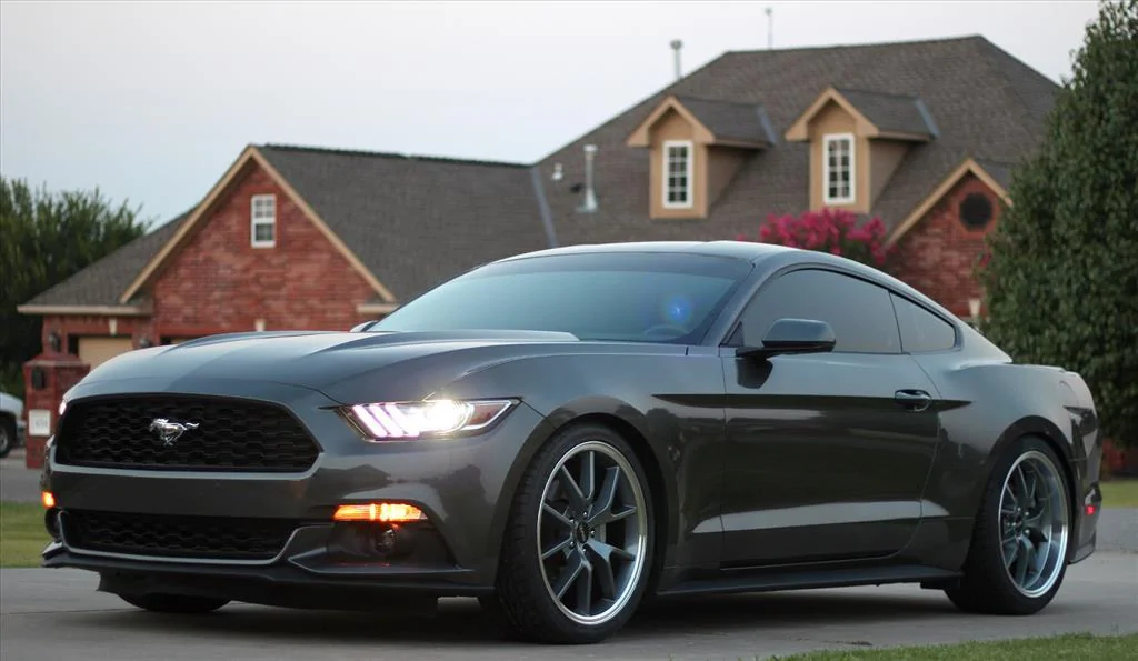

Currently sitting at about 28k miles and drive every day about 80 miles up and down the interstate. I have an Unleashed tune and MMR intake but otherwise the car is pretty much stock. Any suggestions on what I should do to it next to improve drivablity and possibly fuel economy? I currently average about 29.4 MPG which I am happy with but the more the better.
I was leaning towards a bigger intercooler but I wasn't sure how much benefit I'd get considering the car is driven mostly on the highway going 70+ mph.

A bit off topic but what is your wheel/tire/suspension set up? Have you thought about exhaust work? resonator delete or a cat/axle back?

It's the FR500 replica set from LMR with Eibach Sportlines. Rides real nice and never has rubbed on me so I'm happy with them.
I thought about exhaust but considering it's a 4 cylinder and from the sound clips I've heard...I just can't handle that tone.
