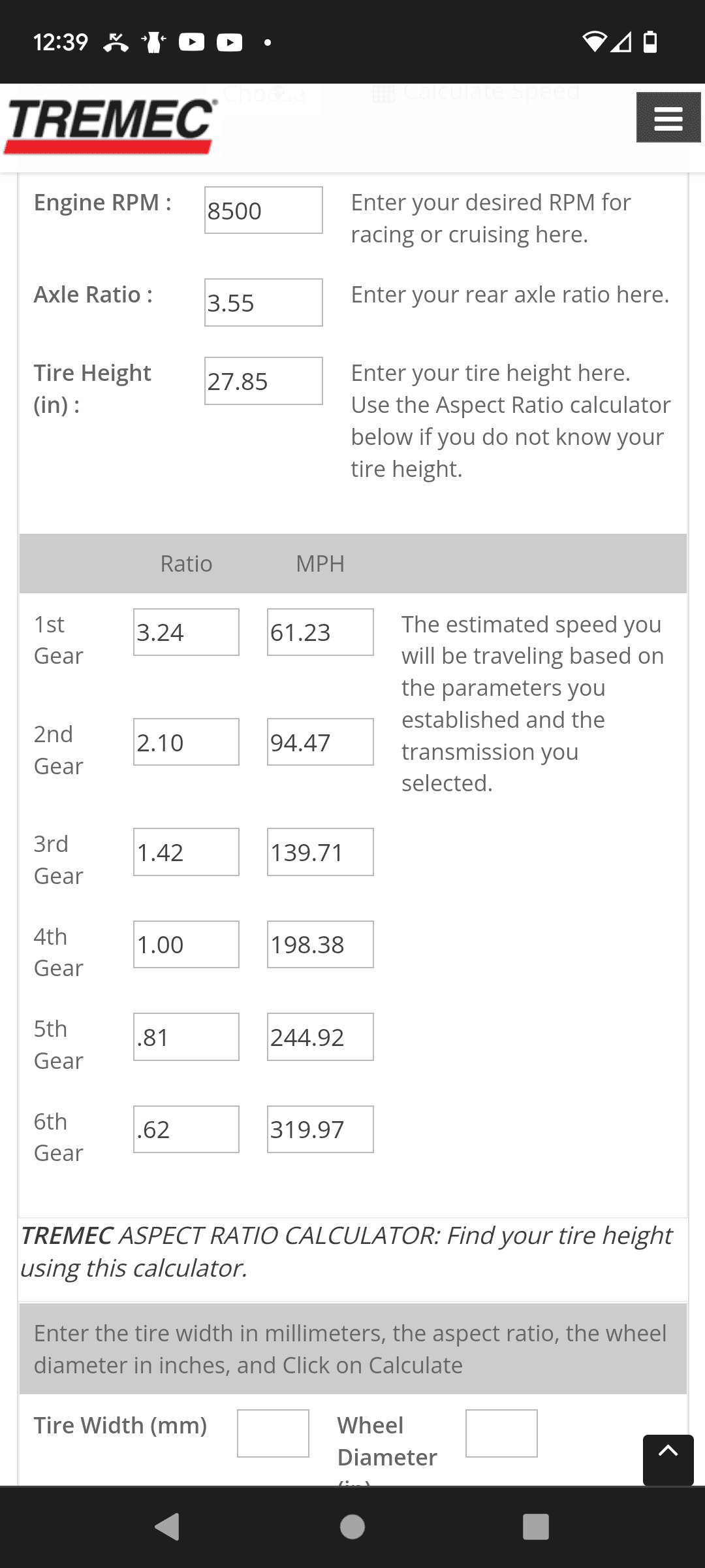

Calimer Built Stage 3's gear ratio is:
GEAR RATIO
1ST 3.46
2ND 2.29
3RD 1.61
4TH 1.26
5TH 1.00
6TH 0.61

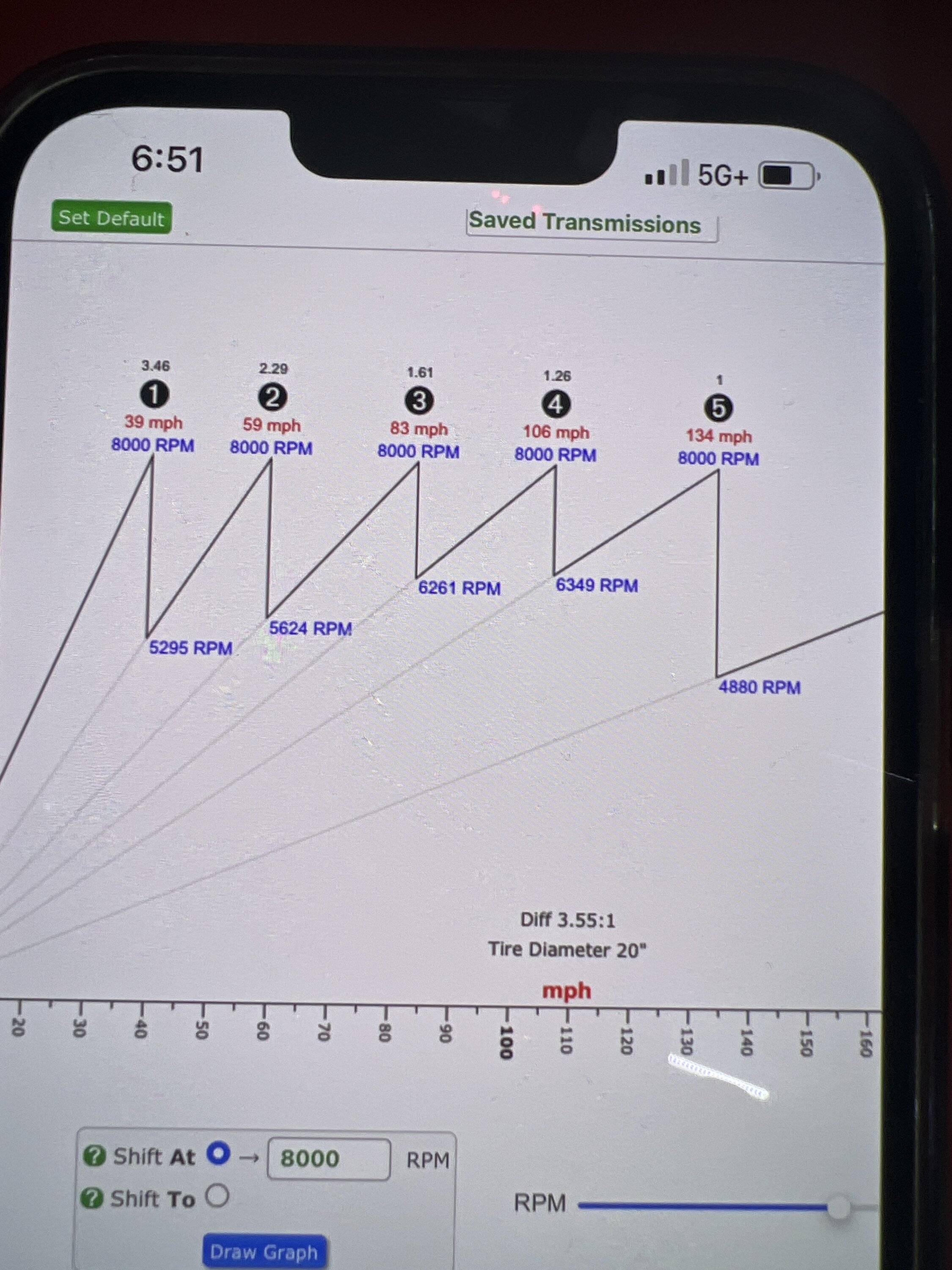

Does anyone know what MPS I will be at the end of each gear? I wouldn’t need to shift to 5th in a 2/4 miles right ?
Unas2k5
Unas2k5
May 30, 2022
86
1,731
699
Detroit
Samer
2015 Mustang GT, 2021 Explorer ,2019 Impala

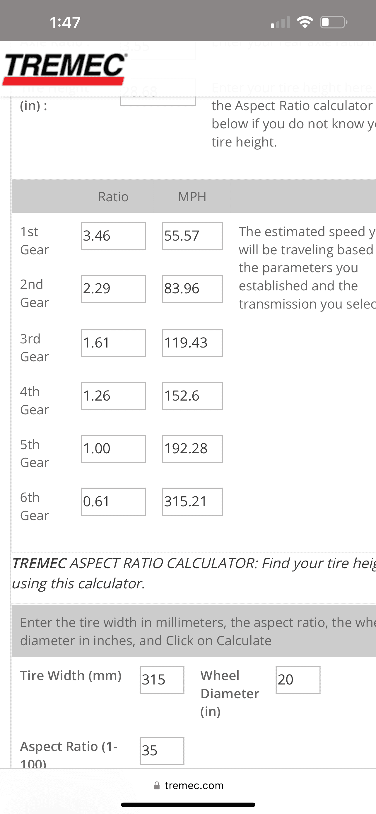

I don’t believe this is accurate

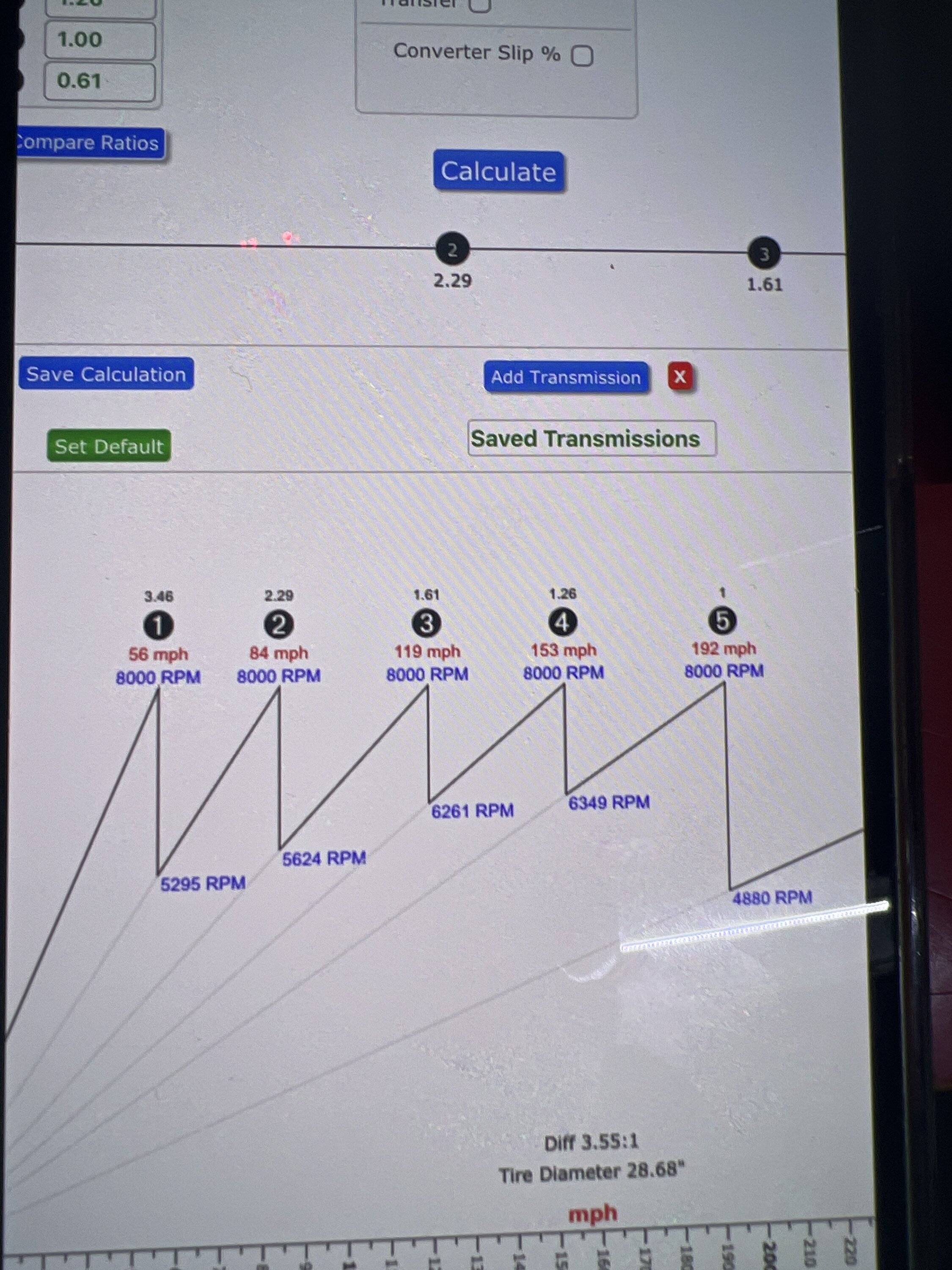

Ok adjusted rear tire height

Thank you @illtal this one was so much easier.

So for 60-130 shift end of 2 then 3-4 ? My friend told me to start at 3 lmao
