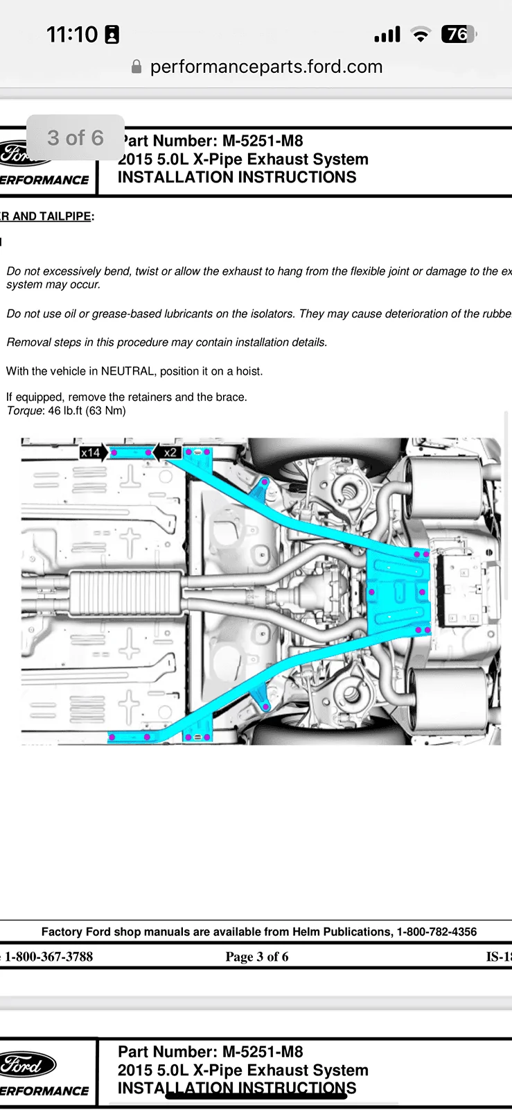

What is this rear subframe beace
sms2022
Jan 22, 2024
44
897
983
Detroit
SS
2022 Mustang GT PP1 premium
it’s in the ford performance x pipe install instructions. Looks like a great design.

Anyone installed it on a coupe? Seems like it would be better than the smaller steeda brace
WD Pro
Jan 18, 2018
132
6,818
13,667
United Kingdom
Lime GT
I believe that braces the frame / body, and not the subframe i.e. the subframe is still free to move ?
WD :like:
MAGS1
Mar 6, 2020
97
11,630
19,099
Somewhere in Middle America
Mark
2022 Mustang GT
Unless it does keep the subframe from moving, there would be no benefit to adding it to a fastback/coupe. It’s there for structural reasons, the roof and rear pillars on the coupe/fastback provide the structure that that particular brace is used for. Plus I’m guessing it’s quite heavy, a lot heavier than the Steeda braces.
MrMike
Feb 15, 2016
33
997
1,285
US
16 Mustang GT, 23 Bronco Wildtrak
I doubt it. Little benefit since it braces to the frame instead of the subframe. It also doesn't fit with many aftermarket exhausts, and exhaust is a pretty popular mod.
mavisky
Nov 17, 2018
2,399
3,303
Cumming, GA
Kyle
2018 GT350
Absolutely different use cases. This braces the body to the body so the IRS cradle is still free to do whatever the hell it wants. If the material is anything like the old braced on my S197 GT500 convertible you can also damn near bend them by hand.
sms2022
sms2022
Jan 22, 2024
44
897
983
Detroit
SS
Got it. Looks good, doesn’t work.
