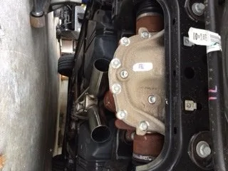

There is a sticker on the diff housing that says what ratio you have (if yours still has it). Mine has 355 on it which matches my window sticker.
