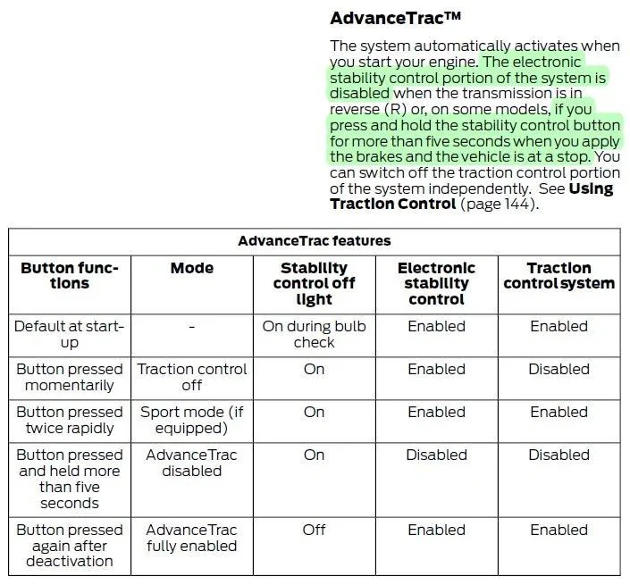

No, it does not. Track mode only further reduces the amount of wheel spin before it kicks in. To completely defeat traction control you must hold the TC toggle for 5-6 seconds until the TC light lights up.
I discovered this last summer at the drag strip. My first trip into the burnout box I had only put the car in Track mode. It refused to do a burnout. After holding the toggle until the TC light lit I was able to shred the rears.
Interesting. As far as I can recall, anytime I've ever put the car in Track mode the TC Off light has come on by default. However, it's been a while since I've done that so I'll check the next time I'm in my car. Also, I've never attempted to break traction while in Track mode so now I have a good excuse to do so!
It will "turn off" TC, but not AdvancTrac (the overall TC/stability system). If you hold the TC button for 5 secs the screen will say AdvancTrac disabled.

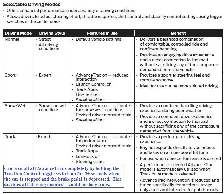

From the Owner's Manual. The blue text is a note I added.

for track mode, what does "Engine takes on a more powerful tone" really mean?
maybe i heard it on mine? maybe its a placebo effect? can anyone else attest?
