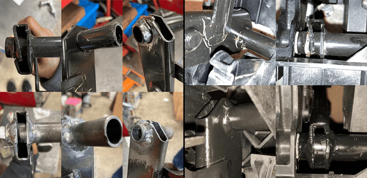

I pulled the factory spring a few thousand miles ago and have enjoyed the feel/feedback of the clutch w/o assist, reminds me of my old 93 notch. Haven't noticed the clutch peddle not fully returning to the top I'll check into this over the weekend. Thanks for the in-depth reply.This is what Steeda's site cites for that product:
"Many new Mustang owners have found that taking out the stock OE spring will give you somewhat similar results, but realistically the clutch becomes far too heavy especially if your Mustang is daily driven. Most owners fail to realize the prolonged effects of simply taking out your factory OE spring and not replacing it with another spring. By negating your factory clutch assist spring you will notice chatter/NVH from your clutch pedal. Your clutch pedal will never fully return to stock position without any assist spring, and over time your slave cylinder may begin leaking due to constant pressure on its seals from the clutch pedal not returning to the stock position."
That sounds like they're saying the cylinder and parts are not made to withstand lack of the spring. Maybe cars are build with less margin for error, I don't know.
What they're saying makes sense though - if the pedal never returns, it's like you're always feathering your clutch for a long time or resting your foot on the clutch while driving, each of which is a known "no-no."
That's pretty sweet, especially when my experience should be similar as we both have a Bullitt (although I think that doesn't matter).
Did you just put in the spring, were you able to reused to clips that hold it on?
