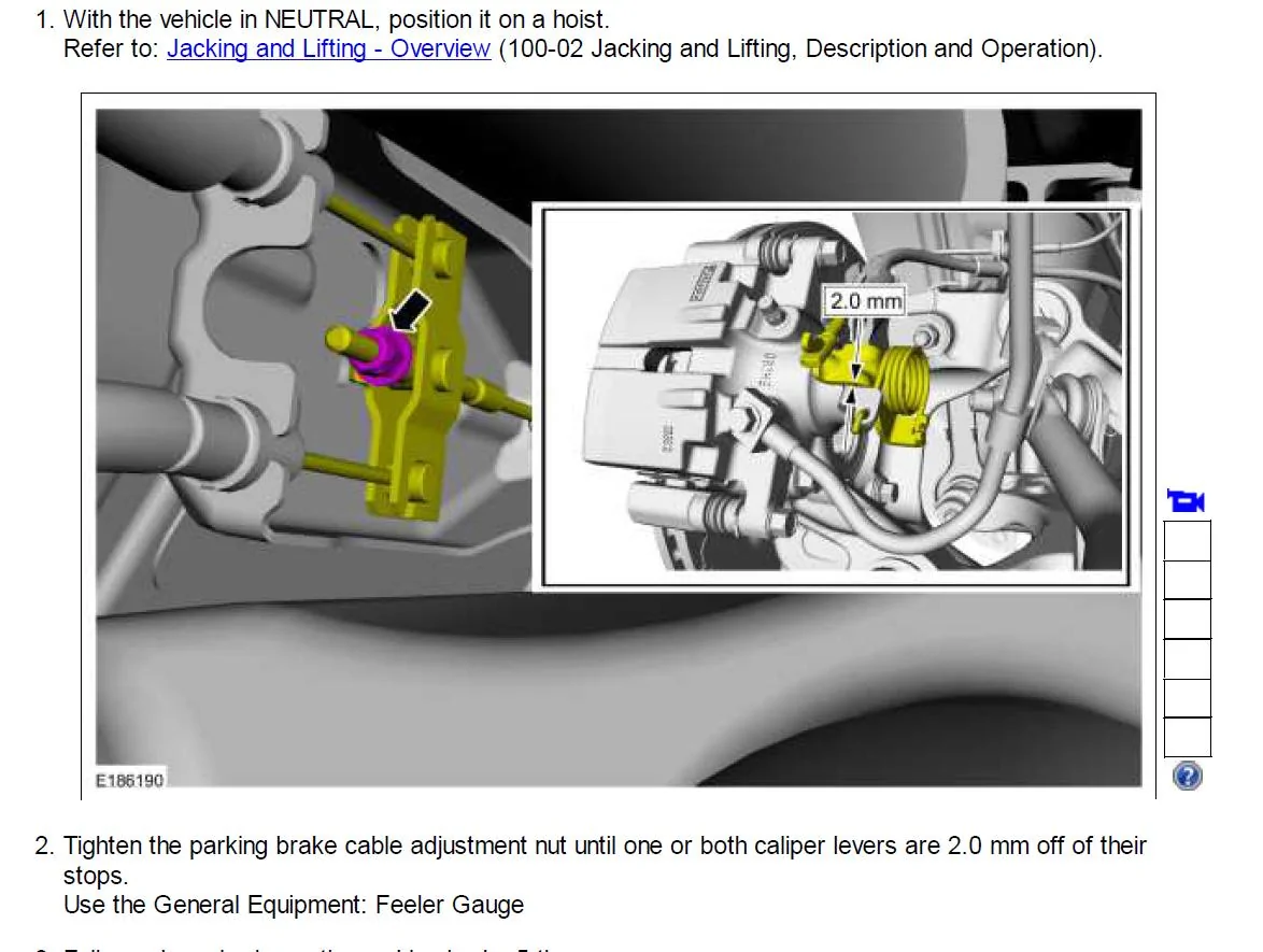

Is the handbrake on the Mustang a part of the caliper or is it the "shoes inside the disc hub" design?
It's a cable operated actuator on the caliper according to the workshop manual (unless you have an SVT performance package then it's a "shoes inside the disc hub" design).
Not a hand brake issue, the pad was stuck on the disc which means two things:
- Caliper sliders are failing due to dirt or caliper failure
- The pads are not seated on the sliders 100%
Shall see what Ford say tomorrow.

When you say "pad" do you mean only one pad was stuck to the disc? In my experience of sticky rear calipers of this type, which is s very similar design to most VW's, is the handbrake mechanism that causes the issue.
Fundamentally, it is a mechanical assembly with very little movement and adjusts itself for pad wear. If it goes mad on adjusting itself it clamps the pads onto the disc, just like it looks like yours did?
If it is only one pad, which I doubt, it'll be the sliders.
Of course, it could also be the ABS Actuator getting a signal to brake that wheel? ESP??
The SVT Performance Package does not apply to the GT Performance Pack, so that's GT350-only. I can confirm that (at least on US cars) the parking brake is a cable-actuated mechanism on the rear of the caliper.
I believe these are the exact same rear caliper I had on my 2006 GT, which is the same rear caliper my sister had on her 2003 V6, which is the same caliper I had on my 2003 Taurus and 1998 Sable. I'm sure part numbers have changed, but they're the same damn caliper.
ETA - I'd also have them look at the outer CV boot on the halfshaft, just to make sure there was no damage to that rubber part, or the grease inside.
