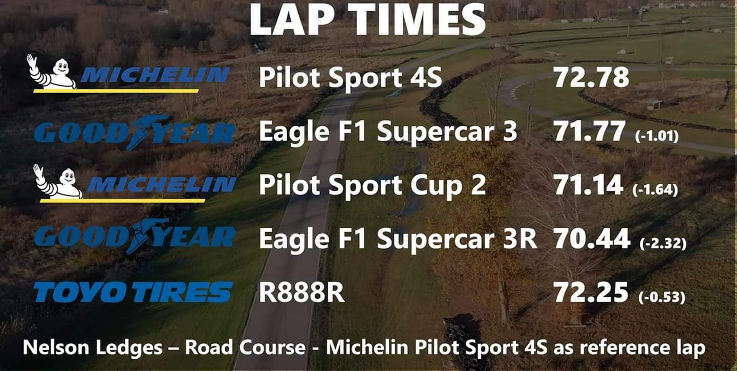

Not that I'm in any way, shape, or form a pro driver and my consistency could be all over the place but I don't necessarily agree with these. In my experience, the Supercar 3 was IMMENSLY faster than PS4S.
You'll be disappointed.
I hope not, lol! I got them for 60% off so I couldn't say no.
I've heard good things about them. Not the fastest tire, especially for a slick, but decent and good consistency. Plus I can get a set of 4 for under $1k
1s on a 72s course is a pretty sizeable amount. Also did you run the same size and age of tires PS4S and SC3?
Hopefully they work out for you. At that price, go for it! The 3R is the one to get in that type of tire.
