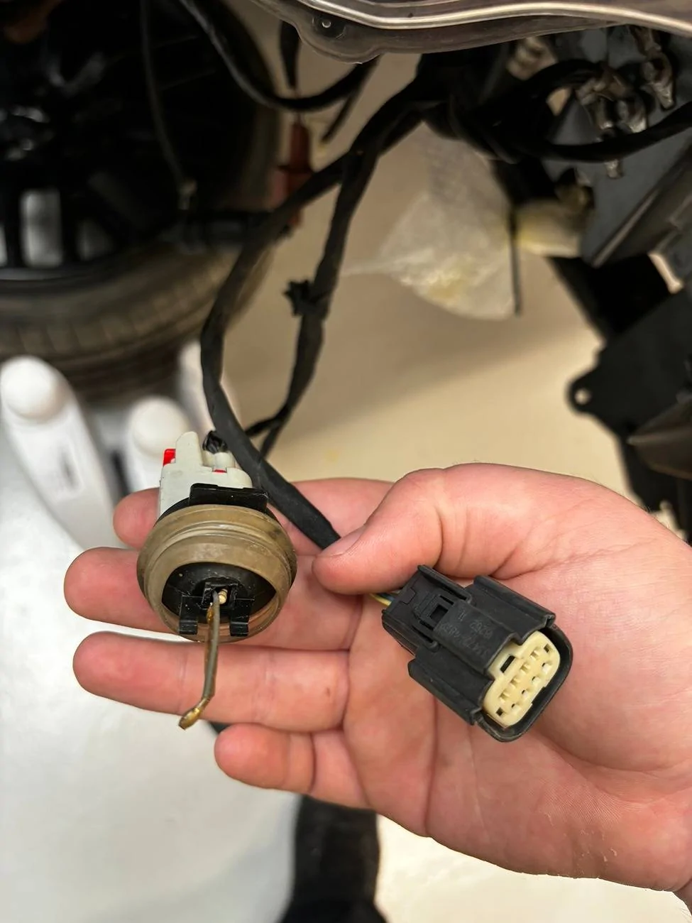

Hi all,
I have recently bought a 2019 Ford Mustang GT as a rebuild project from CoPart,
Unfortunately, the front bumper and all ancillaries were missing so I'm currently playing the game of guessing what goes where,
I can't figure out for the life of me what the molex connector is for on the front right side next to the washer bottle, it isn’t the headlight!
I’m presuming the one to the left is a temperature sensor or similar, also have absolutely no idea where that goes,
Any help would be greatly appreciated

For anyone in my position in the future I have found the answer!

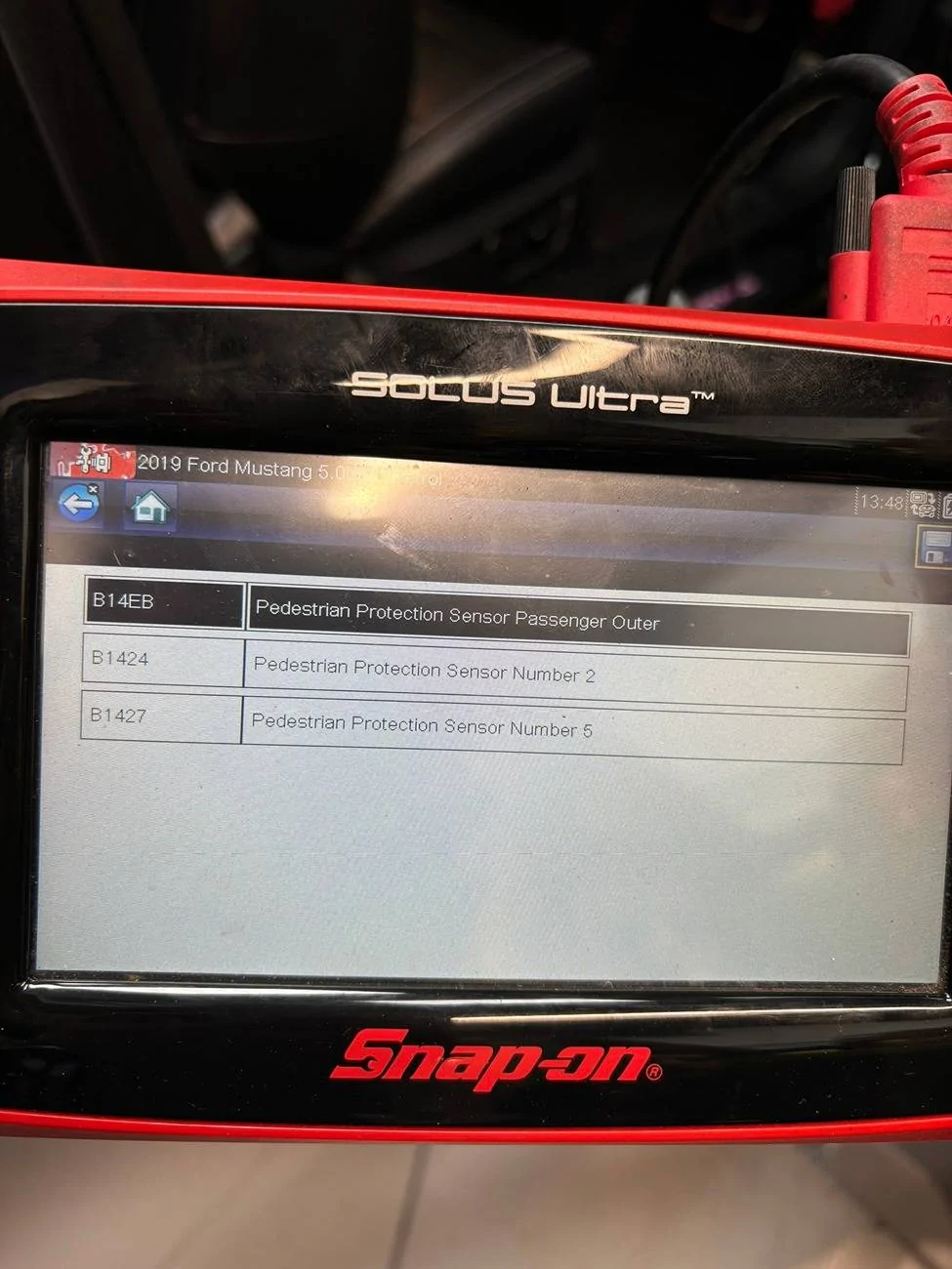

After running an OBD scan and clearing all the codes, we had 3 more come up:

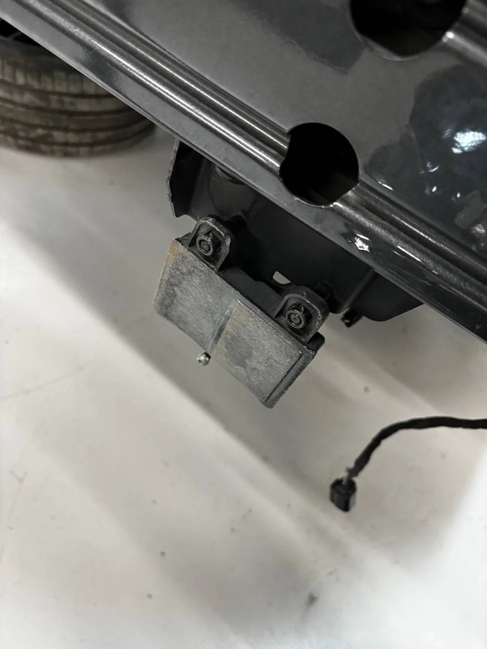

They also helped out by giving me the part numbers for the sensors:
Left & Right: GR3T-14B653-BA / 5332947 / GR3Z-14B004-A
Centre: GR3T-14653-AA / 5332942 / GR3Z-14B653-AA
