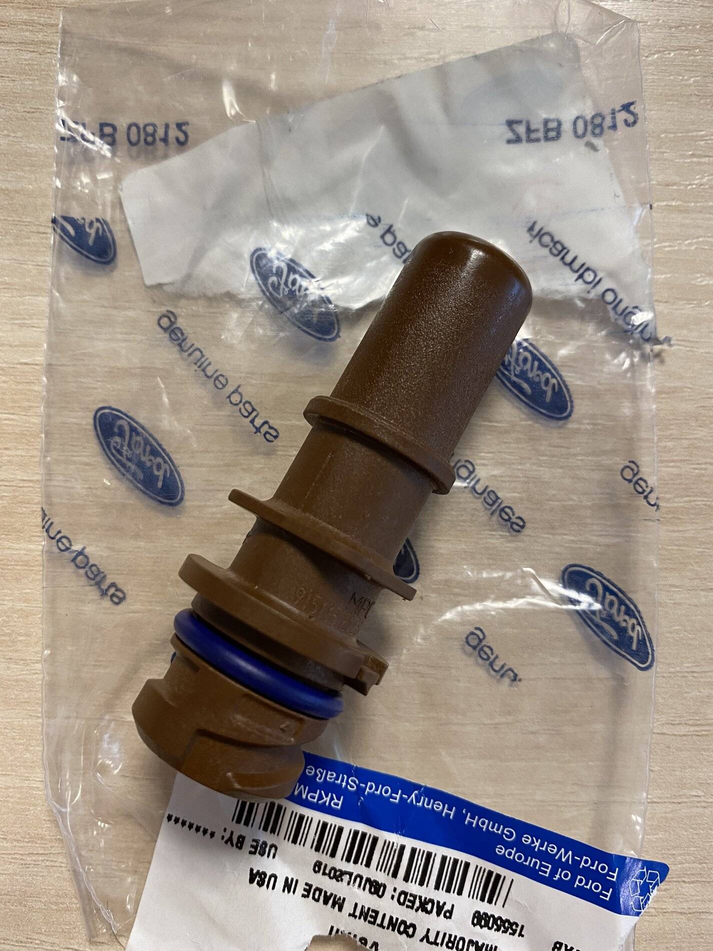

Thank you all for your suggestions!
I indeed think it's that after more checks yesterday. Does someone know where I can find the PCV valve reference to order a new one online ? Otherwise I will ask my local Ford dealer.
Einstein_nikola
Jun 20, 2020
46
320
89
Chicago IL
Sir Galahad
2015 Mustang GT PP
Just go to the parts department from the ford dealer and they will have it, i got mine for 22$ in total with taxes and everything from them.
