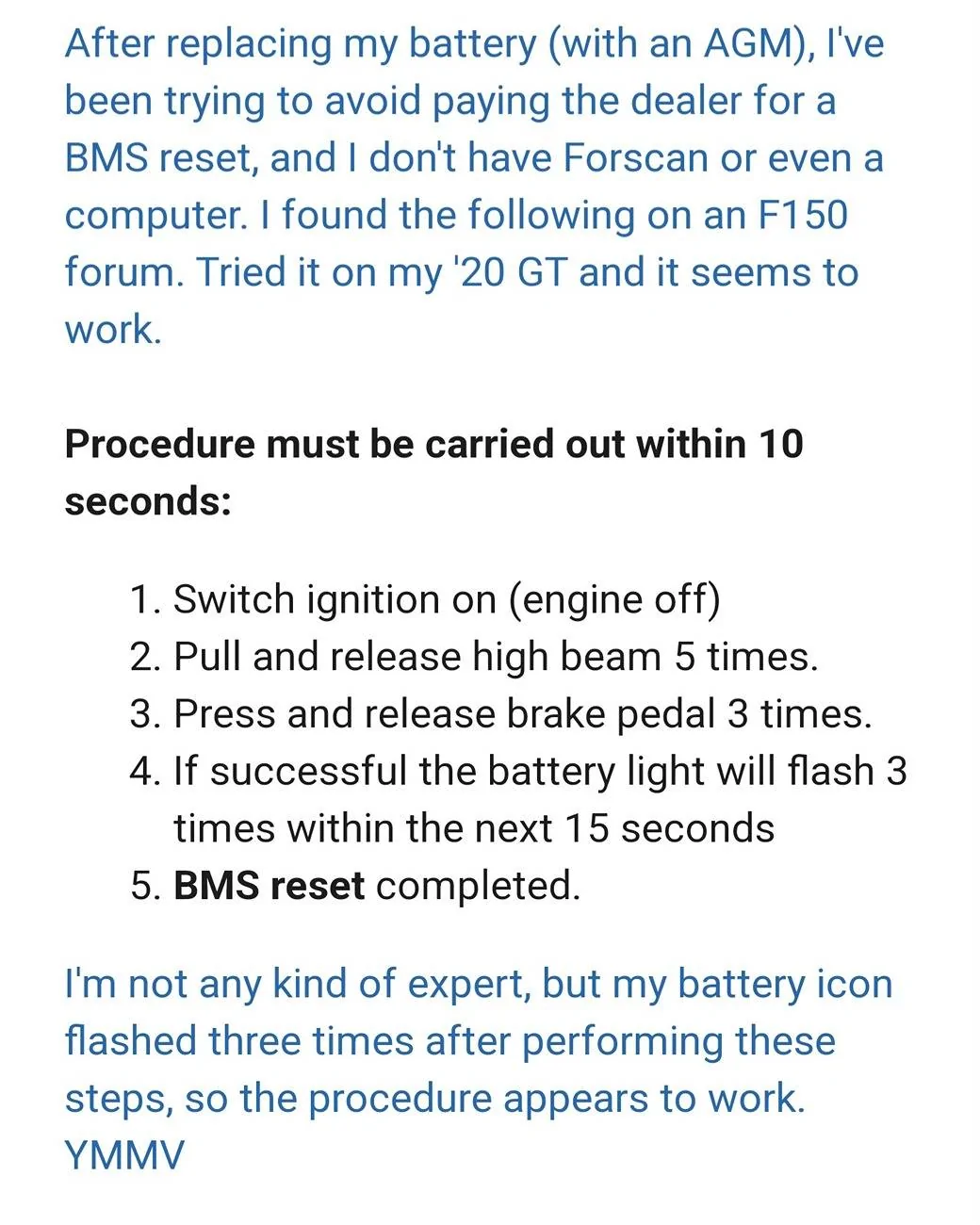

How old is the battery? Have you reset the BMS?

I’ll try that out asap thank you! Does resetting the bms reset my tune by any chance just wana make sure it doesn’t 😂
