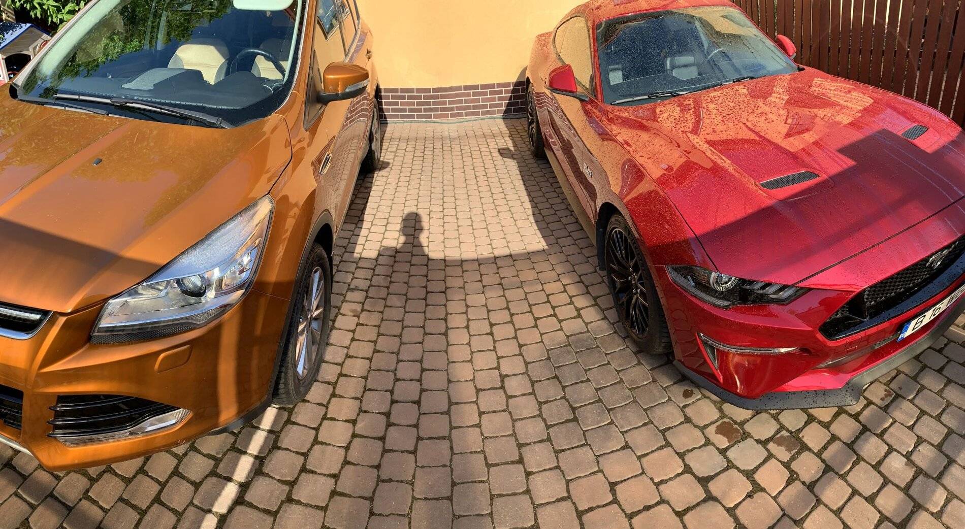

But here's my problem. Every time there's a bit of water on the car, it just sits there, in tiny beads, taking forever to evaporate. And when it finally does evaporate, it leaves thousands of hideous dust spots behind. I'm fed up with having to wash the car every two or three days, while my wife's Kuga, never waxed in five years of owhership, looks perfectly fine for weeks on end.
Here's how both cars looked this morning, parked next to one another (click on the pictures to see an enlarged version):

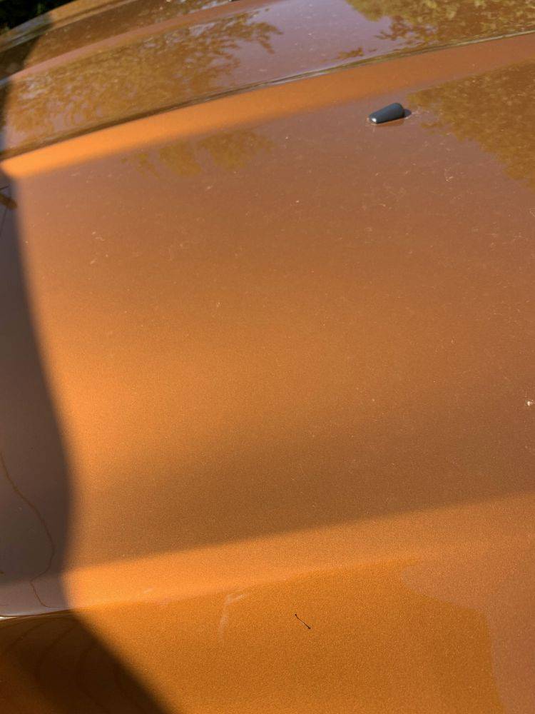

The Kuga is completely dry (and reasonably clean; the spots you see in the upper half of the picture are actually reflections):

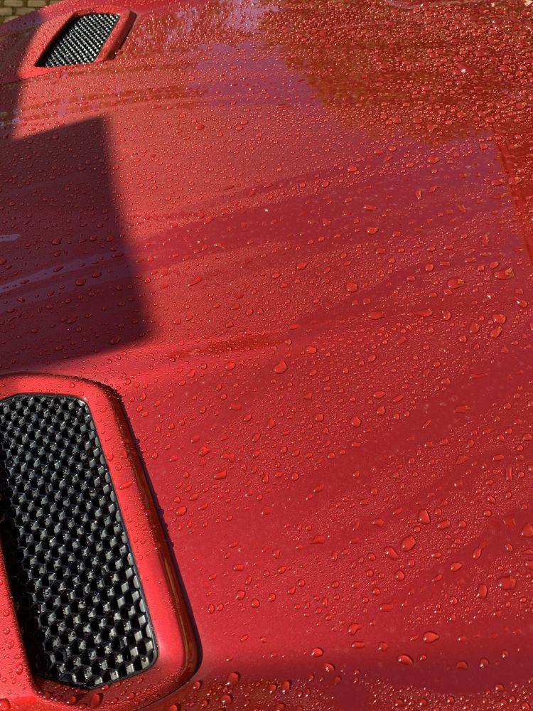

while the Mustang is wet like hell:

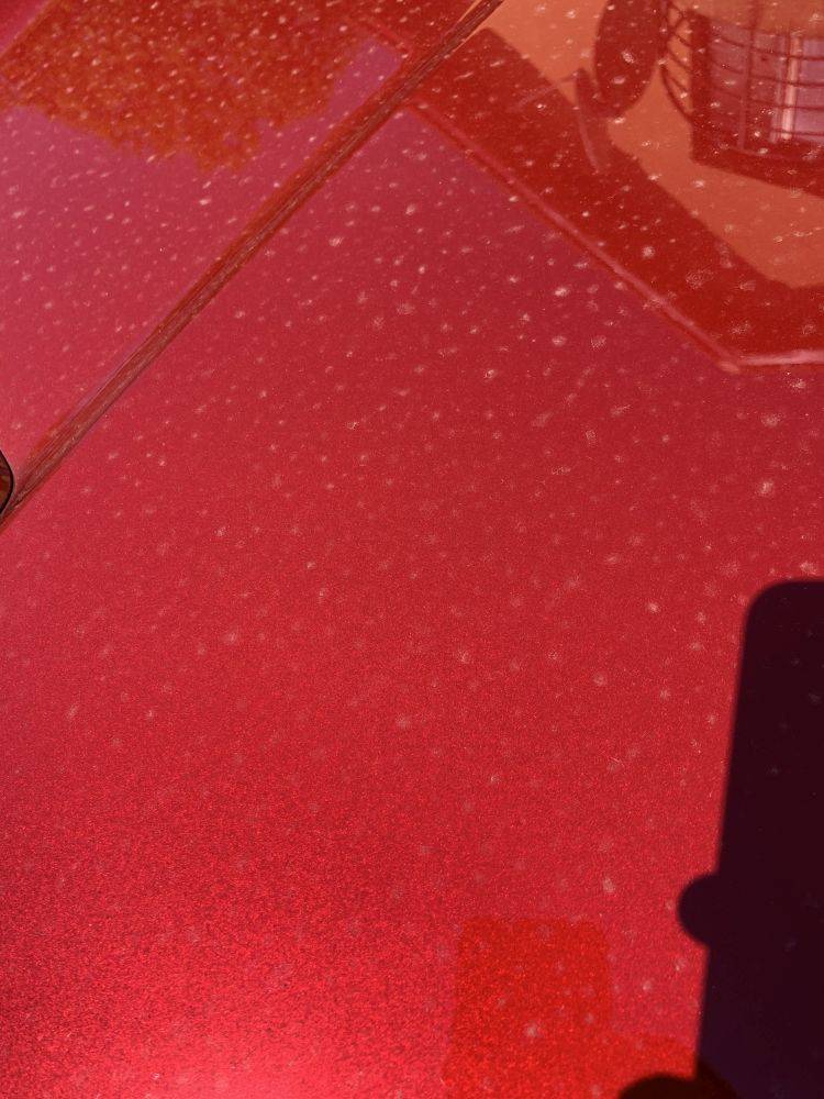

And sure enough, after drying the Mustang looks absolutely hideous:
I washed the Kuga two weeks ago. Weeks! Never touched it since. It still looks perfectly fine, unless you look very closely and critically. I washed the Mustang three days ago, and it's already looking like crap. One very short and light rain over night was enough to do that.

I think paint color between the two has a lot to do with cleanli-looking-ness. As for retaining water,i have no answer

The spots are from minerals left behind when the water evaporates (hard water). I make a lot of RO water (like distilled) for my aquariums so I've been doing a final rinse with that. Alternatively you can find a way to remove the water before it dries (towels, chamois, leaf blower...)

Beading, a side effect of having a hydrophobic layer on top of your clearcoat, can be used as a measurement of protection. That layer provides UV protection, and keeps oxidation at bay. Back before I started using a spray sealer as a drying aide, I would gauge the protection by how much beading I have. When the water started sheeting, it was time for another wax job.
The price I pay is water spots when the car gets rained on. For me, the trade-off is a no-brainer, as my 2015 red truck sits outside 24/7. That paint would be trashed by now if I didn't keep something on it. Instead, it looks brand new. But it does get to looking really nasty after it's sat through a few thunderstorms. Thankfully, my 'me time' is getting out in the driveway and rectifying that.
A compromise for you may be one of those 'waxes' that sheets water, instead of beading it. I can't recall the names, because I've never used one, but it may be an alternative if you want protection, but don't want to fight the spots. Whatever you decide, I highly recommend keeping SOMETHING on that paint if those vehicles sit outside. Red turns pink when it fades.

Ceramic coatings suck for just this reason. Use a real wax and the water spot problem is gone.
I used that meguires creamic and it water spotted so bad I had to use a DA and rubbing compound to get rid of them.
Lots of work but it did get rid of my swirl marks.
Every time it rained or water hit the car, spot city.

Rain water IS distilled so it's completely free of minerals. HOWEVER comma, unless you live at the North or South Poles, there will always be some amount of contaminants in the air itself and the rain drops pick it up.
As the OP stated, "waxing" or "coating" a vehicle will give it hydrophobic properties which are desired for both washing and drying.
Nonetheless, I would suspect that there is only one way to avoid the rain spots and that is to rinse and blow dry the vehicle after a rain. But for those who are DD's and have to park at their workplace, there's no way around the spotting that I can see. Driving at a decent clip after the rain STOPS would reduce the spotting but not eliminate it.

Blow your car off with a leaf blower
+1 on the leaf blower. This is where the hydrophobic nature of ceramics come in real handy. That water will fly right off. This is what I do on the rare occasion I get rain on it. Try not to wipe off a dirty car.

Forgot to add, if you don't have time to dry the car, a trick you can do to limit the spotting is to run a garden hose on the flat parts of the car. The technique is called sheeting. Do the roof, hood, rear, the problem areas where water likes to sit. Without a spray nozzle, just an open ended garden hose (careful with the metal ones) allow the water to create a sheet and it basically pulls itself off as it moves. Start at the top and work down.
