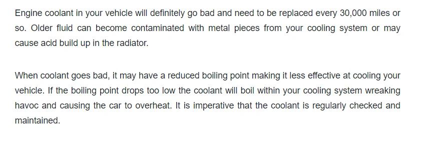

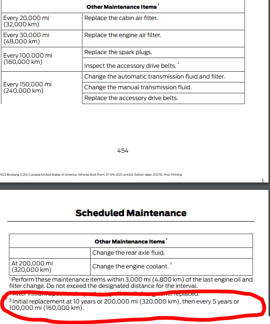

Simple fact that coolant degrades overtime and the seals degrade as well. Its cheap insurance a $100 water pump is nothing compared to the cost of engine damage from overheating.
Straight from Ford every 10 years or 200K miles, he is almost at 10 years. Age of coolant matters.

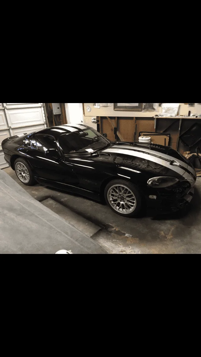

…. And my 1997 kubota tractor still has it’s original radiator hoses in perfect condition.. and same for my 2000 Viper
I had an 1995 explorer with 300.000 miles and 25 years old on original hoses….
I believe in preventive maintenance but no reason to replace a perfectly good part…
