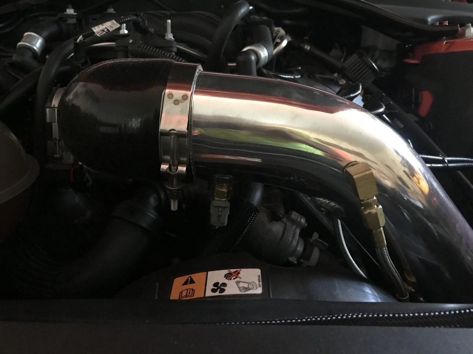

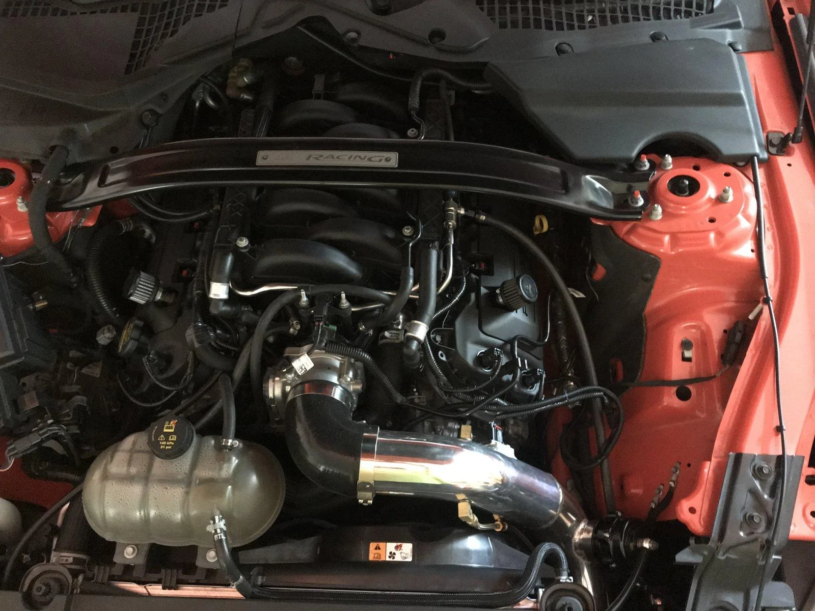

I have my nozzle just after the intercooler which is about 20" before the throttle body. I used an IAT breakout harness and moved the IAT sensor about 12" before the throttle body. The idea was to let the IAT sensor see the actual air charge temperature post methanol nozzle. So far it works very well.

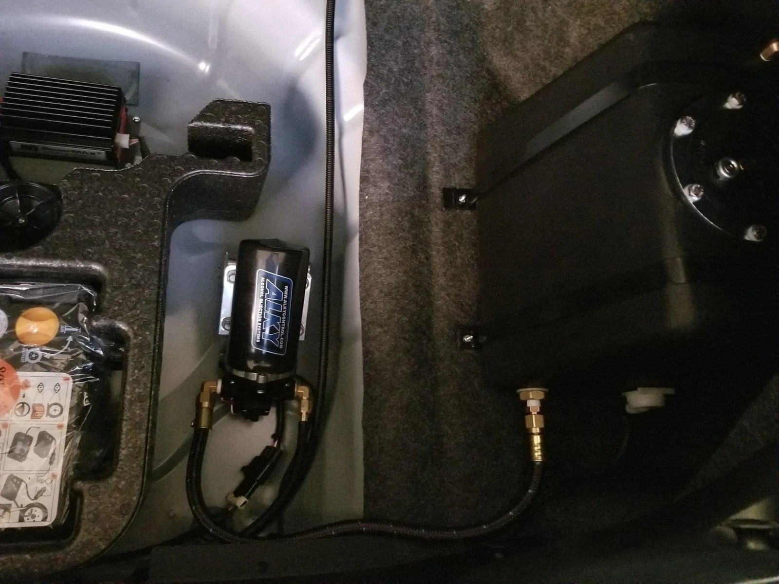

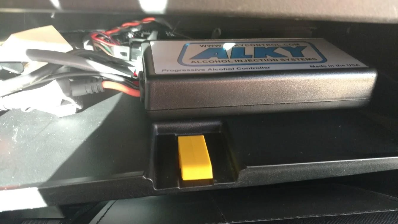

No hobbs switch. I'm running the Alky Control kit that is triggered and progressively controlled via a MAP sensor. It's kind of a tedious install, but a very well built and designed system.

I run an Alky Control system as well. my meth is injected about 10" before the TB and my remote IAT is about 4" before the TB. I run 100% meth but that doesnt affect a discussion about where to mount it all!!:crackup:
