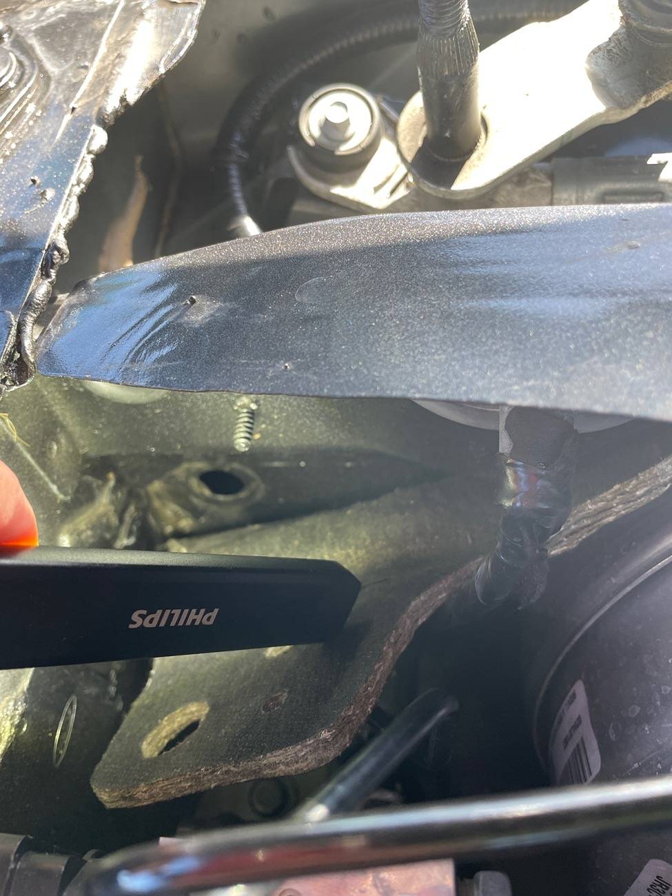

Have a 2019 GT and found the above problem! Once I started searching, it was clearly a well documented fault!

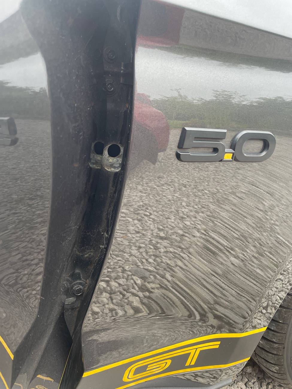

I replaced the 'cloth/tape' type covers over the hole in the A post with a rubber grommet epoxy resined in (and did the passenger side).

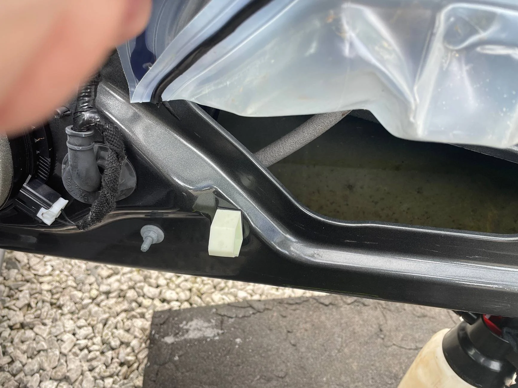

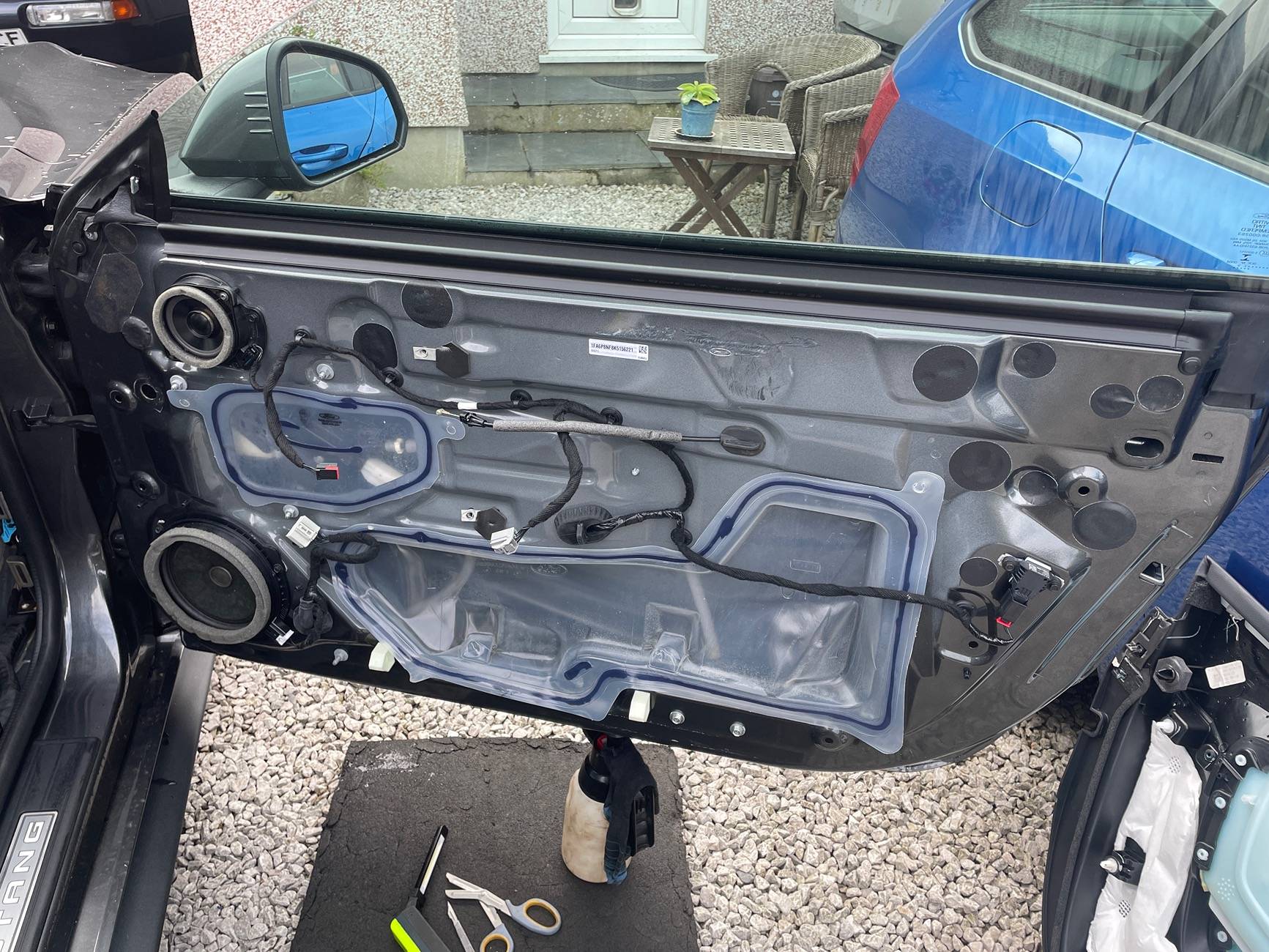

Then noticed water coming in between the bottom of the door card and door frame, so door cards removed and the plastic film was found to be, well not very well stuck! All film is now Tiger sealed back on!
But, water was still getting in somewhere...
This is the bit I hadn't seen documented and therefore it's about time I put something back in to help! I think it's the same fault that some have had dashes etc removed by Ford to repair!

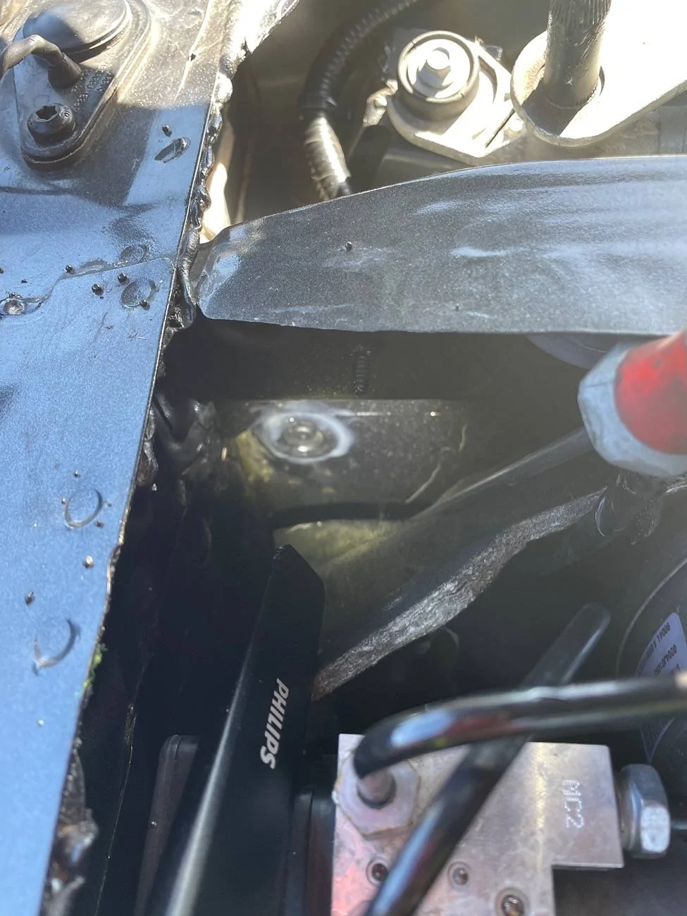

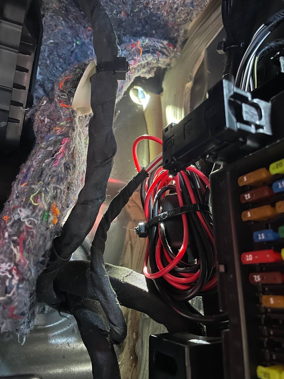

There is a grommet high up above the accelerator pedal that needed sorting. It's accessable from the engine bay by removing the wiper arms, scuttle panel and then peeling back the sound insulation...
The seam sealant was stopping it properly seat. Removed it and trimmed the sealant back, then epoxy resined the grommet back in. It's sat outside in the fine Bristish summer for a fortnight and remains dry...success!
Few photos and thanks to all that have helped me!

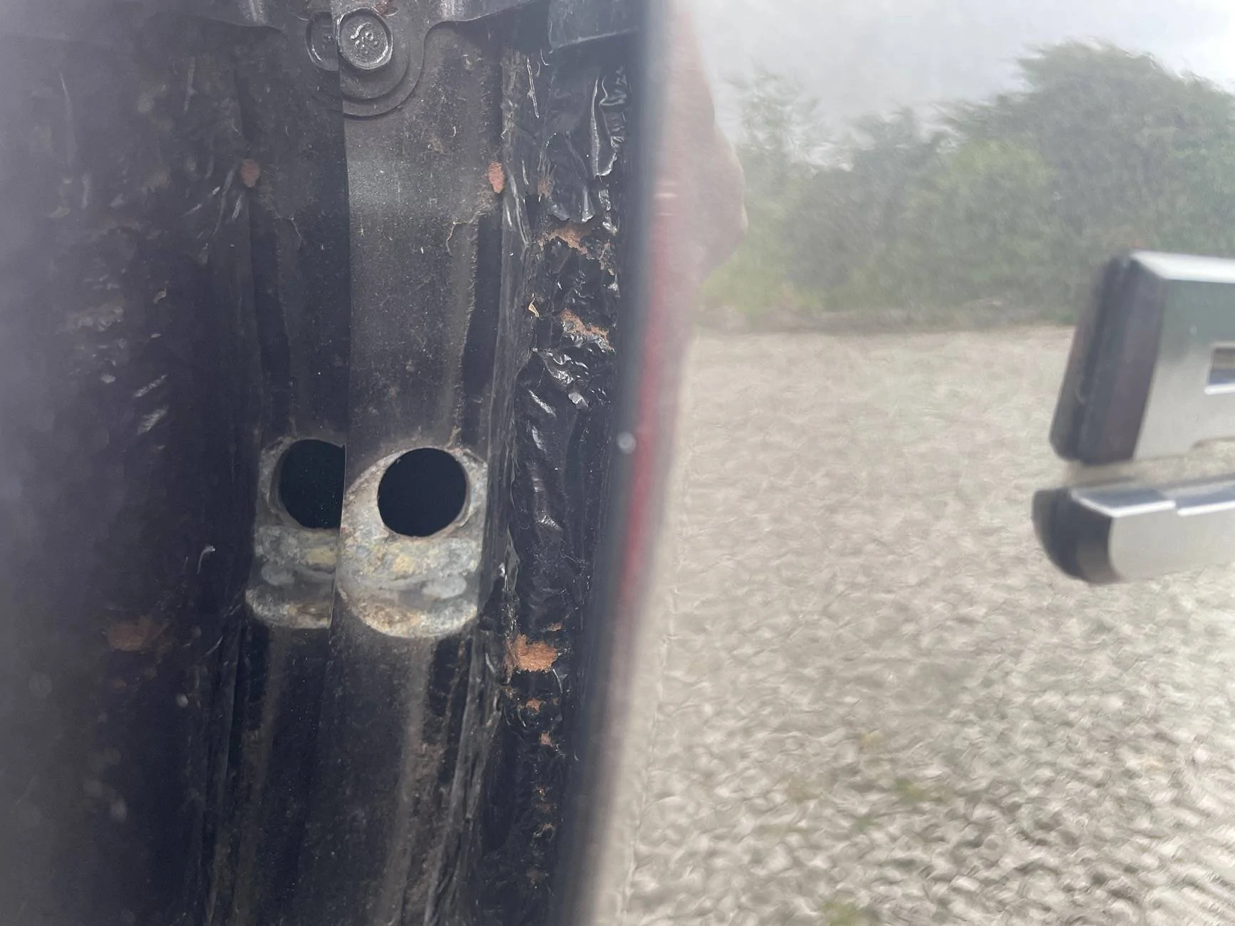

There are also large holes covered by stickers that are painted over on the body where the door hinges are, I found one on the ground and searched where it came from. I fitted grommets to fill them properly but others have had water ingress from there too

The grommet up top was a common issue in 2017 mustangs. Mine had it, Ford sorted under warranty. Not had any other issues as of yet but car is now always parked under shelter, washed like twice a year and never driven in the rain.

That was me that had the whole interior out, and wiring loom replaced under warranty. Great to have the photos as a reference, I've always been 99.9% sure that my issue was sorted, but having extra bits to check is always a good thing

Be interesting what state the speakers are in! Noticed that the backs of them and I think the window motors are behind the waterproof membrane...
Thats common. There should be no issues. I just want to upgrade mine. That's all.

Where are these holes in the firewall? Looks like to the outside of the brake booster? Trying to look at the mirror image since mine is a LHD.
