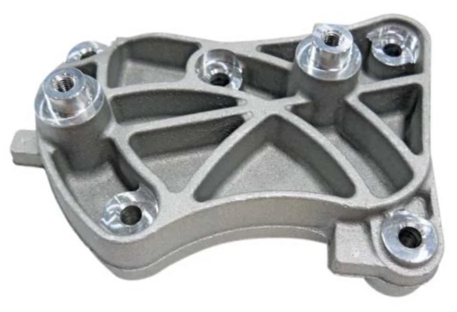

I called VMP and theres good news and bad news. The good news is they are shipping me the phenolic spacers. The bad news is there is no upper FEAD bracket available for using the spacers for the 18+.
The current FEAD bracket is made of cast aluminum. Cast aluminum doesn't weld very good. There is up to 25% of other metals in the alloy that act as contaminants. Not many welders will attempt to weld cast aluminum. It can be done but there are no guarantees. I work for GE Aviation as a machinist. I spoke to one of the best welders there and he wouldn't trust the outcome. He then suggested brazing the cast aluminum. He said he's had better success at brazing cast aluminum than welding it. After adding more material to the 2 lower hole bosses I can drill and spotface new holes. Option 2. I'm not too thrilled about is slotting the holes 5/32 up on the upper holes and down 5/32 on the lower holes, then spotfacing. The spotfaces will most likely go through the webbing and weaken the part. Option 3. Make a billet FEAD bracket. I'm not thrilled about this option either. I don't have any cnc machines available for me to do this, all manual. It will take a long time for me to do it on manual machines.
I would love to try the spacers. I know a few people with 5 axis cnc mills. I would imagine there is intellectual property on this bracket.
Roush may allow a redesign. This could be sold as a kit as long as there was solid data to back up the mod.
I know the dodge and Chevy guys have already been doing this.
