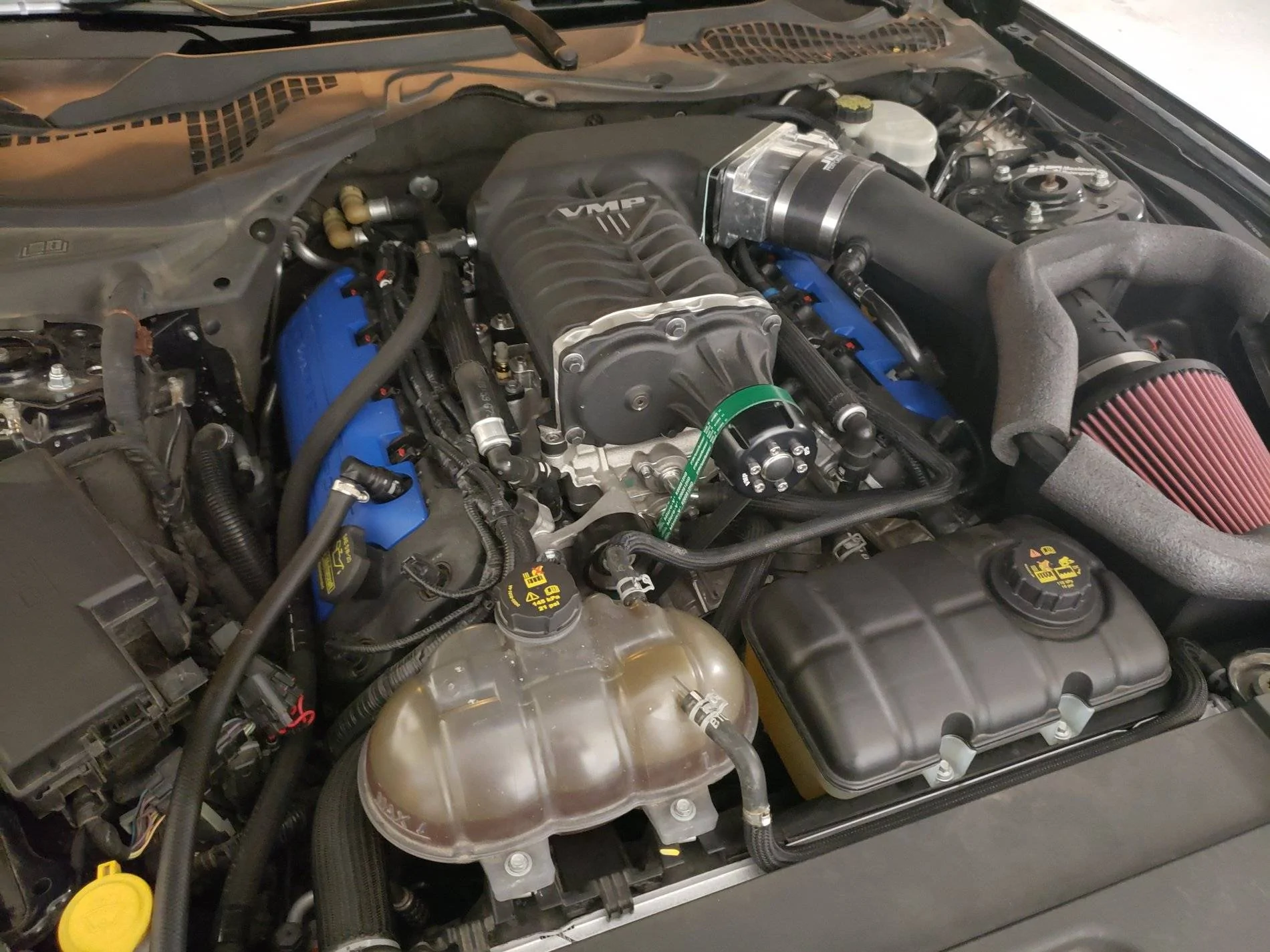

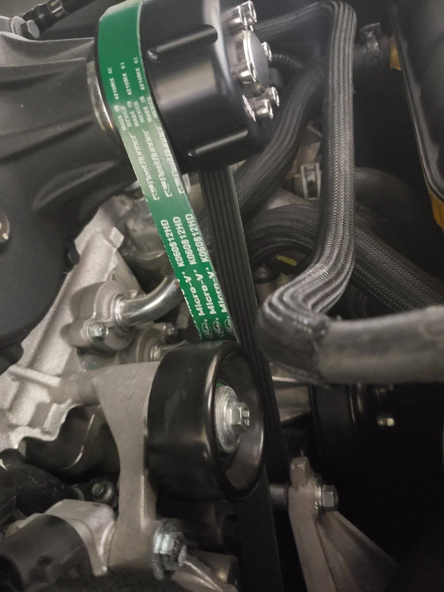

Belts I've used that work is K060815 for 92mm, 88mm, 85mm pulleys. Swapped to K060812HD using 85mm 6 rib pulley and stock idler and crank pulley. Could not find any info on anyone else trying it. If anyone else has any info for Gen3 or Gen3R and what combo such as rib, idler, crank size please post to confirm what works, thanks.

Still using the K060812HD, can use the K060815 or K060815RPM. What fuel are you using for the 82mm
