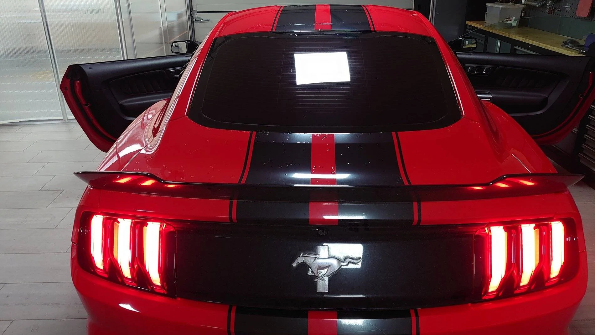

Hey, i just installed these Vland taillights, for my USA imported V6, and for some reason the only working lights are the running lights from starting the car/accessory mode, braking goes sequential.
Does anyone have an idea as to why this may be? I tried asking Vland but that wasn't very helpful :/.

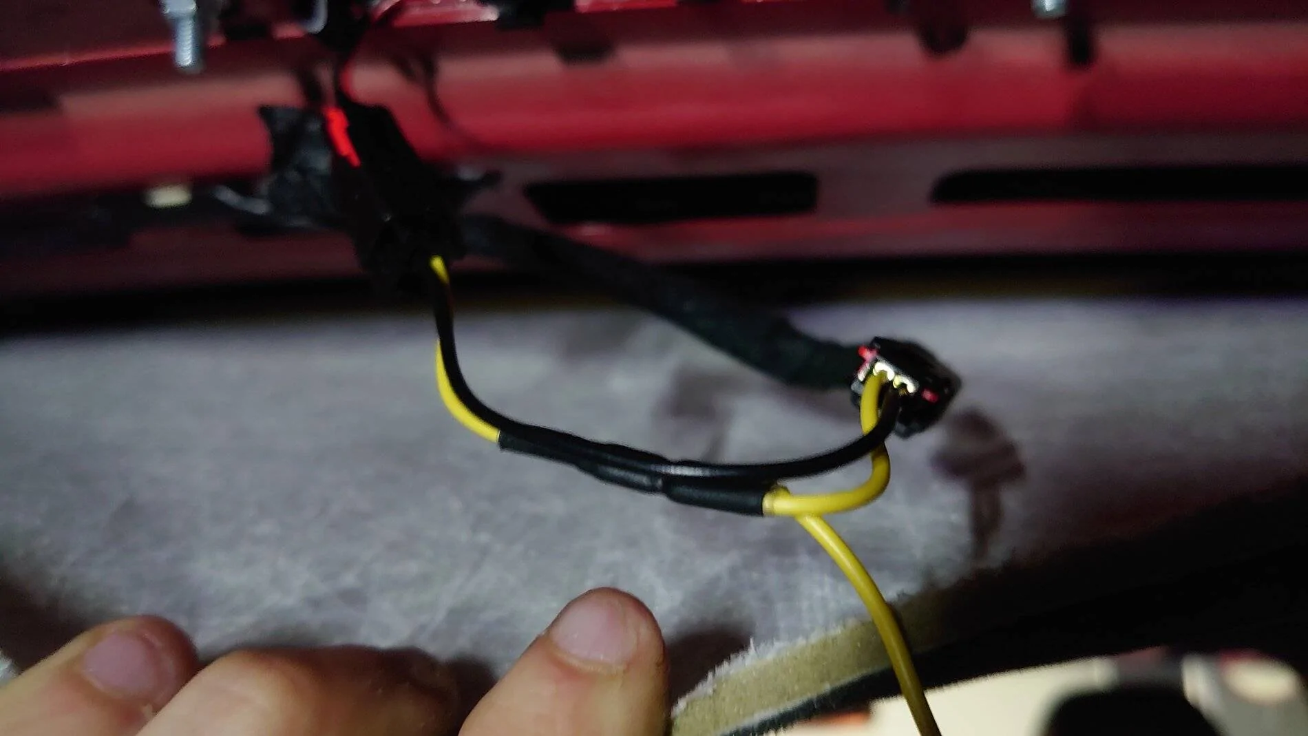

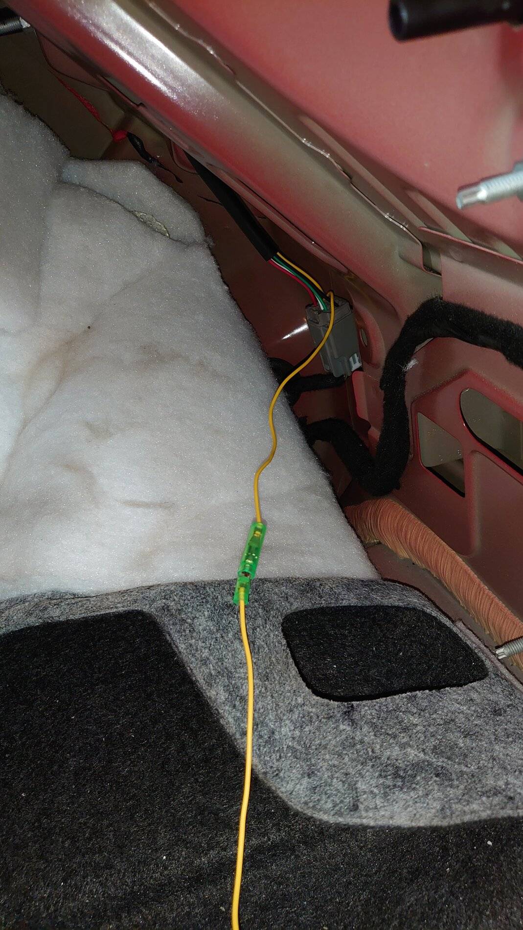

Did you connect the yellow wire between the two lights? Also can you send a photo?
first image is connection to the 3rd brake light, connected properly, second is the yellow cable connected to the taillight left, same on the right.
Thanks! I'm not sure what is going on but braking going to sequential makes me think it is a wiring issue. The green connection on my car is on the right hand side (passenger) and I believe my third brake light looks similar. I would suggest unplugging both lights and then plugging everything back in. You could also unplug the third brake light and see what happens with just the two lights connected.
Side question, you didn't use the EU adapters that came in the box right? The US should be using what you got and not using the additional EU pieces if you have a USDM spec car.
