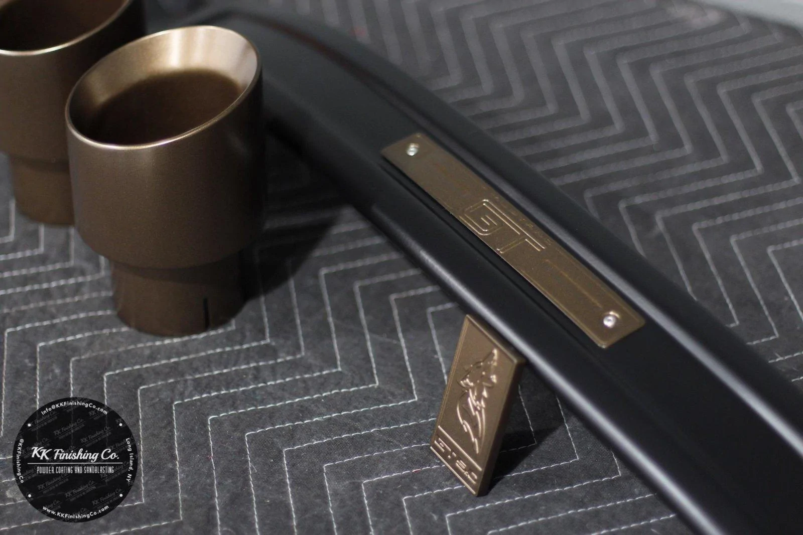

How much did that cost you for all that?
A tad over $200. $300 if you include the extra tips i bought for it. Not bad since it was very good quality work. And the strut tower badge had to be taken off and reriveted in and new foam placed behind

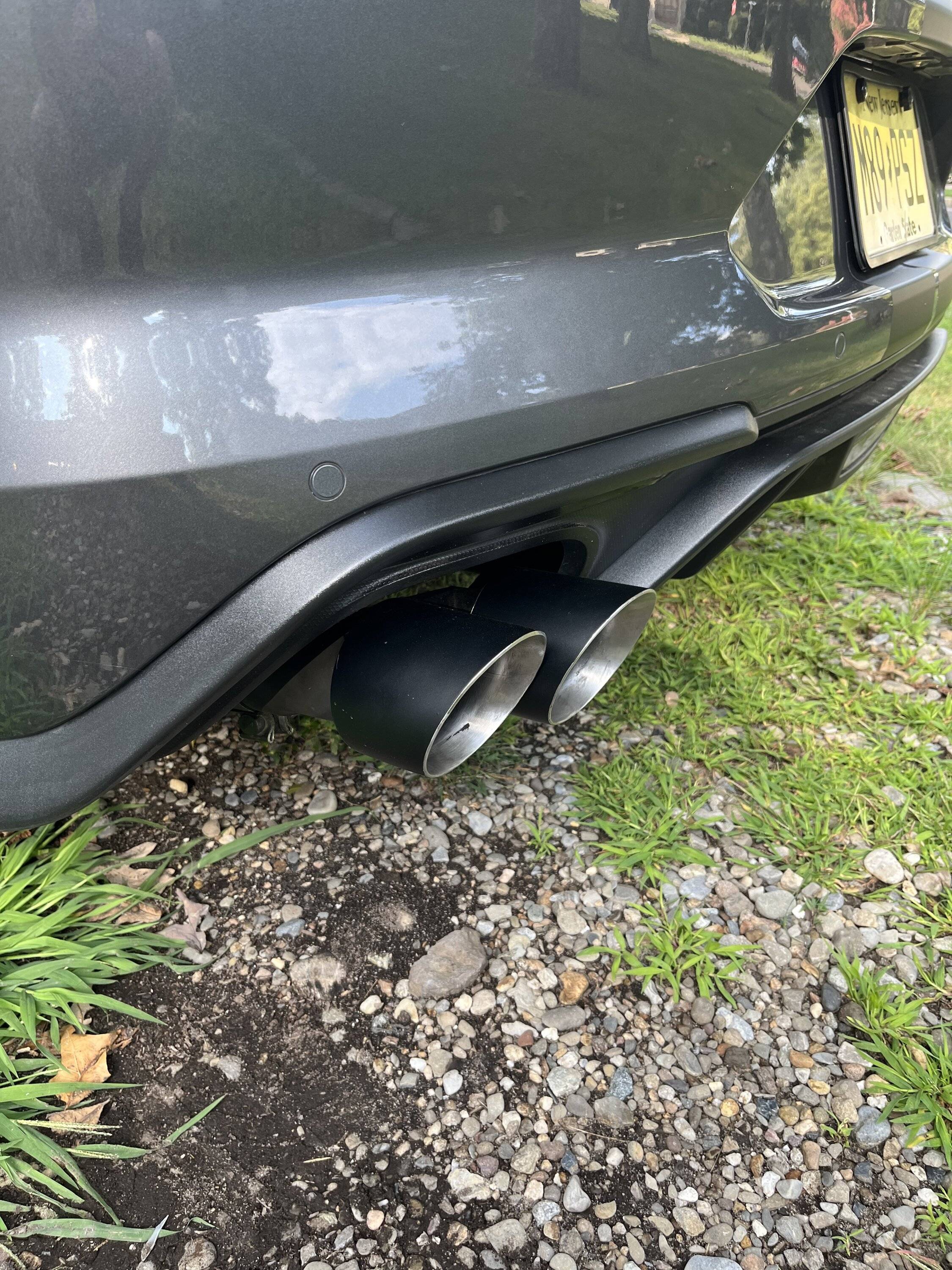

I wrapped mine with vivid matte black… been on the car for 2 months in this summer heat with driving …. No issues … if you post heat cure your wrap before installing on your car you’ll be fine

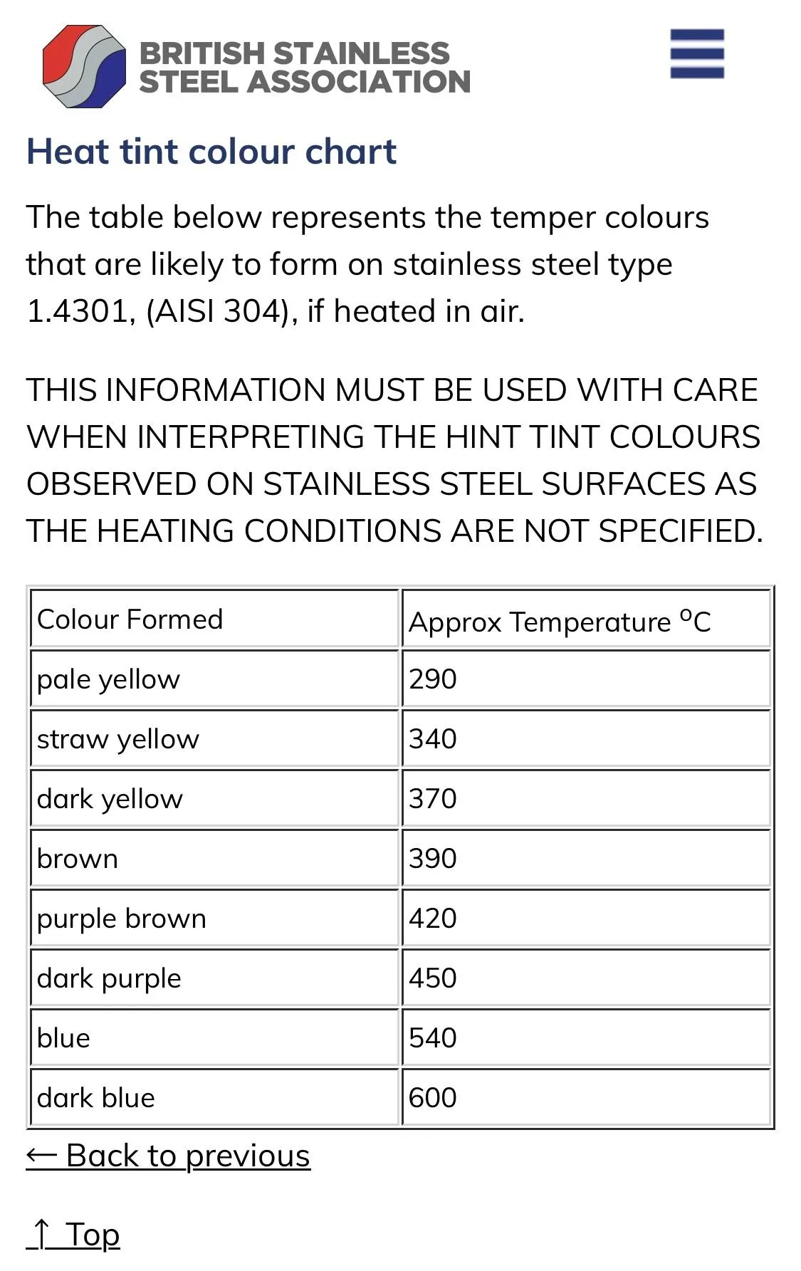

Clearly you need to drive it around for abit and park it and get out and grab the exhaust since you don't know how hot that really gets.
This :like:
OP, I'm almost positive you can buy a $7 can of black plastidip and dip the tips. It should hold up fine since exhaust tips don't get too hot.

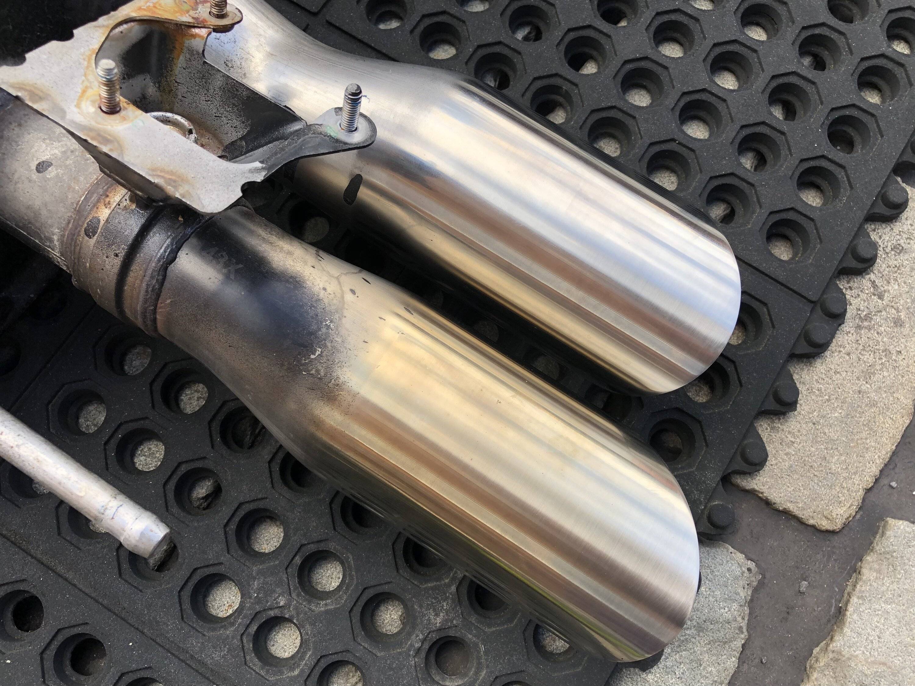

Standard active exhaust, run 95% in track mode, no track work - check out the discolouration on the inner tips :
Then check out this :
Yeah, they get hot … :like:
