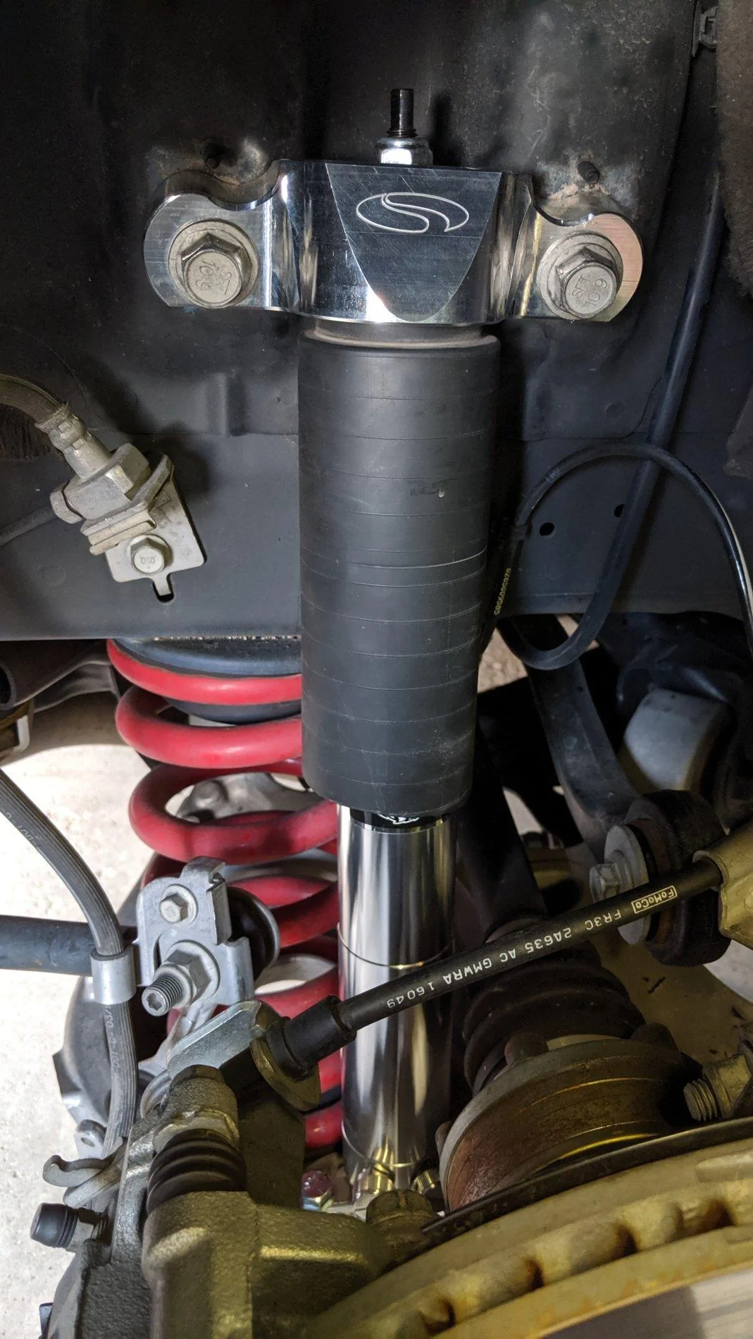

So I talked to Viking today and they said the mounts that came on my shocks are the t bar mounts and they started using those on the newer models because they are stronger than the other mounts. They did say however, that a downfall of using them are that they create much more noise than other mounts. They said people were breaking the stock mounts so they switched to these. I’m just going to continue using them and see what happens. I don’t daily drive the car, just some drag racing here and there. Not too fun daily driving 900whp lol
I just got my crusaders last week, no top mount like that. I used Steeda mounts. No noise at all. Fyi I'm in Cincy also, hit me up when you go out racing.
