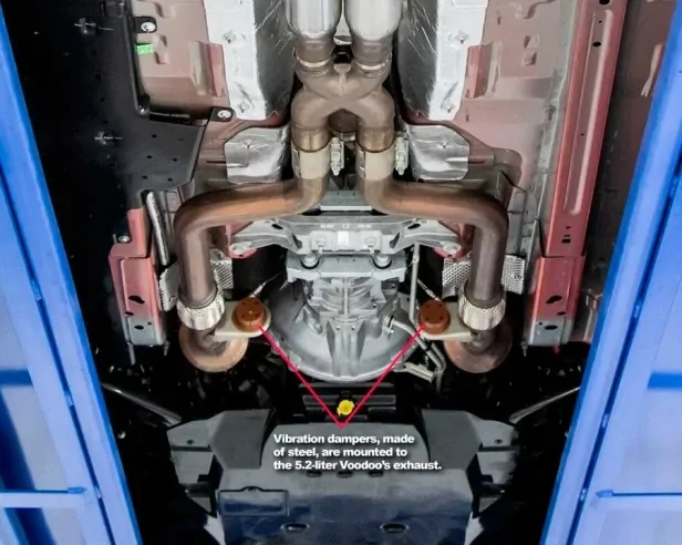

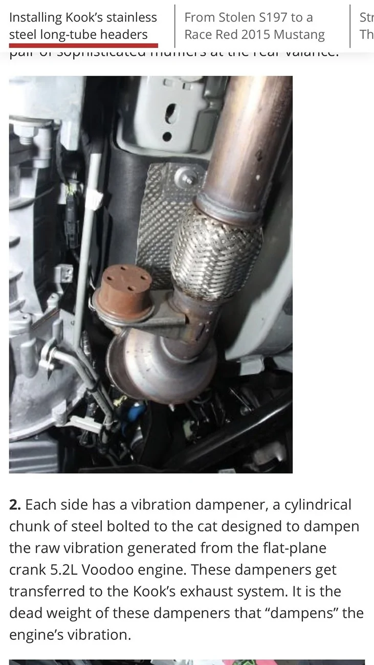

Associated with the Voodoo and the exhaust are two dampers. They are there to lessen the effect of any engine harmonics.
While other ideas are being checked out, it's something else to make a quick look of next time the car is on a lift. There should be one on each side, firmly attached.
Edit,
The differential replacement interests me. Usually it's individual bits like a seal, ring or bearing that's replaced, not an entire assembly.
If it was a dealer and you know the one that replaced it, I'd reach out and ask for a reading of the invoice for the customer, Service Advisor and mechanic comments. Maybe it'll make you think, "Hmm...". Or it might give confidence this is a new and unrelated problem.
