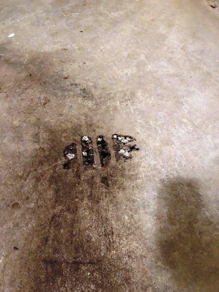

My car has been at the dealership all day, and will be there till tomorrow.
I got home and walked through the garage. In doing so I noticed my front right tyre basically melted and left tyre marks on the garage floor.

Tyre tread from my garage...
usgiorgi
Jun 22, 2016
727
170
Fairfax, va
C6 Z06
I don't think that's the tire being melted. Looks more like there was some tar on it. It takes quite a bit of heat to actually melt a tire to liquid form. Look on the bottom of the tire and see if there's a corresponding flat spot.
