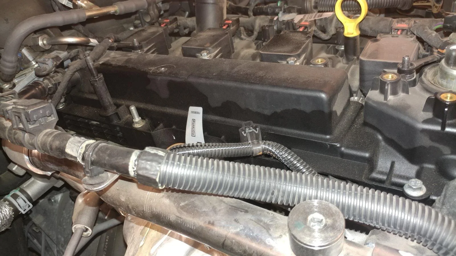

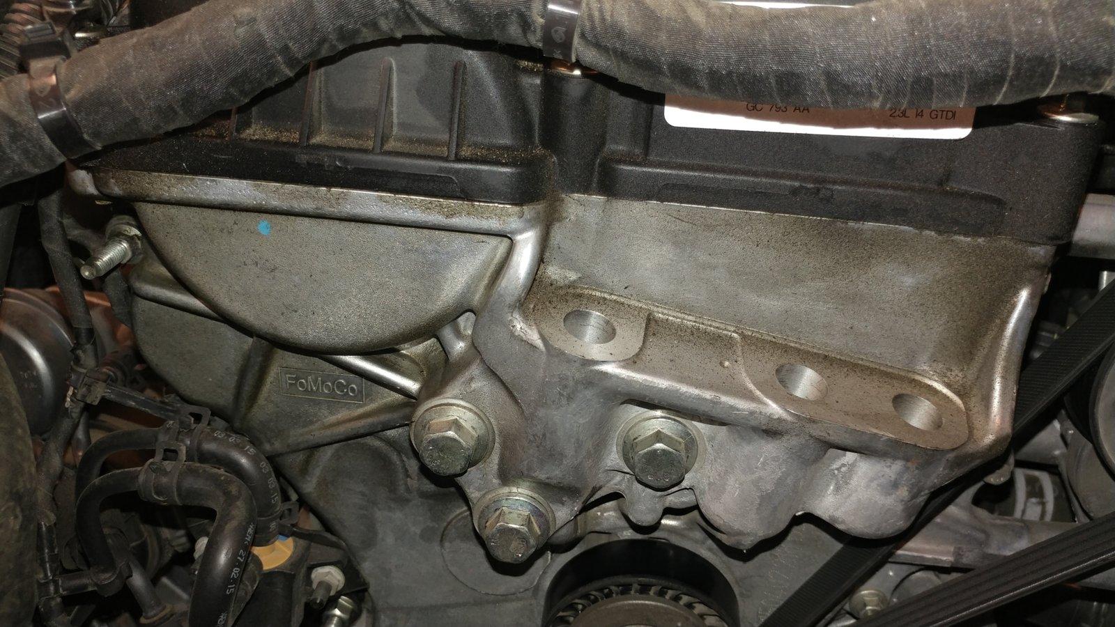

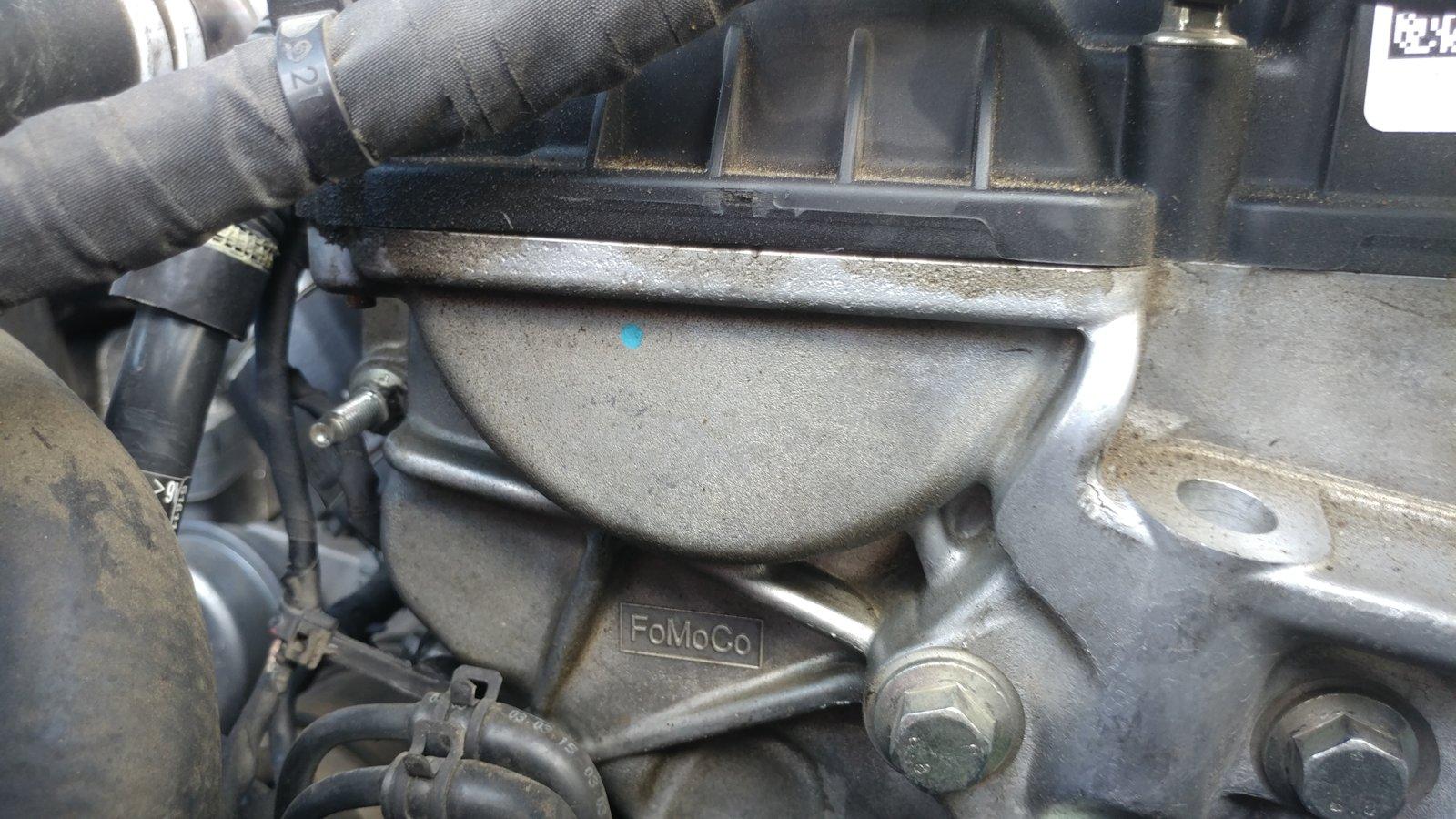

Can you show photo of area?
Its not pouring oil out of it yet, but it is not sealed correctly. There are a few other spots where the oil is much more obviously wet and new, but I couldnt cram my phone in there to get a good pic
