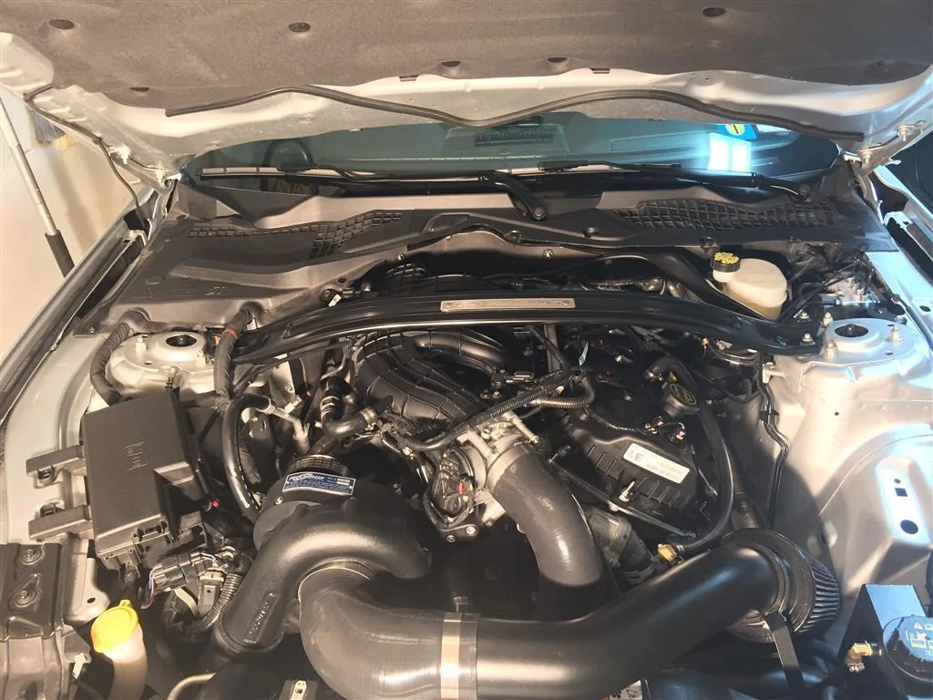

Hey all,
So I impulse bought a GT tower brace for my V6 for a decent Canadian price :headbonk:
Has anyone installed these? I know they apparently don't clear the manifold, but I was talking to other people in my group and they said if I add spacers of sorts it should be fine. Thoughts?

Try some spacers and let me know! Been wondering about this for awhile now. Do you also have the k-member brace that connects both towers to the firewall? If not I would reccomend that one too to see full improvements from the strut tower brace. There is a therad on it somewhere here.

You should do both braces, the k brace to the firewall and the strut brace. If you use both braces you will still need to raise the top brace about 1/4" to clear the intake manifold. I accomplished this with washers but I plan to remove the washers and lower the engine with BMR motor mounts. If you don't use the k brace then you will need to lift the strut brace by probably 1/2"

How confident are you in the washer set up for long term? Large fender washers I assume? I wonder if the Steeda brace will work as well.

I wouldn't use washers long term. Mishimoto makes a permanent spacer for their tower brace in case you don't have the bottom k brace. A lot of people will be just throwing away that spacer and I want to get a hold of one and see if it does the trick.

I have the full K brace/cowl extension. So it'd only be about a 1/4" of washers. Does their spacer come with their strut brace? I could use that on top of my K brace.

Definitely. Its the same upper brace the 20"ers have. Pairs nicely with the Steeda K brace down below. Much tighter feeling steering. Add the Steeda IRS braces and you'll love it. My car's more and more like a go kart.

Found out the Mishimoto spacer is only for one side so forget that idea.

The guy I bought it from only had the tower brace. I have no plans on getting a K brace, hell I had no plans on getting a tower brace in the first place.
Forgive my ignorance, but what kind of washers are you guys using? Or do you just go to a hardware store and buy a bunch of regular 10mm washers and stack them on top of each other?

I asked them if it would work if I bought two. We'll see. Steeda says theirs will not fit bc of the hood. Theres just not enough room. Maybe bc its round unlike the FR one? Mishimotos is round so thats not good.
