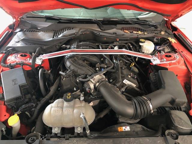

There is a strut tower brace that fits the V6 without lowering the engine or using spacers.

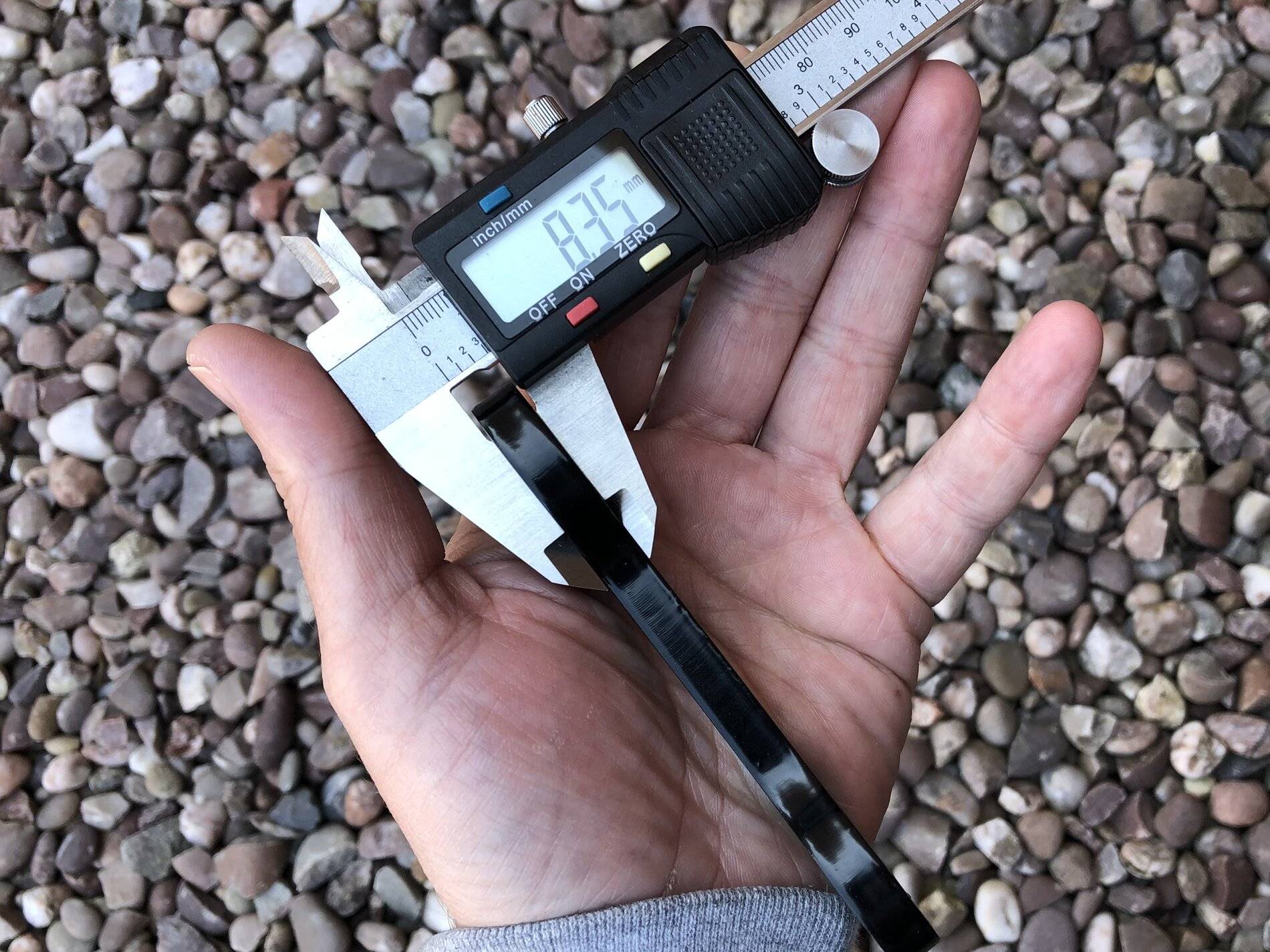

To answer the original question :
Due to the cowl brace design, the Ford Performance strut braces won’t fit a right hand drive car.
Rather than use a modified brace, FP supply the brace with spacers and they are 8mm thick :
Would they give you V6 guys the clearance you need ?

I would also like to know where to get one of those v6 braces N/Angel. 😁
