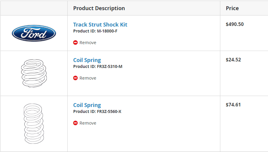

That sounds like a plan - thanks for the input. Looks like I can get the set of GT350R springs and the FP Track kit for a tick over $700 shipped to my door.

Alright, that's weird and annoying at the same time. The screenshot of the cart for Fairway Ford Parts - shows $490 for the M-18000-F strut kit. Went to order them today, the item wouldn't load. Springs still fine. No go on the M-18000-F. Can't bring it up via part number on more than a few Ford online parts dealers right now. Weird.
