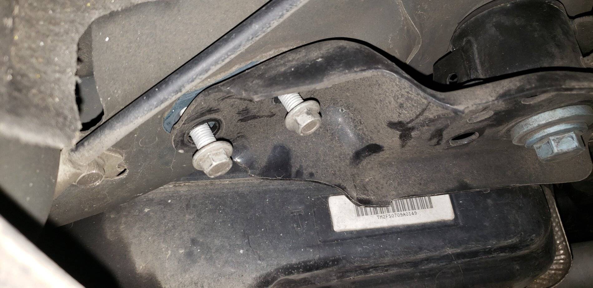

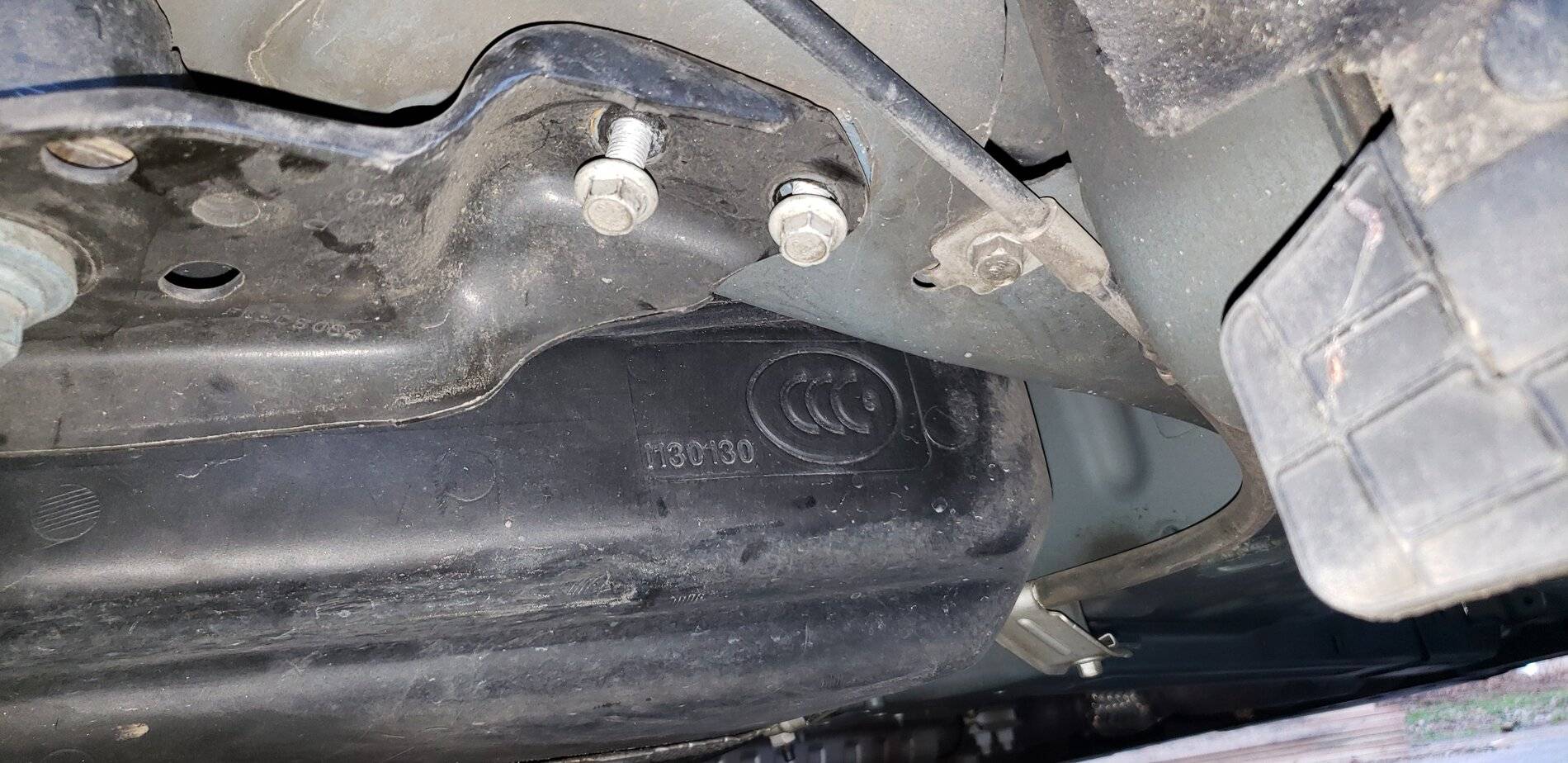

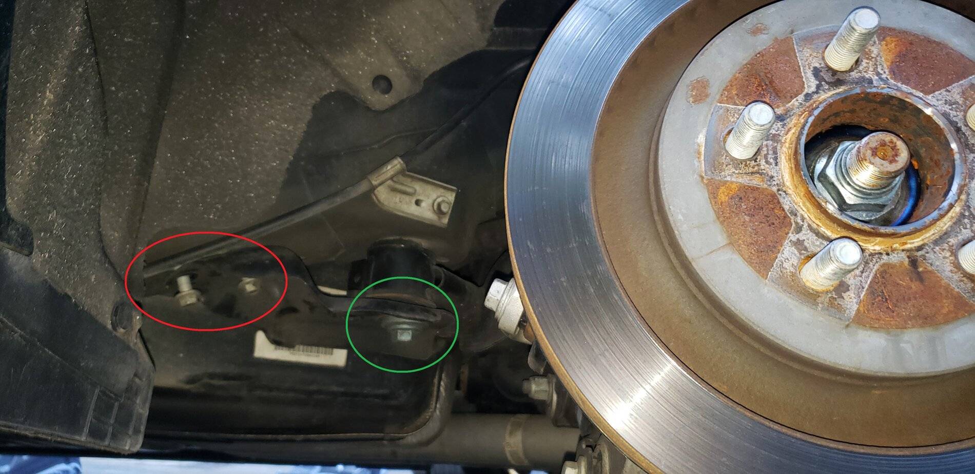

All, I have a '19 Bullitt. It had an evap code, they replaced the sensor, which included them having to completely remove the rear axle, etc. Then it was slightly steering right at straight steering wheel. Brought it back, they said the back was tad out of alignment possibly after the axle being removed, so they realigned it.
Yesterday I swapped my winter wheel/tire set for the stock summer and noticed both of these on each side of the car. They don't seem like they hold the entire axle up, but definitely am questioning this...
Do I need to bring this back in, call the dealer, retighten myself? It's my first RWD and I don't know if that's an alignment bolt or what...
In the one picture that's got red circle (the bolts in question) the weight of the axle and its attachment point is the bolt in green circle, yes?
Thanks everyone!

While you can certainly tighten them yourself, I would either inspect other bolts in the vicinity and/or just bring it back to the dealer to see what else they missed.

I would also make sure those bolts are spec'd as reusable. I bet they are not. I don't have access to my service manual to check right now.

Here's the deal. That plate is just there to put the big - ass subframe bolt in double shear. If the subframe bolt is tight, you're probably fine for light driving, but who knows what they did or didn't tighten?
I should have added, if you DIY instead of returning it, then check every bolt and nut down there to make sure that they are tight.
