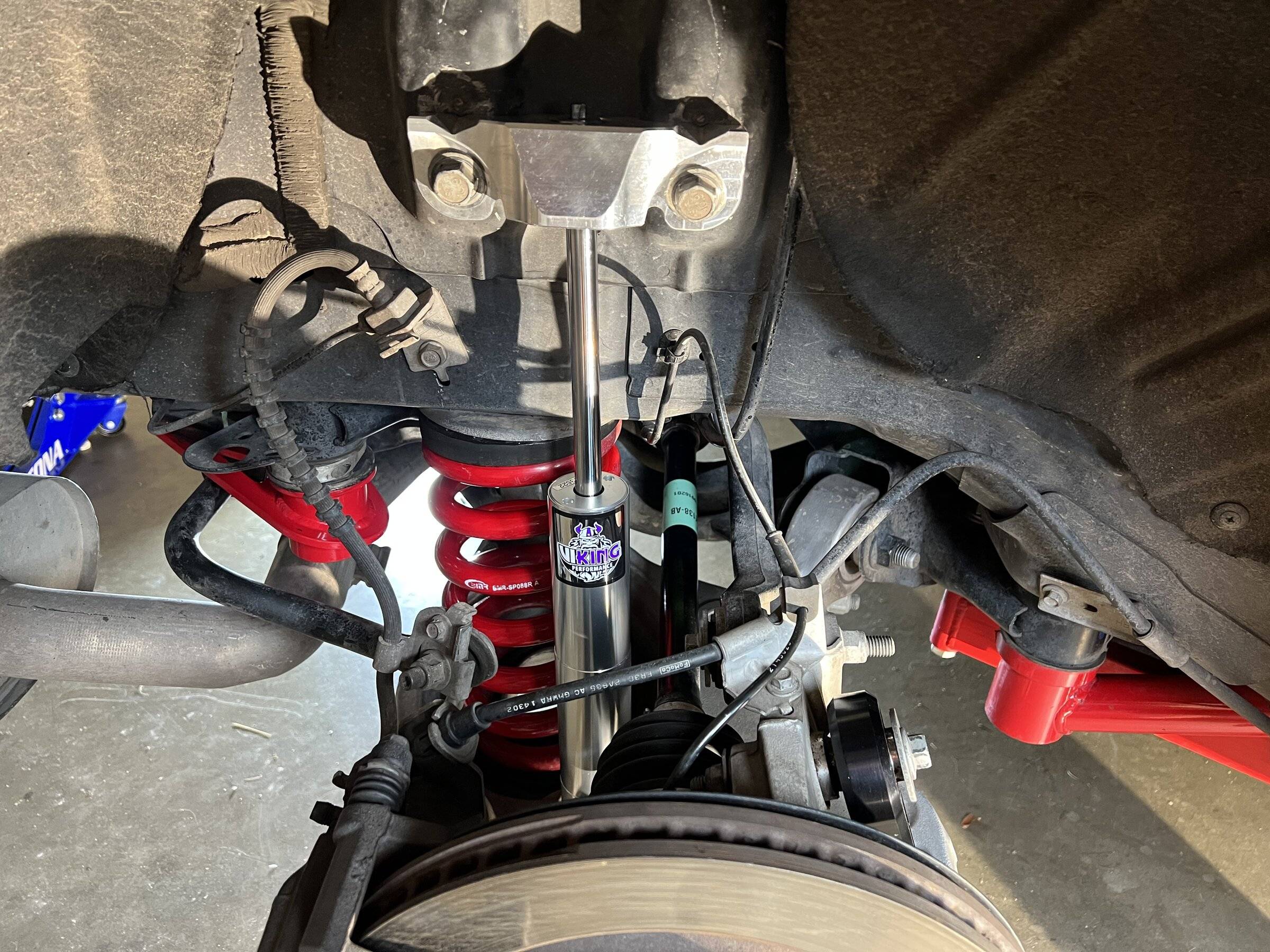

Bought a set of UPR rear shock mounts from a forum member a few months ago. Finally got my Viking Warrior shocks in the mail, and got them installed this week.
There seemed to be a tiny bit of play in the spherical bearing within the actual shock mount. Once I noticed the play, I disassembled and confirmed the play was in the bearing itself.
Now installed, they make a crazy racket over every little bump. Sounds like a midget with a hammer.
Anyone else had this noise develop after putting a bunch of miles on the UPR shock mounts? Is it possible to replace just the bearing?
