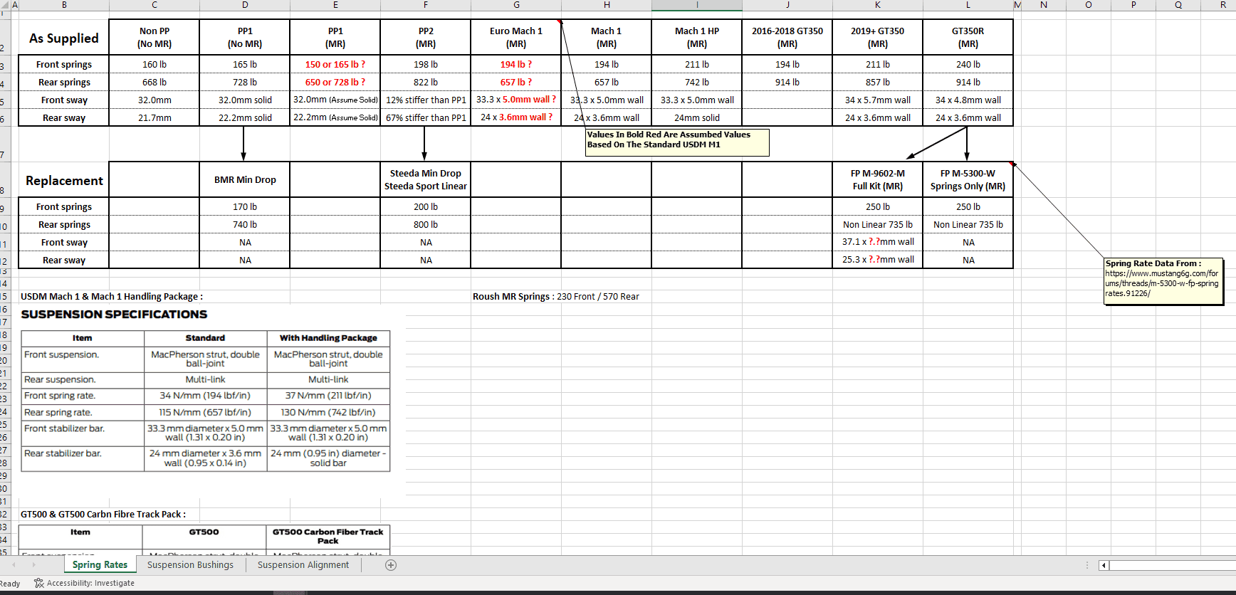

I think that info might have come from a table I was building up.
If it helps, here's the rest of it :
I started to build it up when I got interested in the FP mag ride kit so I could see where it fitted in the pecking order :like:

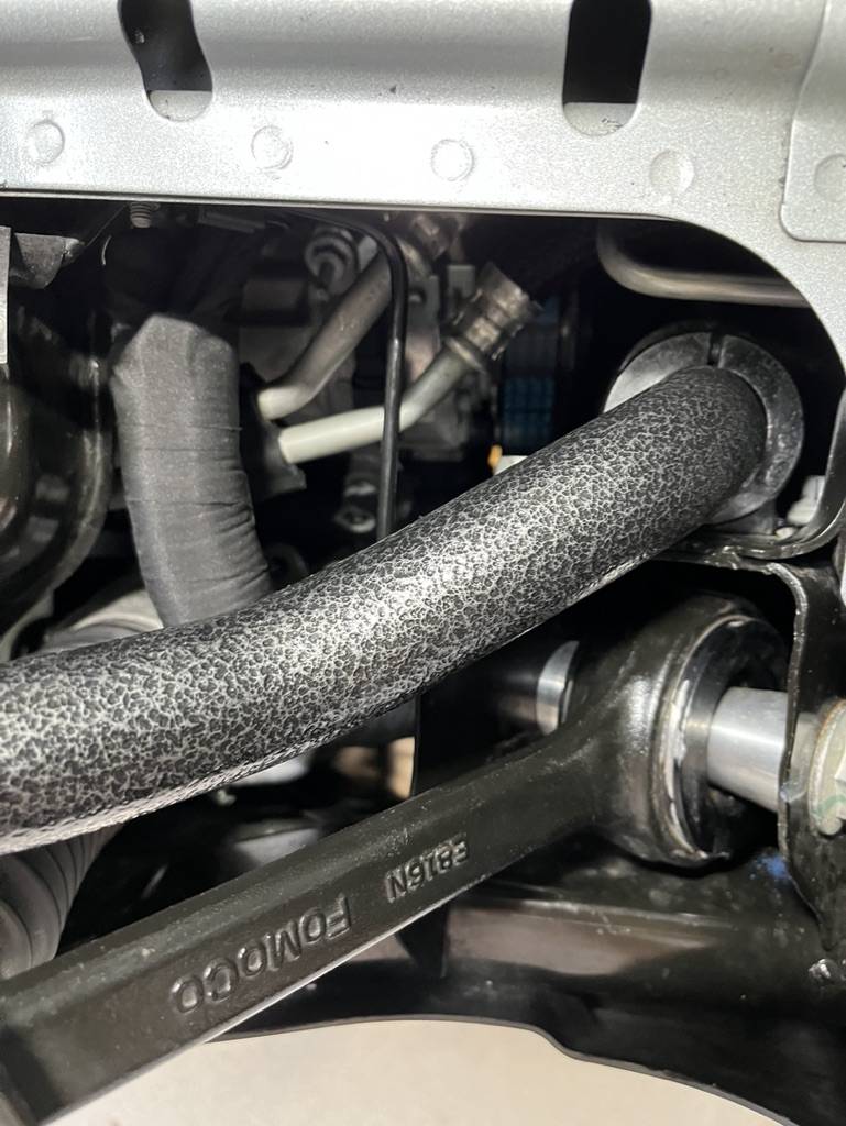

LOL yeah I do feel like it's pretty close to perfect, this will hopefully fix one of the areas that I've always wanted just a little bit more from. The wife and kids were pestering me for Christmas ideas so the bars will fit the bill, better than them guessing and getting crap I don't want.
It will be money better spent than on shoes anyway, she's got that covered... don't tell her I posted this pic, she'll kill me :crackup:
