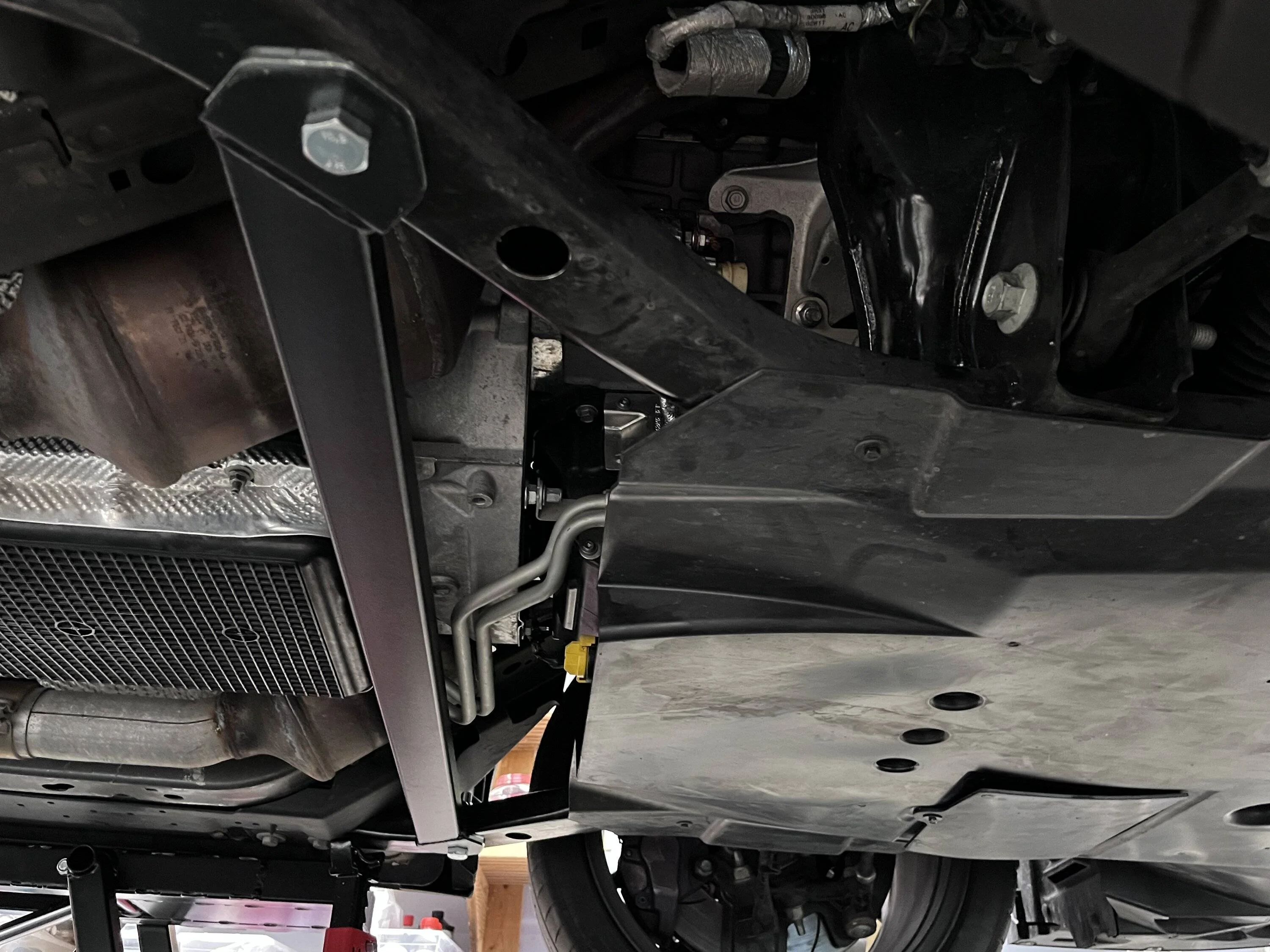

I haven't tried the sway bars but I did put on the Steeda Ultralite 2-Point G-Trac Brace. It did help to stiffen up the front suspension but most noticeably eased off the tramlining when you have the track camber set. Not sure what the difference would be with sway bars or with both of these mounted? So far, I was pretty happy with the handling. Note I also added the rear IRS support braces.
Hopefully not too much of a sidetrack, but could you tell a big difference with the IRS support? I could tell a big difference when I added the BMR lockouts to my PP2. My M1HP is all stock but handles way better than my PP2 did. I've been wondering if the lockouts or support braces would make a difference considering how well it handles already.
The IRS braces does stiffen the rear so you have to be more careful with oversteer. In other words, my back felt less stable than before. But I am sure that with these 2 additions, helped with my better lap times.
