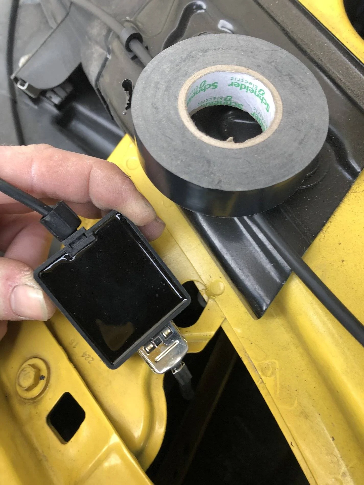

I then found these LED bulbs on Amazon that connect straight onto the standard 25W ballast, i thought i would give them a try.
https://www.amazon.co.uk/gp/product/B08LYYYH15/ref=ppx_yo_dt_b_asin_title_o01_s00?ie=UTF8&psc=1

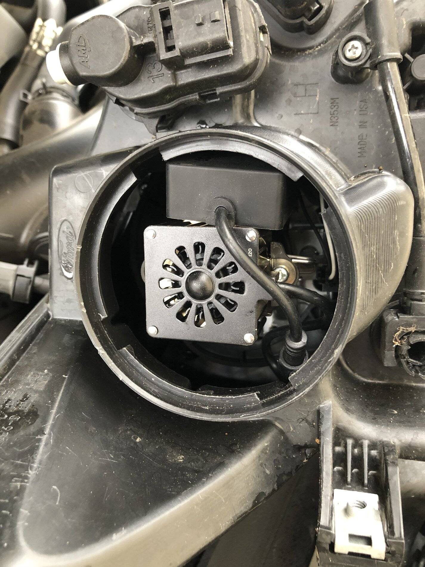

A few pics of the installation, after doing the driver side through the ridiculously tiny access hole which was a total ball ache!, I removed the bumper and headlight for the passenger side, and would recommend this, as its much easier.
The kit that arrived was a D3S kit, which the ballast connector is slightly different to the D8S, however with a bit of force it does fit, and tight enough it never going to come loose! You can see here how small the LED driver is here, so it fits inside the headlight cluster.
You can see here, there is just room for the LED driver to slot in!

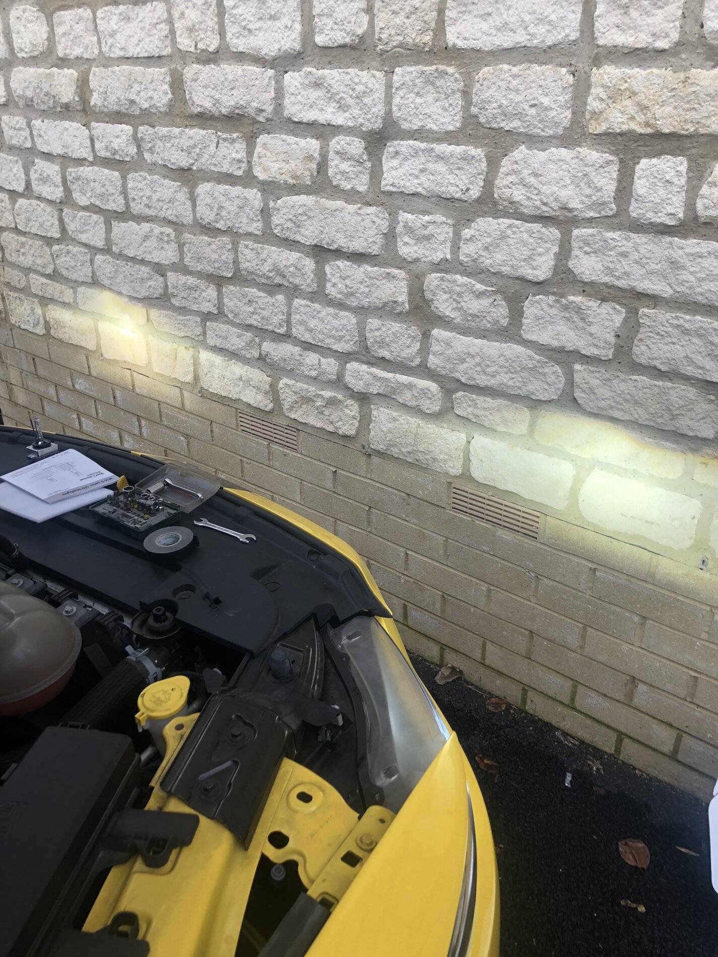

The R/H side is LED, L/H is stock:
I don't know how they compare to 35W HID's, but they are considerably brighter, so happy with them, and they keep everything looking stock.
