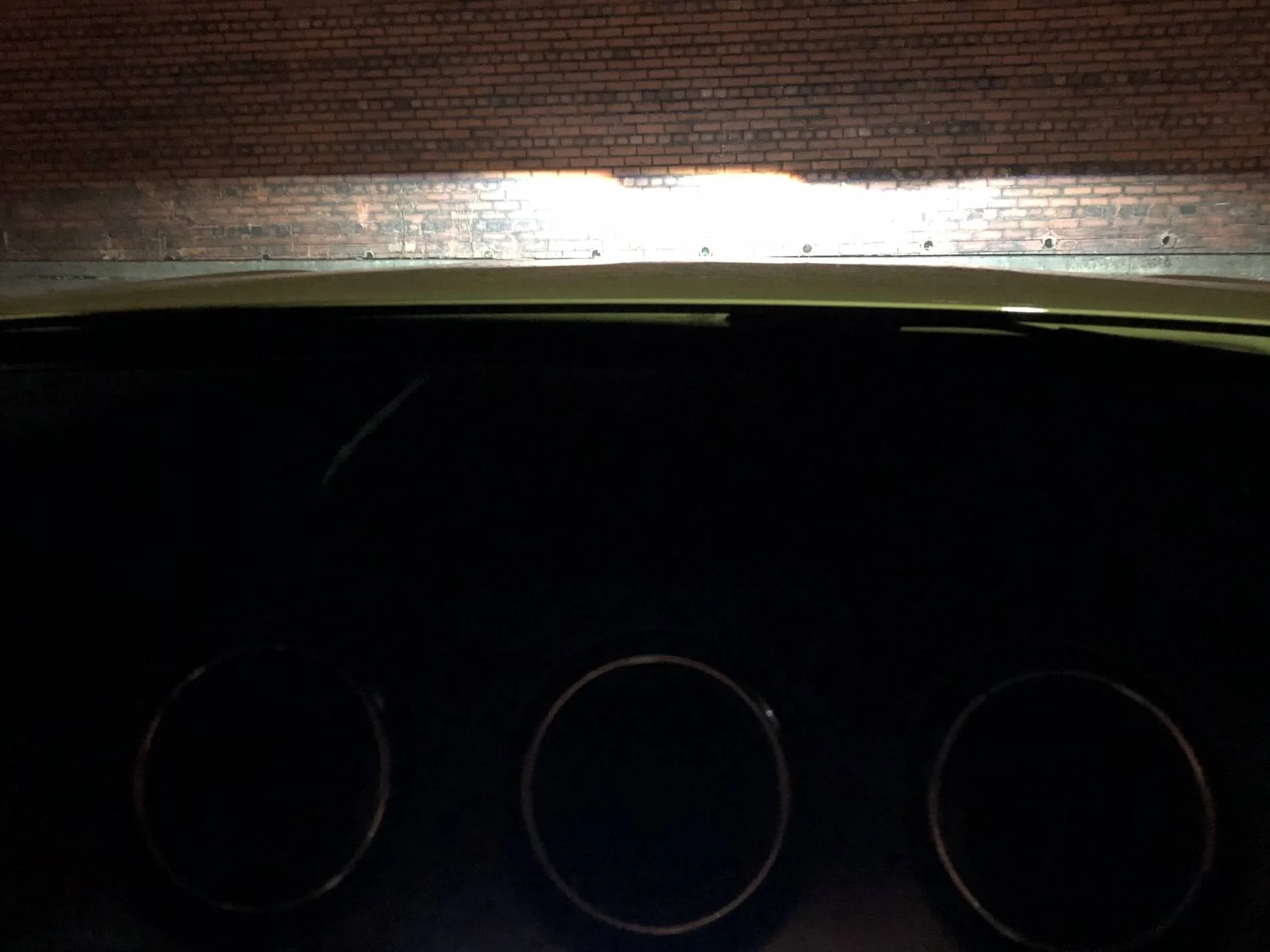

I don't know about RHD, but my LHD headlights project the exact same pattern as any other LHD car I've ever seen. The step-up going from left to right is very noticeable, as is the shape of the light patch on the road (it's obvious that it's longer on the right hand side of the road).
Of course, in your case it would be reversed - step-up from right to left, and the light patch longer on the left hand side.

Picture speaks a thousand words, here’s my RHD U.K. spec 2020 :
That’s from quite close up, maybe two car lengths (absolute max) - the further away you are the more obvious it becomes :like:
