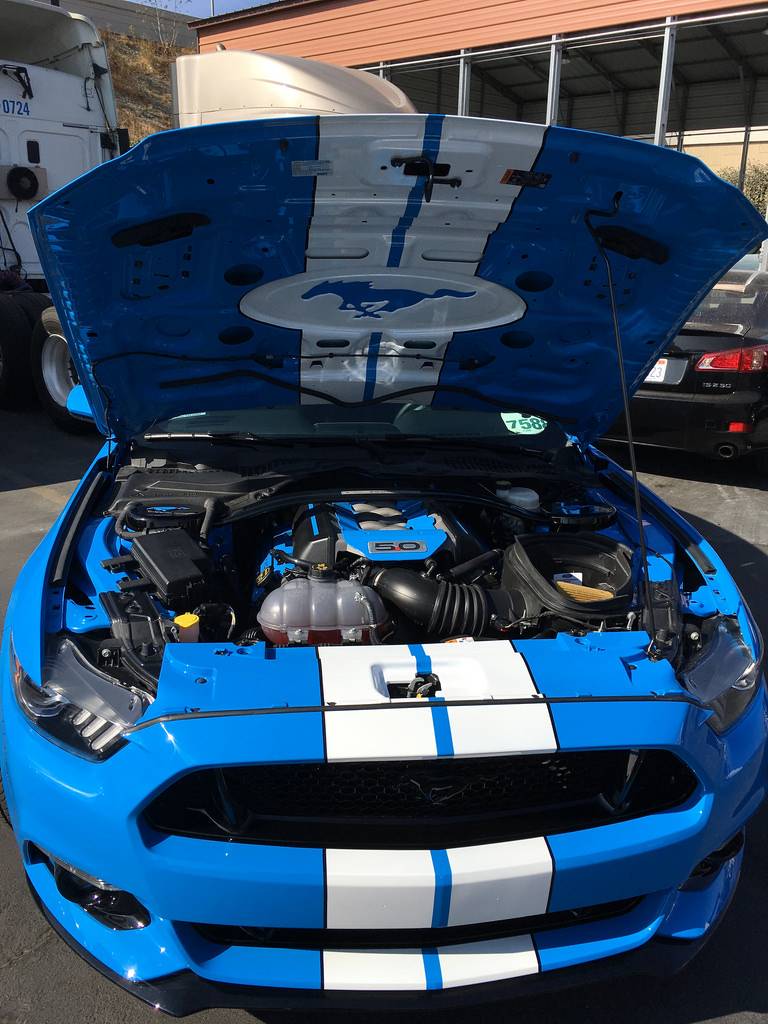

I installed one last summer with help from a couple of extra hands (wife and daughter). What worked for me was to cover the engine with a large blanket, clean the hell out of the hood, then install the pony followed by the ring. Spray the hood, and the graphic you are working with with the solution. Note they are two pieces, only wet one at at time and start working with it (I cut it out to separate the pony from the ring).. Once you place them initially you can move them around by sliding them, just use care (they are reasonably durable). I recommend keeping them very wet, spraying them frequently until you have 'em just right then work with a squeegee from the inside out.... and be prepared to start over when the squeegee moves it :)
At least in my case they did not sag or just fall off after I placed them (I did not remove my hood). Having extra hands, arms, and eyes can be very helpful as it's an awkward position and sometimes you just need to be told it looks good or you'll keep messing around with it :) . And if interested, durability seems great..mine looks like the day I placed it, no peeling or bubbles, etc... but the car is not driven an awful lot so YMMV.
