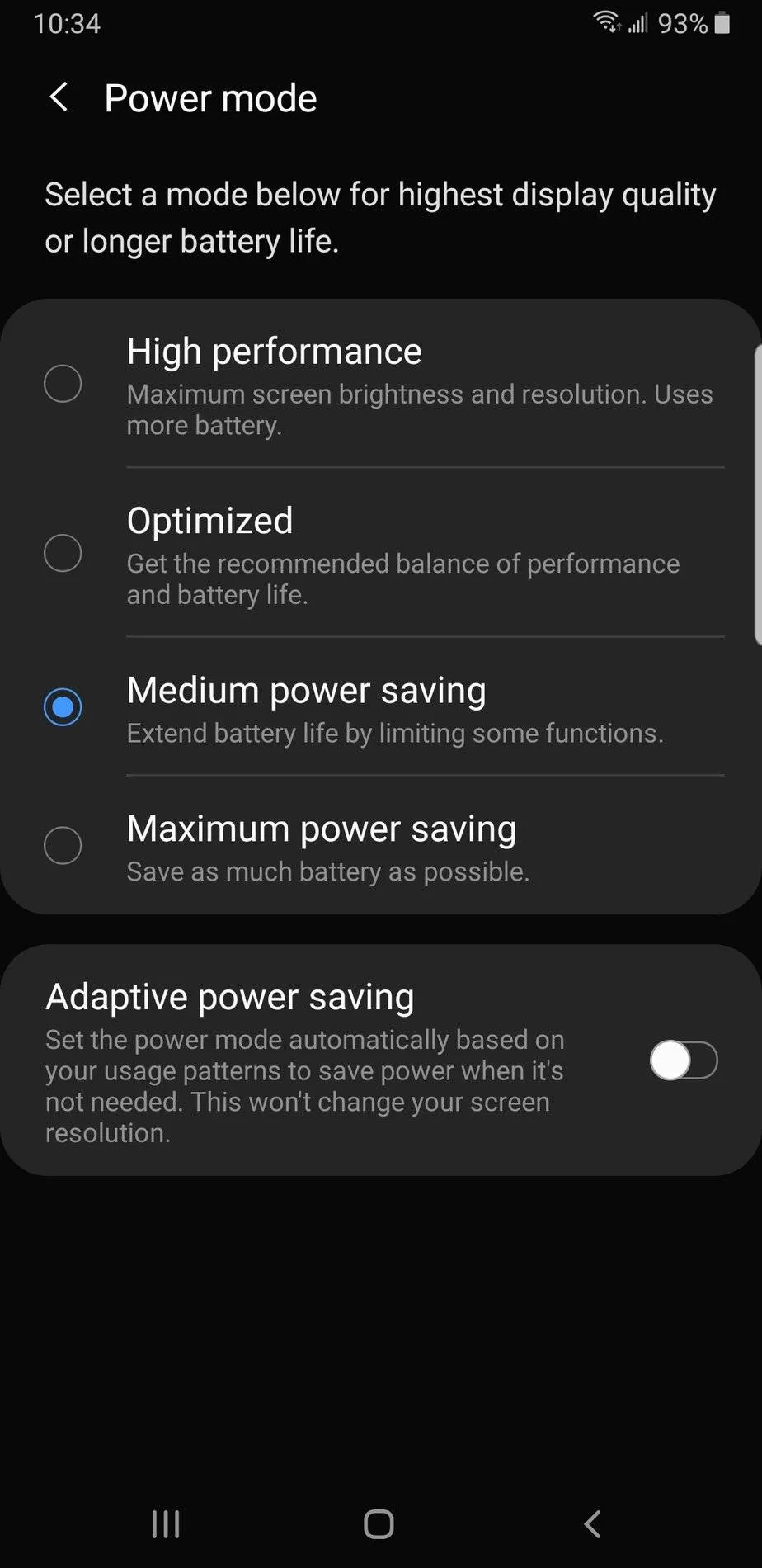

Last fall Waze worked great with Android Auto. Car went into storage for the winter and took out April 1st. Ever since whenever I use Waze it just sits there and won't update the map position. Google Maps works great.
Anyone else using a Note9 with waze on Android auto? What magical combo of settings gets it working?

I am running latest updates on all phone apps and Sync 3.4
Must be something to do with my phone settings. I will play with it some more.

Turn off power saving mode on your phone when using android auto. Try that then thank me later ;)
I have my Power mode set to "Medium". I just read on a Google forum that this can cause problems. Changing my power mode to "Optimized" should allow waze to work with the screen off. I tried all other settings related to allow this that and the other related to battery or background permissions and none of those settings worked. I haven't had a chance to try power mode setting on the road as the weather hasn't been good enough to go driving. EDIT: Setting the Note9 power mode to "OPTIMIZED" did the trick. Waze works again! Thanks!
