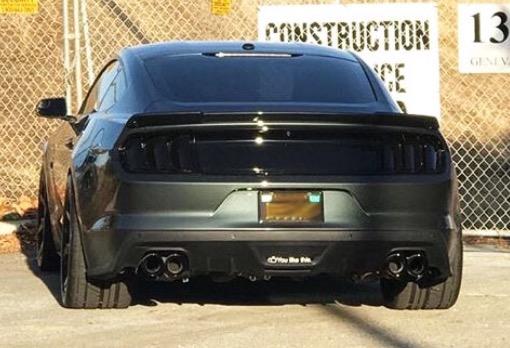

I reckon define flush...
You can use negative camber to make anything work.
Pictured is a 345 rear on 6GR wheel. Deduct 10mm obviously. Poke or not?
LFCRulesOK
Aug 3, 2016
194
56
Brisbane, Australia
2017 Mustang GT (Ruby Red)
That look is acceptable. I just don't want a noticeable protrusion of the tyres from the chassis.
