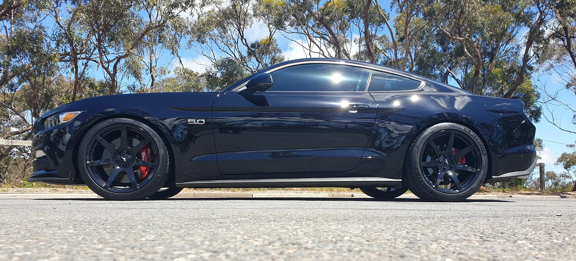

Hi mate my car is 2017 GT lowered and I'm running project 6gr seven spoke wheels 20x10, 35mm offset Front and 20 x11, 50mm offset rear. Rubber is Michelin S4, 275/35 front and 295/35 rear no rubbing. Not a square set up between gives you an idea.
