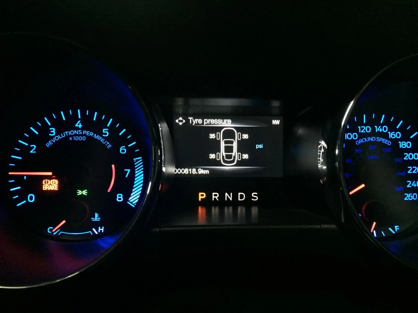

When cold, mine are around 35-36.
On the road with a bit of heat in them they're around 39-42 range.
Thanks for the quick reply, they're the sort of figures I was looking for. 35-36 cold with an increase of approx 4 psi when hot.
