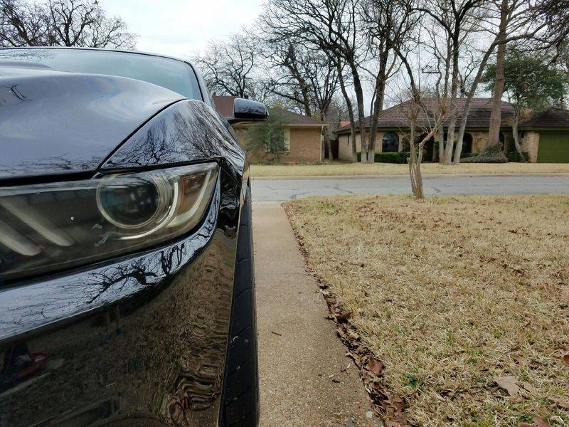

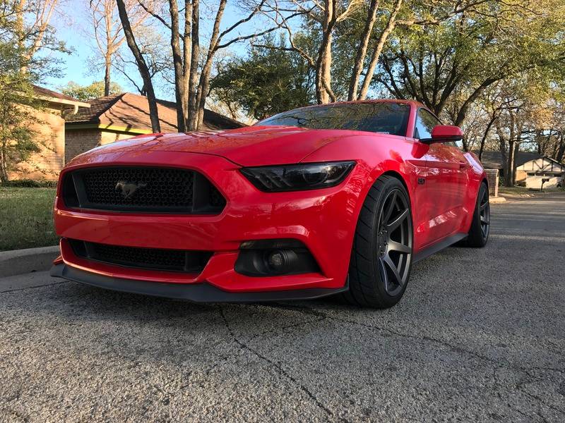

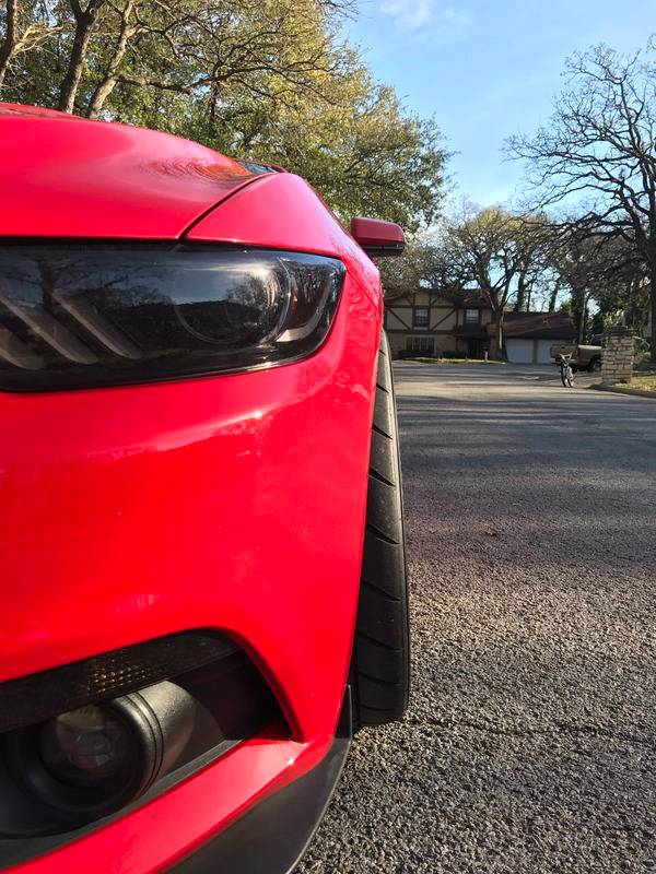

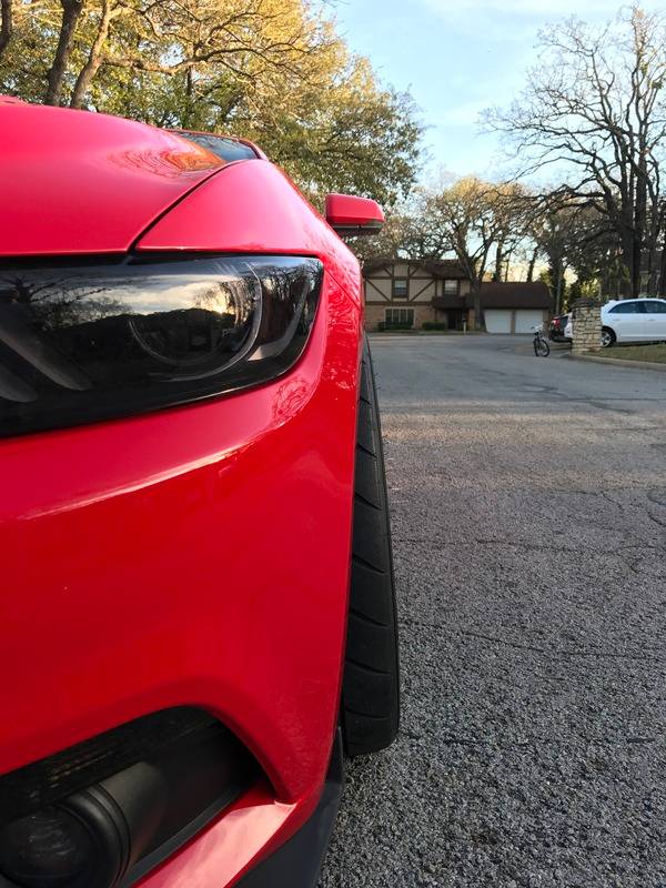

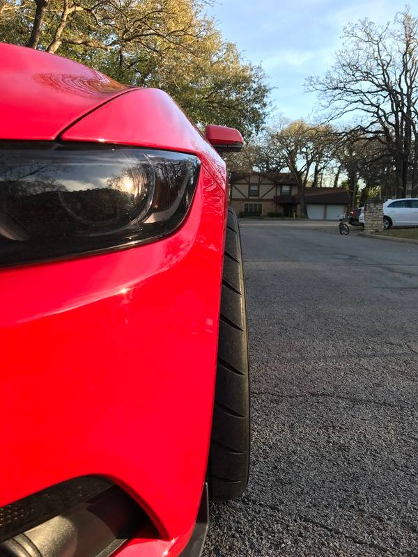

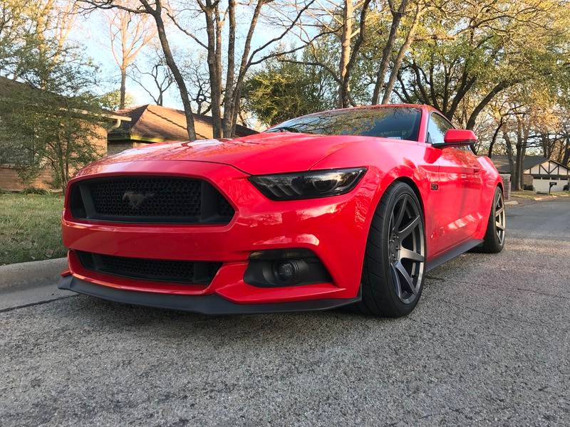

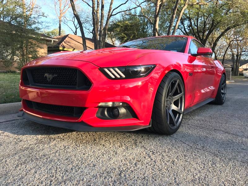

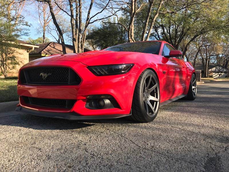

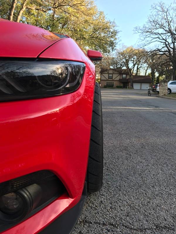

Over the weekend, me and a buddy installed our 19x11's on our GT's w/ PP and wanted to document clearances and such since our suspension setups are different. Between the both of us, we have stock style springs/struts, coilovers, 20mm spacers, 25mm spacers, stock bolts, camber bolts and caster/camber plates. We only have a few clearance measurements so far but would like to mix setups to get more measurements in the future.
Here's what we have so far... more pictures/clearances to come.
2016 Mustang GTPP (Member: Killspray)
Controlled, Does Not Change:
Wheels: 19x11 et50 Project 6GR
Tires: 305/30R19 Hankook Ventus R-S3
Springs: BMR Handling
Struts/Shocks: Koni Yellows
Camber Plates: MM
Rear Spacer: None
Will Vary For Pictures:
Front Spacer: 20mm
Camber: -1°
Clearance to Strut: 4.5mm
Camber Bolts: No
Front Spacer: 20mm
Camber: -2.8°
Camber Bolts: No
Front Spacer: 25mm
Camber: -1°
Clearance to Strut: 9.5mm
Camber Bolts: No
Front Spacer: 25mm
Camber: -2.8°
Camber Bolts: No

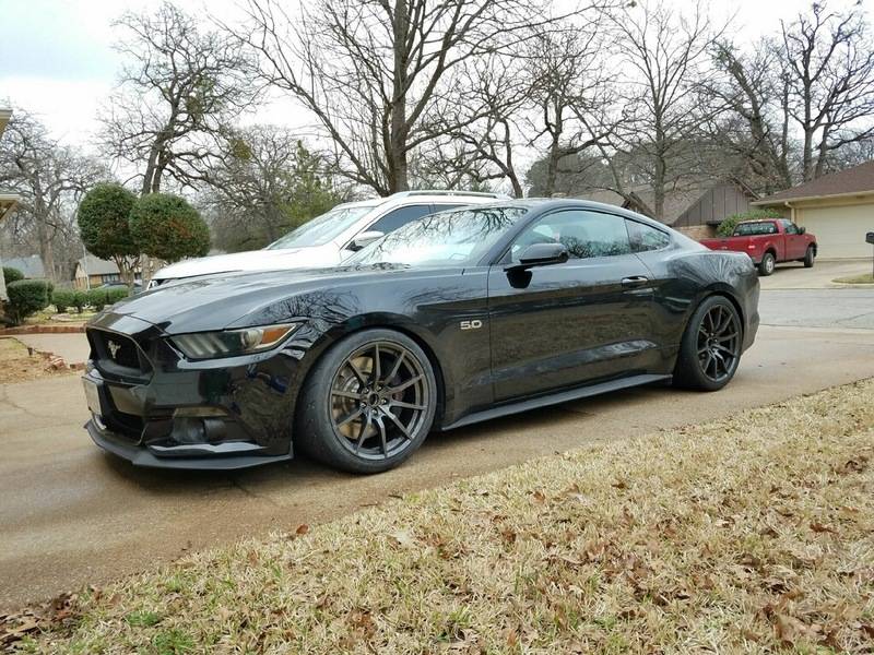

2015 Mustang GTPP (Member: tyshenry)
Wheels: 19x11 et50 SVE GT350 Style
Spacer: 20mm up front, no spacer in rear
Suspension: JRZ RS1 Coilovers
Camber Bolts: no
Camber Plates: Vorshlag
Camber: -2*
